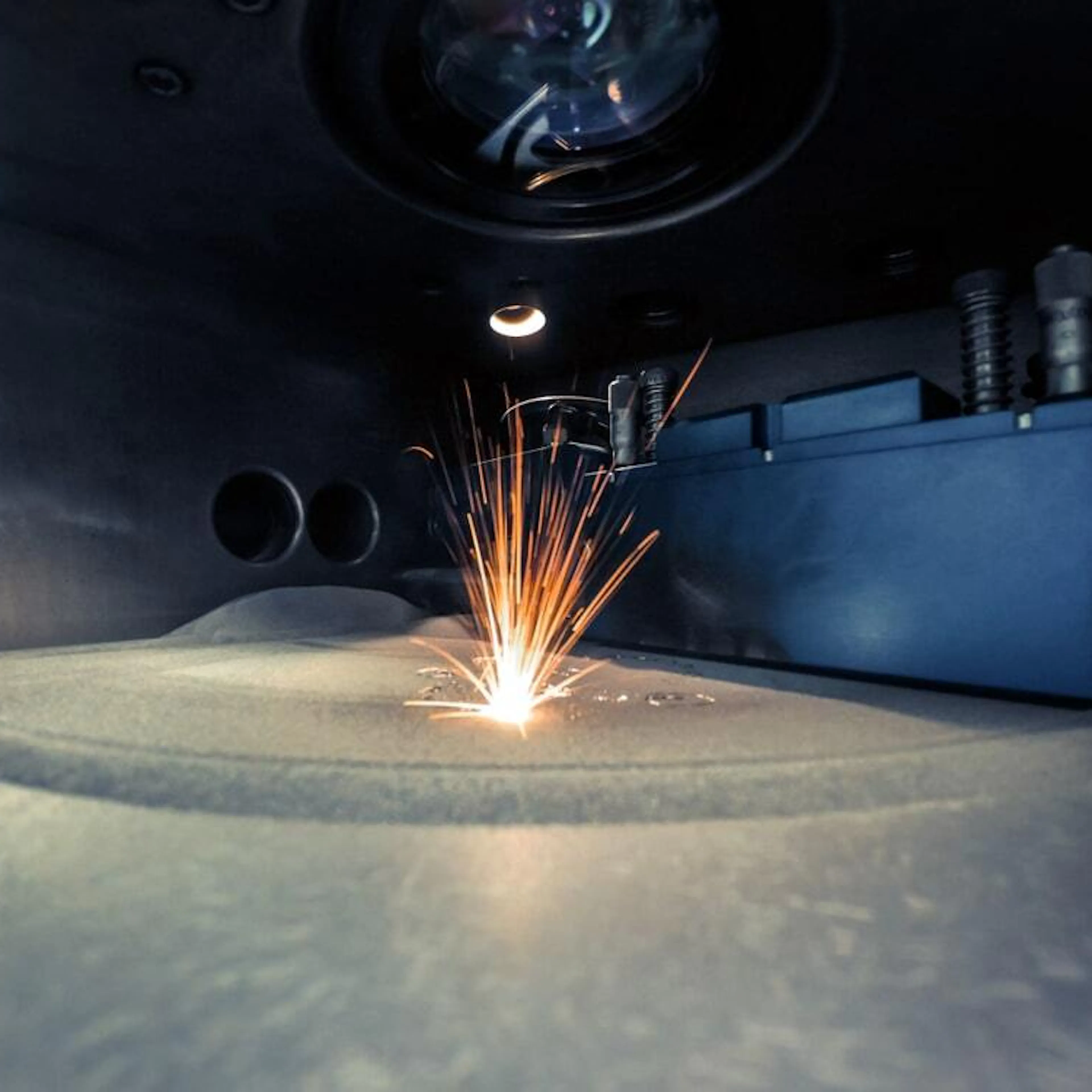

3D printer printing metal. Image Credit: Shutterstock.com/MarinaGrigorivna
SLM (Selective Laser Melting) and EBM (Electron Beam Melting) are powder bed-fusion 3D printing technologies. A high-energy beam is used to fuse metal powder layer by layer to ultimately print a solid component. SLM has better accuracy and resolution than EBM. EBM, on the other hand, can print faster when compared to single-beam SLM machines. However, there exist SLM machines with 12 high-powered lasers, which significantly improve their speed. EBM has a smaller set of possible materials, specifically refractory and resistant materials.
