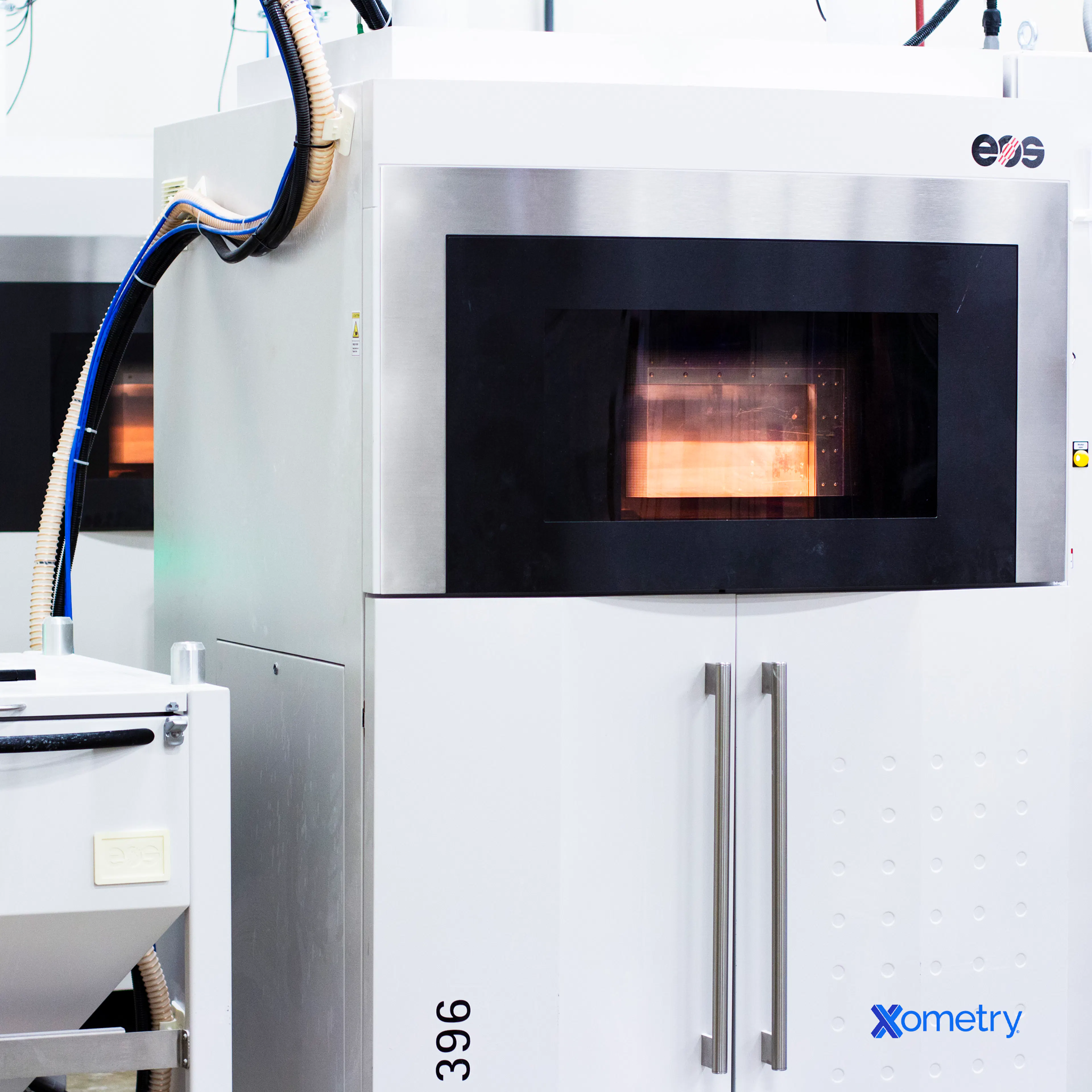

An SLS 3D Printing Machine at Xometry
When manufacturers want to make 3D-printed parts with complex geometries, they often turn to powder bed fusion (PBF) machines. These parts are notoriously hard to make (sometimes impossible) with traditional manufacturing methods. Let’s learn more about it.

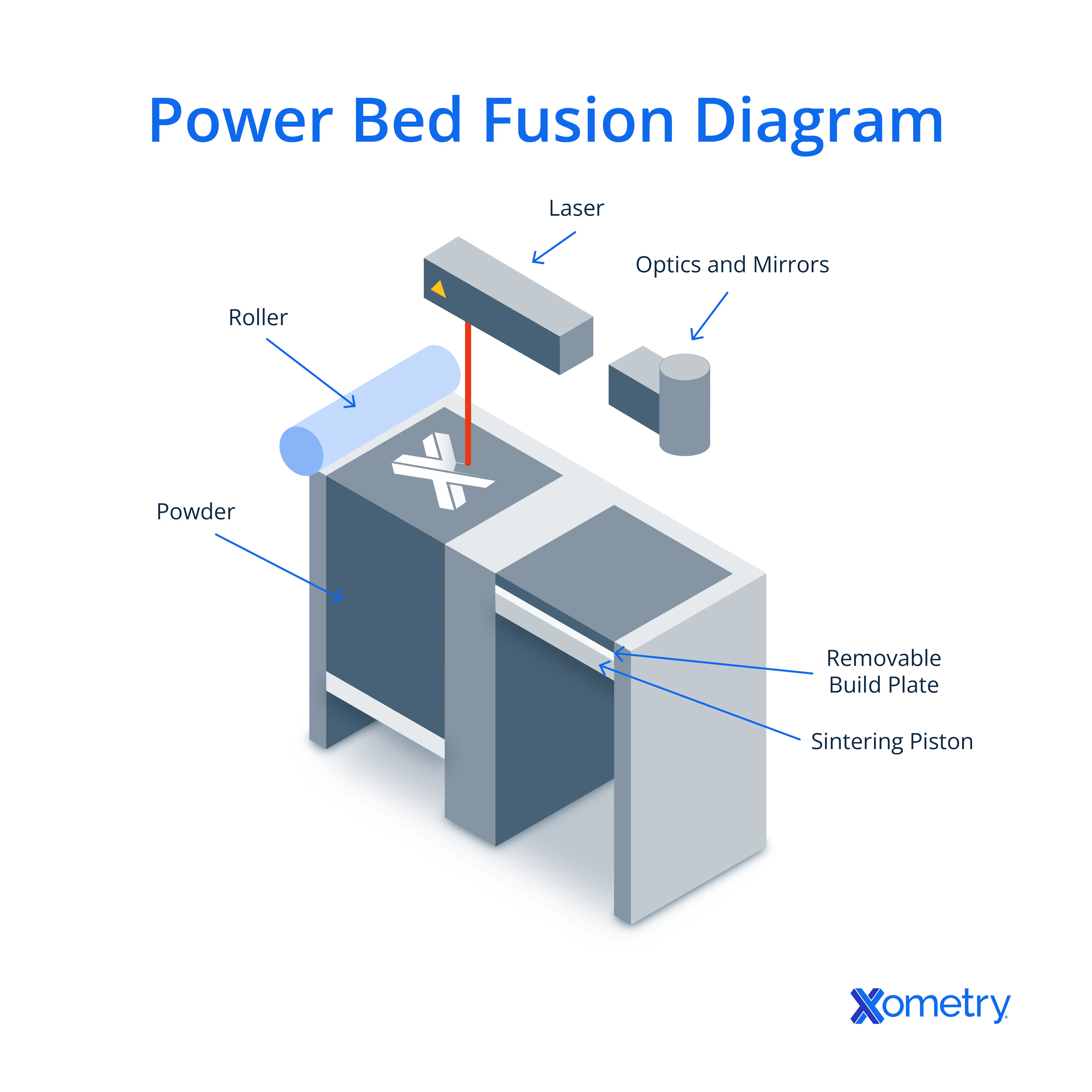

Power Bed Fusion Diagram
How Do Powder Bed Fusion (PBF) Machines Work?
The steps in the PBF 3D printing process are as follows:
  1. A CAD model has to be created and sliced into layers. The 3D printer is programmed with the build sequence before printing begins.
  2. A thin, even layer of powder (typically 0.1 mm) is spread across the build platform.
  3. The powder bed is heated to a temperature slightly below the material’s melting point to reduce thermal stress.
  4. A high-powered laser or electron beam selectively melts the powder layer based on the digital model. The material solidifies as it cools.
  5. The build platform lowers by one layer thickness, and the process repeats until the part is fully formed.
  6. Once printing is complete, the part is removed from the powder bed, and any post-processing steps can begin.
