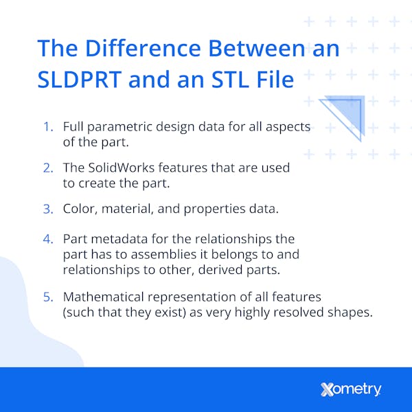

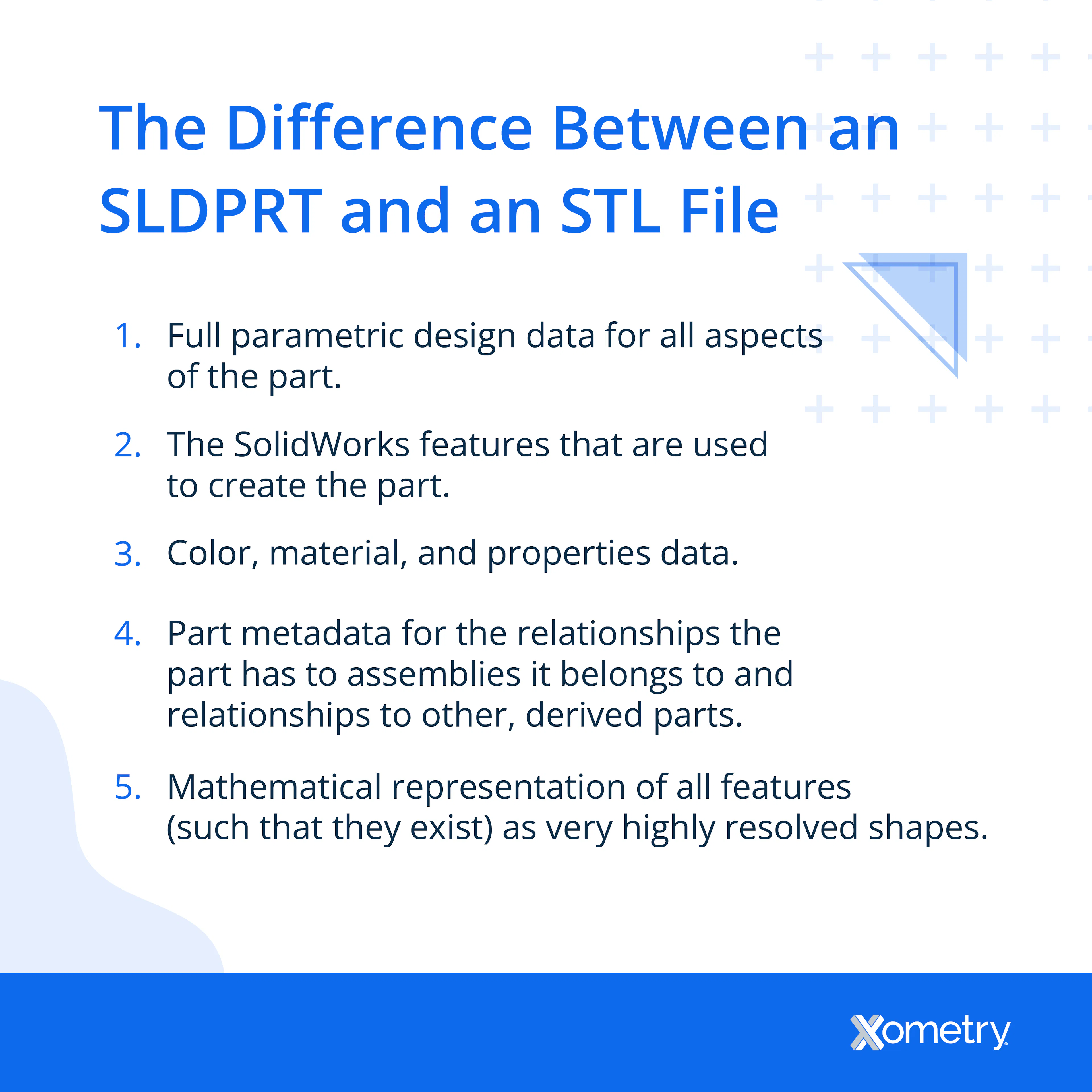

While these two file types are often either confused or talked about in the same conversation, they’re definitely not the same. SLDPRTs are much more complex because they have all the important technical design details of the 3D print-to-be, including shape, size and overall dimensions, materials to be used, colors, and any other features, like holes or curves. This is the file type you work on in the design software when you need to make edits and adjustments. STLs are similar in that they do contain a design’s info, but they just have the very basics—namely, the object’s shape, which is made up of tiny triangles. STLs will tell a printer where to put the material, and that’s about it—which is why this format is only used for printing or sharing purposes.
The differences between an SLDRPT and STL file
