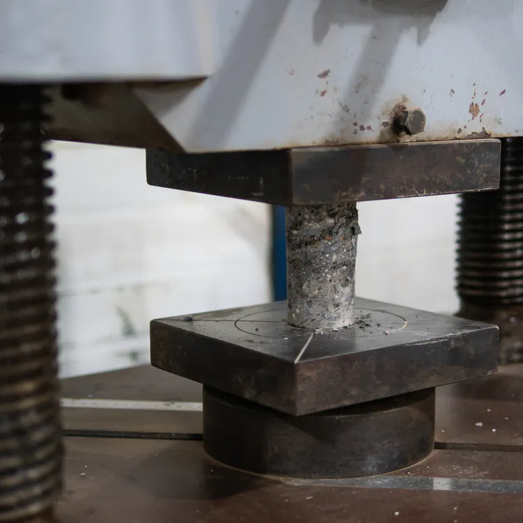

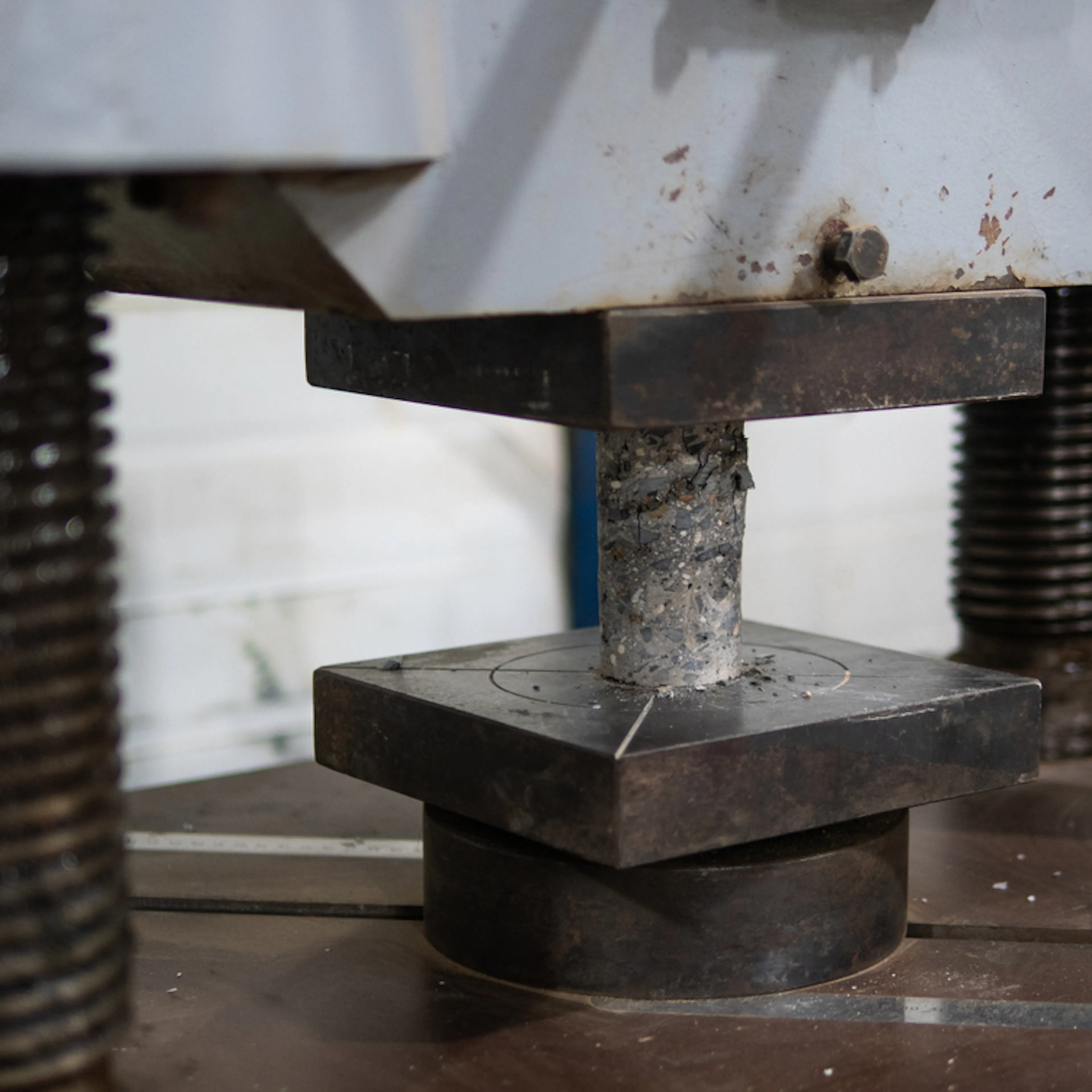

Compressive test bulk modulus. Image Credit: Shutterstock.com/Tohsurat
Bulk modulus is a measure of a material’s resistance to uniform compression. It describes how much a material decreases in volume when pressure is applied equally in all directions. This property is relevant to gases, liquids, and solids, and it helps assess how materials behave under hydrostatic or confined stress. In a typical measurement, the material is compressed in a way that prevents it from expanding outward. As a result, the pressure is distributed evenly throughout the material’s volume, causing a decrease in volume without a change in shape. This is distinct from uniaxial compression, where deformation occurs in a specific direction. Gases are highly compressible, while liquids and solids are often considered incompressible. In reality, they are simply much harder to compress and require significantly more pressure to achieve noticeable volume reduction.

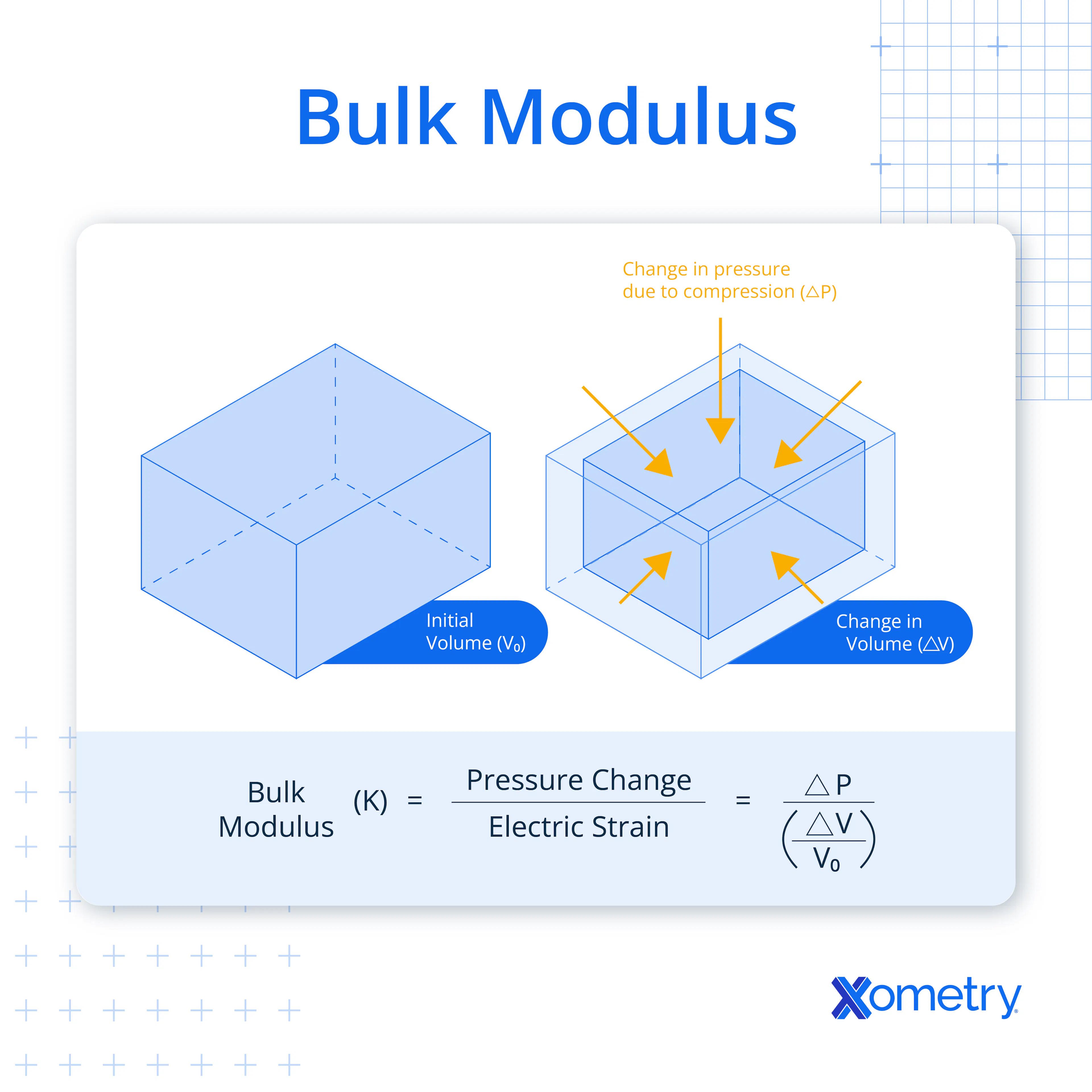

What Is the Formula of Bulk Modulus?
The bulk modulus (K or B) quantifies a material's resistance to uniform compression and is defined as the ratio of applied pressure to the resulting volume strain. It expresses how much pressure is needed to cause a given relative decrease in volume:
K = P / ε (Pascals)
Where:
P = Applied Pressure (Pa)
ε = Volume strain (dimensionless)
K = Bulk modulus (Pa, MPa, or GPa)
Volume strain is dimensionless and represents the fractional reduction in volume under pressure. It is denoted as:
ε = (Vo - Vc) / Vo
Where:
V₀ = Original volume
Vc = Compressed volume
This formula assumes elastic behavior under small volumetric deformations. Alternative methods or corrections may be needed in cases of larger deformation or non-isotropic materials, including using finite strain models or measuring under different boundary conditions.
An illustration showing bulk modulus and its formula
