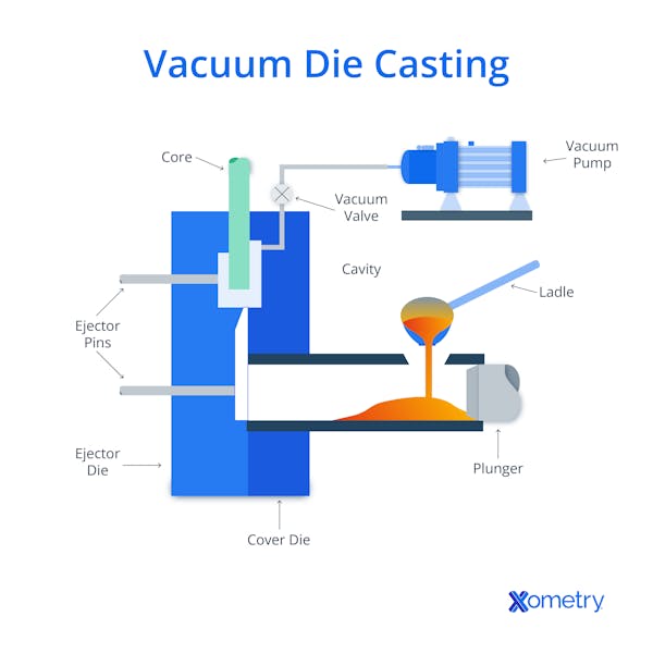

7. Vacuum Die Casting
Vacuum die casting differs from pressure or gravity die casting in that it uses a reservoir below the casting tool. It pulls the molten material up by a vacuum applied to the tool. This results in lower porosity and higher-quality parts, slowly displacing older die-casting methods.
Diagram of vacuum die casting

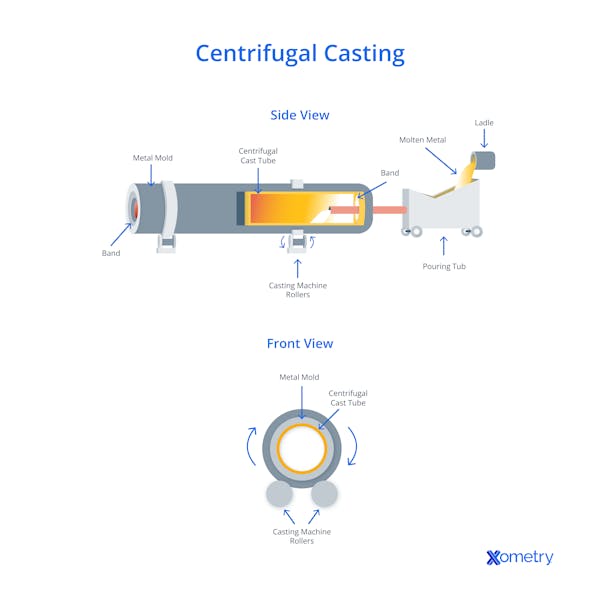

10. Centrifugal Casting
This process uses a fast-spinning steel cavity tool to cast aluminum. Larger parts with rotational symmetry lend themselves to this process. The tool is spun once filled, and centripetal force fills the extremities very cleanly, with no inclusions of porosity. Centrifugally cast aluminum is fine-grained and defect-free, with improved hardness and strength, compared with other processes. It's used for asymmetrical parts that require the best possible properties and are not cost-sensitive.
A diagram of centrifugal casting
