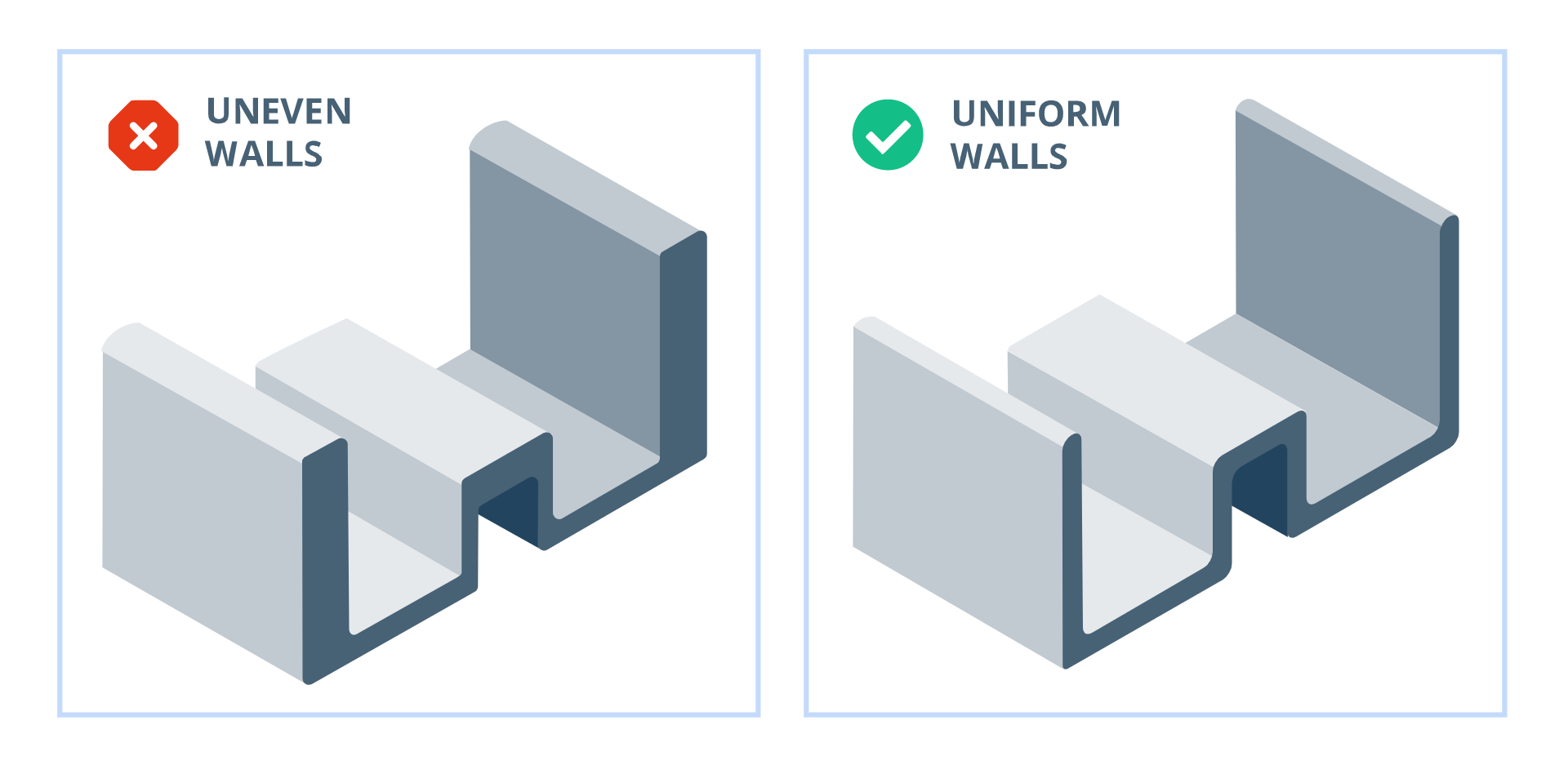

Keep Wall Thickness Consistent
Inconsistent wall thickness could lead to uneven cooling, so keeping these consistent and quite sizable will avoid warping and twisting. A good rule of thumb is not having walls thinner than 0.025 inches.

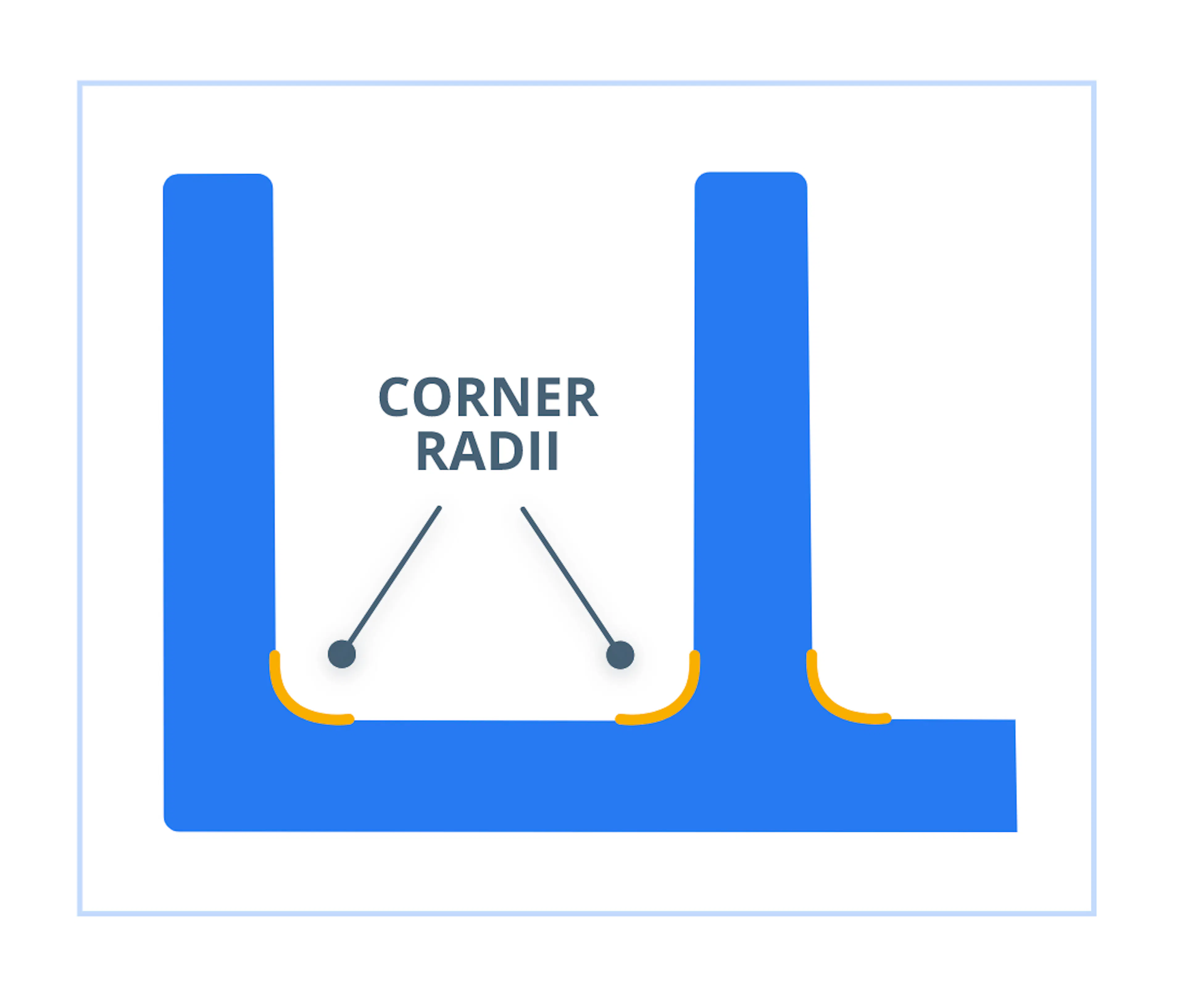

Add Corner Radii
To avoid pooling material and warping, don’t make your corners too sharp. A radius of at least 0.016 inches for each corner should do the trick.

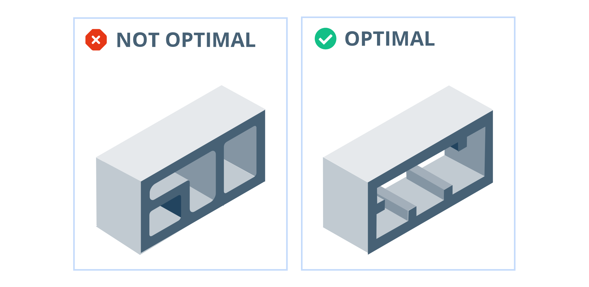

Avoid Designing Hollows
Hollows are called lumen in plastic extruding terms, and while it’s possible to create these features, they can cause problems because of the more simplistic design of the extrusion machine. There aren’t ways of affecting air pressure or creating a vacuum, so these areas can collapse or deform. If you have to include lumen, don’t design cavities within cavities and keep protrusions to a minimum.
