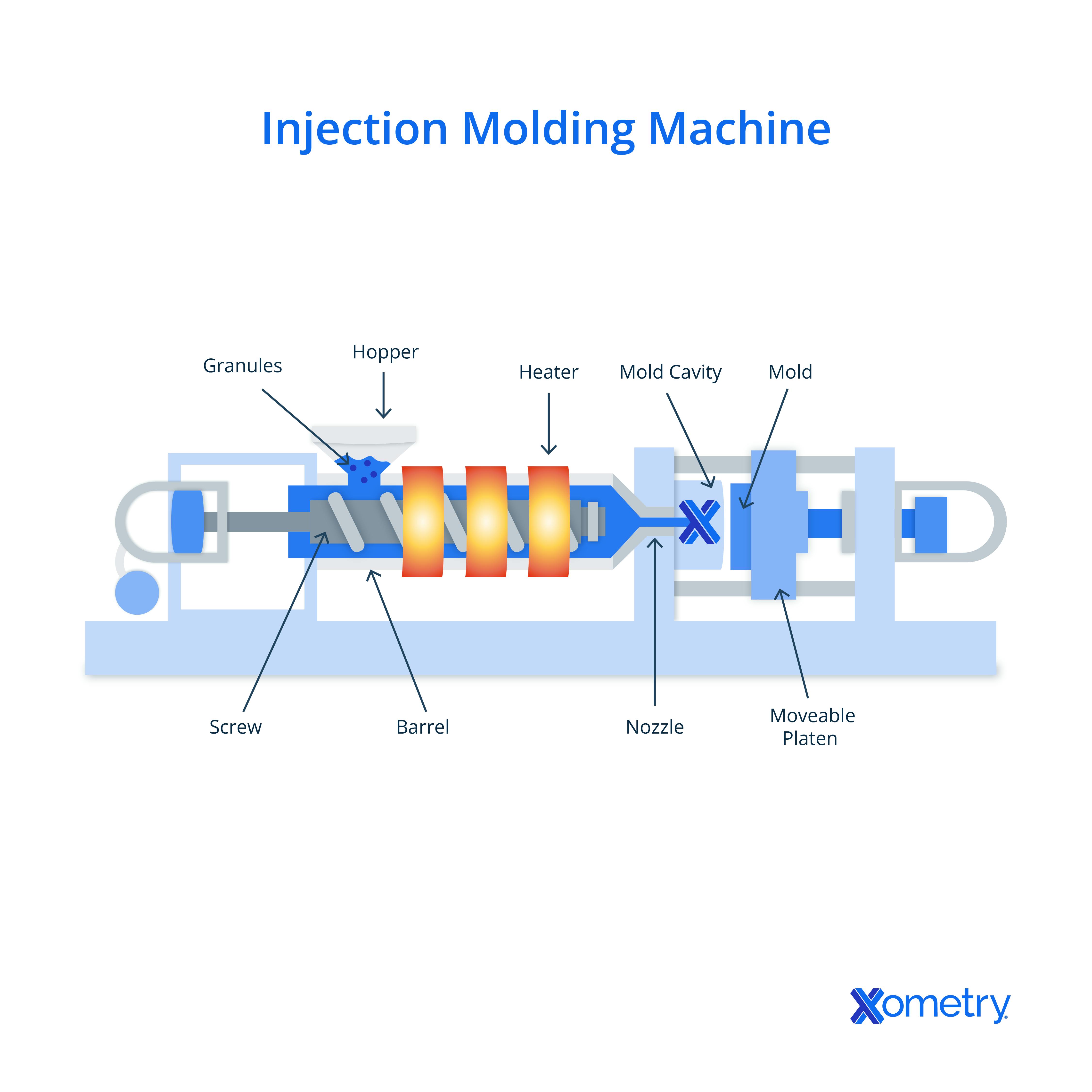

The 10 main parts of an injection molding machine are the hopper, barrel, reciprocating screw, heaters, nozzle, ejector pins, mold (core and cavity), clamping unit, injection unit, and hydraulic unit, which all work together to produce molded plastic parts. An injection molding machine is a device used to produce plastic products by injecting molten plastic into a mold. The machine is essential in automotive, medical, and consumer goods for producing high-quality injection molded parts. Each part of the injection molding machine plays a unique role in the process, ensuring the efficient production of parts. Understanding the 10 parts of an injection molding machine is important for the effective operation and maintenance of the machine. The parts work in unison to create high-quality injection molded parts that are used in countless products across industries. The efficiency and precision of each component are vital for successful injection molding machine operations.
The 10 parts of an injection molding machine are listed below.
  • Hopper: The hopper is a container that stores plastic pellets or granules and feeds them into the barrel. It serves as the starting point for the material in the injection molding process.
  • Barrel: The barrel is the main chamber where the plastic pellets are melted. The plastic is subjected to heat and pressure inside the barrel to reach a molten state suitable for injection into the mold.
  • Screw Motion or Reciprocating Screw: The reciprocating screw plays a crucial role in moving the molten plastic from the barrel to the mold cavity. It ensures consistent material flow and pressure to guarantee proper filling of the mold.
  • Heaters: Heaters are strategically placed along the length of the barrel to maintain a specific temperature that ensures the plastic melts uniformly and reaches the proper consistency for injection.
  • Nozzle: The nozzle is a small opening at the end of the barrel where the molten plastic is forced through under high pressure and injected into the mold cavity.
  • Ejector Pins: Ejector pins are used to eject the molded part from the mold once it has cooled and solidified. They help ensure smooth and safe part removal from the mold.
  • Split Molds: The mold consists of two halves (known as the "core" and "cavity") that come together to form the shape of the molded part. The mold is precisely designed to match the final product's specifications and quality.
  • Clamping Unit: The clamping unit securely holds the mold halves together during the injection process, applying the necessary force to ensure that the mold stays closed under the pressure of the injected material.
  • Injection Unit: The injection unit is responsible for injecting the molten plastic into the mold cavity under high pressure. It includes the screw and barrel system that melts and delivers the plastic to the mold.
  • Hydraulic Unit: The hydraulic unit powers the machine’s movements, providing the necessary force for the clamping unit to operate and for the injection unit to perform the injection process. It controls the speed, pressure, and force required for various parts of the molding cycle.

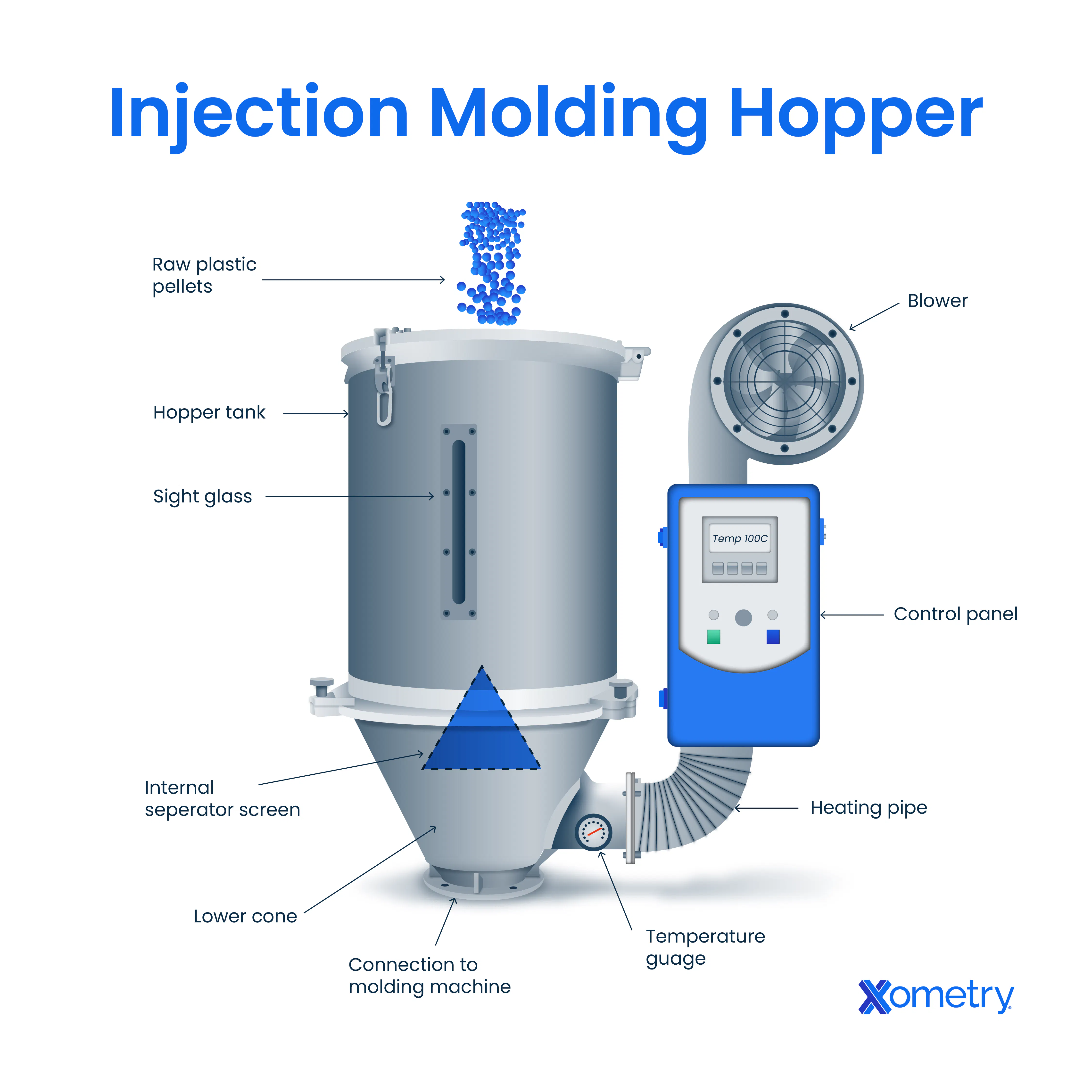

1. Hopper
The hopper serves as the storage unit for raw plastic material in the form of pellets or granules. Hopper feeds the plastic material into the barrel, where it is melted and processed into the final product. The hopper plays a vital role in maintaining the steady flow of material into the machine, ensuring that there is no interruption in the injection molding process. The machine lacks a reliable source of plastic to create the desired injection molded parts without the hopper.
The essence of the hopper lies in its ability to regulate the material input, ensuring that the right amount of plastic is available for each cycle. A properly functioning hopper prevents issues (clogging, inconsistent material flow, or contamination) that affect the quality of the injection parts. The hopper's design and efficiency directly impact the performance and reliability of the machine, contributing to the consistent production of high-quality injection parts.

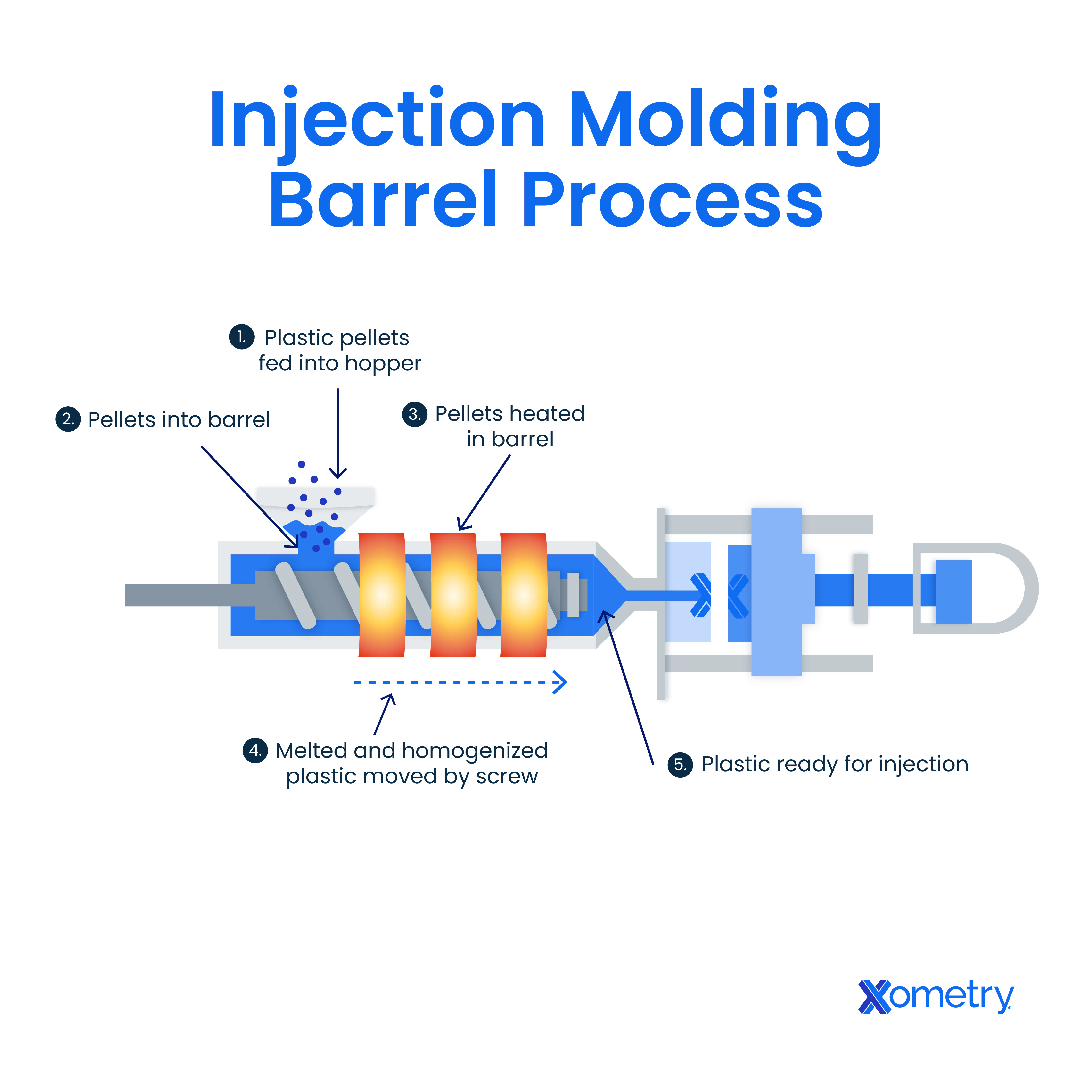

2. Barrel
The barrel is a critical component of the injection molding machine, serving as the chamber where plastic material is heated and melted before being injected into the mold. Raw plastic pellets or granules are fed from the hopper into the barrel, where they are subjected to high heat and pressure. The barrel is equipped with heating elements that ensure the plastic reaches the required melt temperature and consistency. A rotating screw moves the molten material through the barrel towards the nozzle.
The barrel's primary function is to ensure the uniform melting and homogenization of the plastic, which is crucial for achieving consistent flow during injection. Any malfunction in the barrel (inadequate heating or improper material flow) results in incomplete melting, degradation of the material, or uneven infusion, all of which negatively impact the quality and precision of the molded parts. The barrel plays an essential role in producing parts that meet stringent design specifications by maintaining precise control over the temperature and pressure. Its efficiency directly influences the performance and output quality of the injection molding process, ensuring high-quality production runs.
