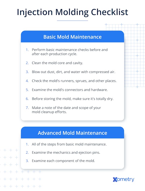

Injection Molding Checklist
What Are the Basic Mold Maintenance Tips?
Basic mold maintenance tips are designed to ensure the efficient production of injection-molded parts. These tips include preventive maintenance techniques that allow for identifying and correcting injection molding problems before they pose a risk to production. Below are some common basic injection mold maintenance checklist items that can be used to extend mold life, minimize injection molding repairs, and maintain consistent part quality.
1. Perform Basic Maintenance Checks Before and After Each Production Cycle
Before starting a new production cycle, it is important to thoroughly inspect the injection molds.  Examine the surfaces of the injection molding die to ensure they are free of plastic or contaminants. Any foreign debris may cause interference when the tool clamps down and cause the plastic to seep into the parting area during mold injection. You should also look for anomalous marks or damage on the mold’s surfaces.
It is also recommended to inspect the final part from the previous cycle. This will be a good indicator of the mold’s performance. For example, excessive flash on the parting line may mean the injection mold cavity and core are not clamping down correctly.
Make sure the shot counter is working correctly. This device tracks the total cycles and provides a reference point for scheduling maintenance, though actual intervals depend on the resin, mold design, and production conditions.
2. Clean the Mold Core and Cavity
Clean your mold after each production cycle to prevent the build-up of foreign materials. Cleaning can be done with the injection mold tool in the press or on the bench. Press mold cleaning is done after each production run, while on-bench cleaning takes place during major maintenance activities and is performed less often. Some resins will foul the molds quicker than others, so your cleaning cycle will depend heavily on the resin used. Wipe down the mold with a standard degreaser or mild solvent using lint-free wipes or non-shedding cloths to avoid fiber contamination. Other techniques, like dry ice blasting, can help you clean the mold in place without leaving any residue.
If the plastic molding tool has been removed from the machine for more extensive maintenance, it should be disassembled, and each part cleaned individually. One of the more efficient methods is to clean the parts in an ultrasonic bath. This allows you to clean every surface—even cooling channels and mold vents—that are hard to reach. The mold material must be carefully considered as some materials are not conducive to ultrasonic cleaning. In this case, traditional cleaning techniques must be employed.
3. Blow Out Dust, Dirt, and Water With Compressed Air
It is important to remove any dirt or dust that has settled on the mold surface during cleaning. The water used to clean the mold can also leave stubborn scale marks when it dries, especially on highly polished molds. The molds should be dried as soon as possible after cleaning. An injection molding technician can use compressed air to accomplish this. Cooling channels must also be blown dry, as water can easily get trapped in these channels.
Anti-rust coatings will make debris like dust or cotton fibers stick to the injection mold die surface. These particles may later end up on the injection-molded parts, so care should be taken to inspect the mold surfaces carefully afterward.
4. Check the Mold's Runners, Sprues, and Other Places
It's important to inspect the quality of the mold runners, sprues, gates, and vents. All these features are critical to efficient production. Wear and material build-up are two of the most common failure modes and can cause parts to stick to the injection molding tools. Molds are most likely to wear at the plastic’s entry gate, so this area should be thoroughly inspected. Make sure there is no plastic buildup or surface blemishes on the runner or sprue, as these may impede the flow of plastic and cause sticking. Scratches from previous attempts to remove stuck plastic can exacerbate the problem, causing future plastic to stick more easily. Sprues and runners must be cleaned and re-polished if flaws are found. Check that the hot runner nozzle tips are free of burrs.
5. Examine the Mold's Connectors and Hardware
Check all cooling water hoses, pipe connectors, and threads to ensure there are no leaks. Remove pipes and fittings and clean off any potential build-up of calcium or other deposits. If the mold is not removed, ensure that all the bolts connecting the mold to the platen plates are properly torqued. If the mold is removed, inspect the platen plates for warping and rusting. Dents and burrs on the platen can damage the mold and reduce its effective lifespan. Any small burrs or other defects must be removed with a polishing stone or similar tool. Due to the softer metal of the platen, the mold fastening hole threads can get damaged over time, so these should be periodically checked. A torque wrench is recommended to prevent over-tensioning damage to the threads. Check the platen for any deformation.
6. Before Storing the Mold, Make Sure It's Totally Dry
If the mold is to be stored for an extended period, it must be fully dried and protected beforehand. Moisture can cause corrosion even if the mold is sealed. Compressed air can assist with drying, but thorough methods such as heating or desiccant drying are often needed to remove moisture trapped in cooling channels and internal surfaces. Afterward, apply a rust inhibitor to protect the mold from atmospheric moisture.
7. Make a Note of the Date and Scope of Your Mold Cleanup Efforts
All maintenance activities should follow a maintenance plan, and each step should be properly logged. An injection mold maintenance checklist is the perfect place for this logging. Any faults or anomalies must also be listed, as these can help identify the root causes of future failures.
I’ve been involved in projects where injection-molded optical parts were used in public health applications, and even the smallest deviation in mold quality could compromise performance. Experiences like this show how critical consistent mold maintenance is for ensuring both precision and reliability.
Audrius Zidonis, Principal Engineer at Zidonis Engineering
Note from the Editor
What Are the Advanced Mold Maintenance Tips?
Listed below are some more advanced mold maintenance tips that can further expand the useful life of an injection mold.
1. Examine the Mechanics and Ejection Pins
Ejector pins that get bent may not eject parts properly. This condition can cause the part to get stuck in the tool or may damage the part after mold injection. Major maintenance involves measuring the alignment features and checking them against the mold's original tolerances. Any major deviations may require weld repair, plating, or inserting new components, followed by re-machining to bring the mold back within tolerance. On complex multi-part molds, the action of the various mechanisms must be checked, and moving parts must be lubricated and checked for smooth operation.
2. Examine Each Component of the Mold
If you find defects in your parts, it’s tempting to remove the mold tool right away. However, it is best to leave it attached until you’ve completed your injection mold troubleshooting. Problems usually stem from a combination of factors, so you want to track them all down. Once the mold has been removed from the machine, it can be disassembled, and each part thoroughly inspected for wear or other damage. All o-rings or sealing elements should be replaced. Cooling channels should be checked for scale build-up, rust, or other corrosion caused by untreated or chemically imbalanced cooling water.
