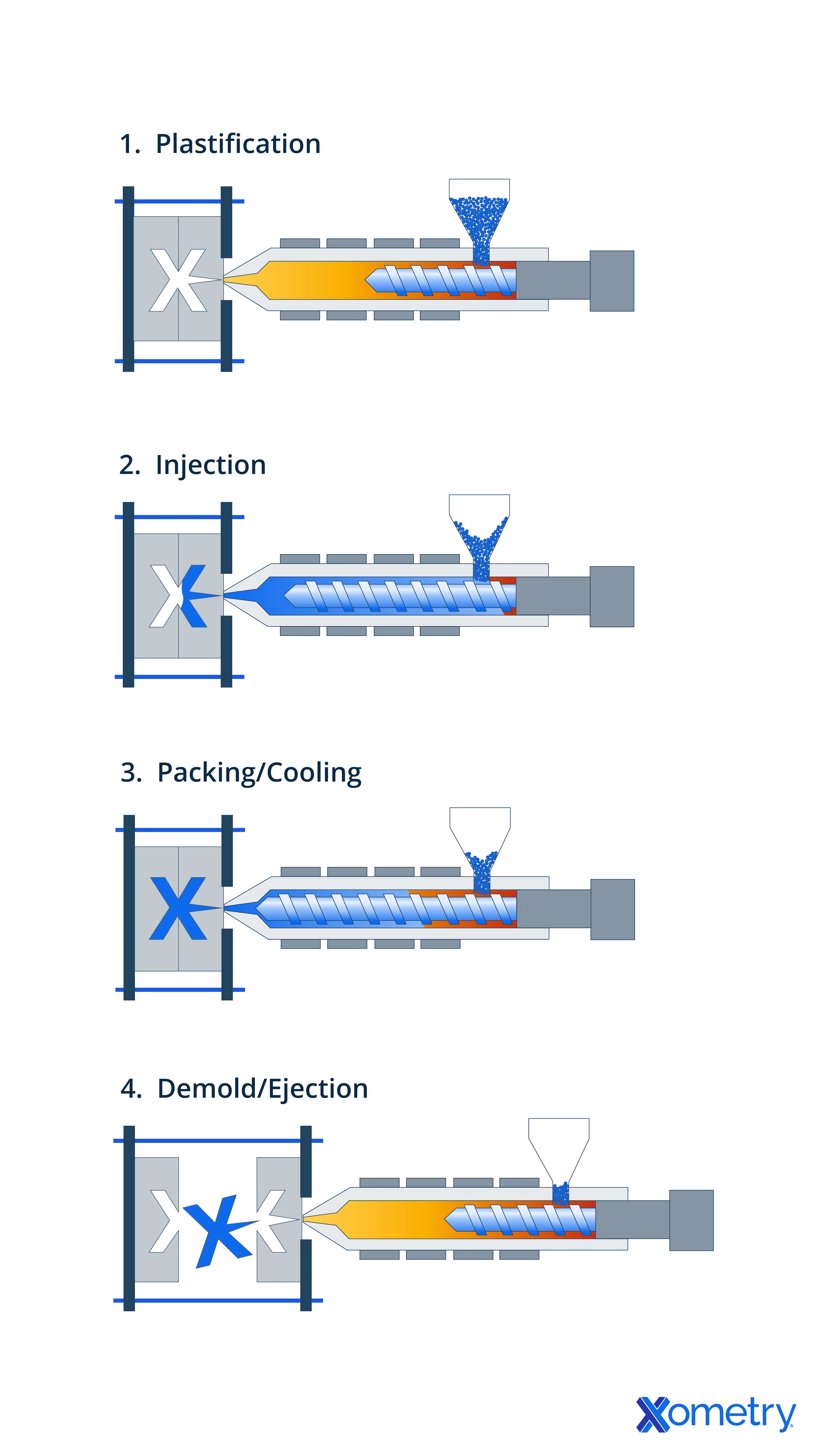

Before discussing where to place cores and cavities, it is necessary to explain how injection molding works and how it impacts design considerations in the first place. The basic injection molding cycle steps are as follows:
  • Plastification: This is where the plastic pellets are melted with high heat and move through a reciprocating screw in the machine’s hopper. The screw will then push the material through the heater bands and melt it.
  • Injection: The screw continues to push the melted plastic further into the mold, which is made up of the two clamped halves (core and cavity).
  • Packing/cooling: The mold is kept at a set temperature under a holding pressure until it has cooled down and solidified.
  • Demold/ejection: This is where the two halves of the mold open and ejector pins are used to push the final product out from one side.

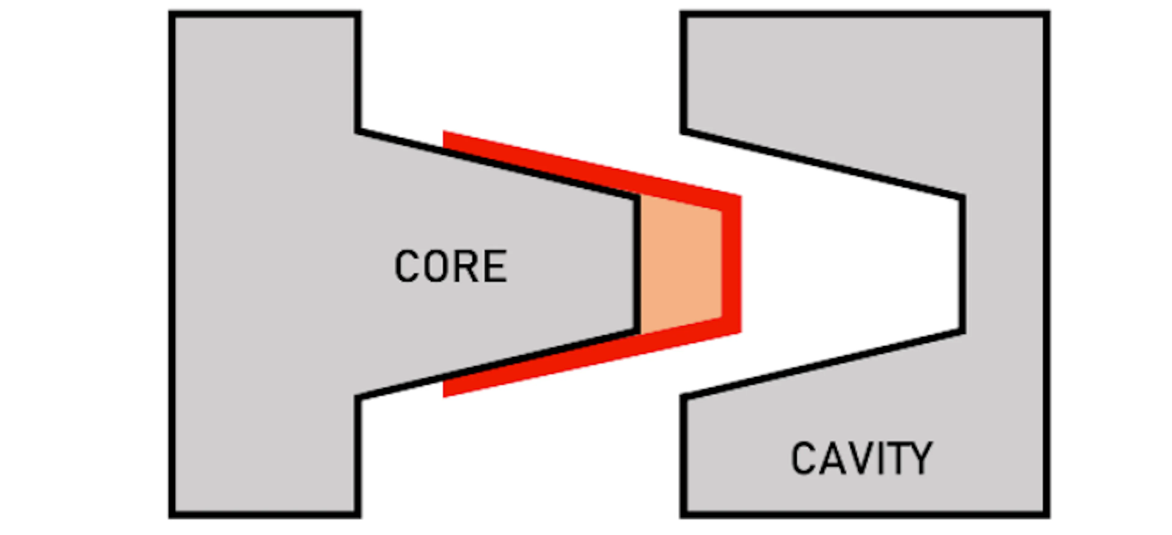

As briefly covered in the intro, the core of a mold is the inside part that you can’t see, and the cavity is the exterior surface that will be visible and treated or polished as necessary. When they are put together in injection molding, melted plastic will fill the thin space between them and harden into the final part. But why is the placement of these mold parts so important? Well, an adequately-designed mold will ensure the plastic flows and cools well, and that the part can be easily removed when it’s hard. There are four steps in the process, which are shown in the diagram below.

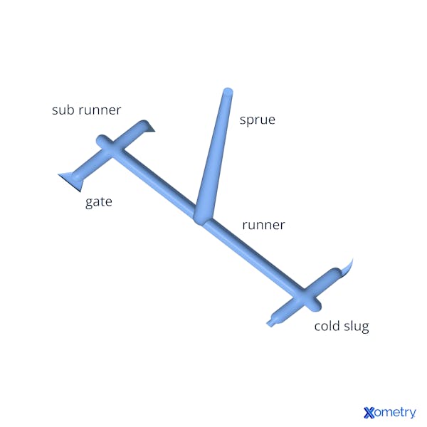

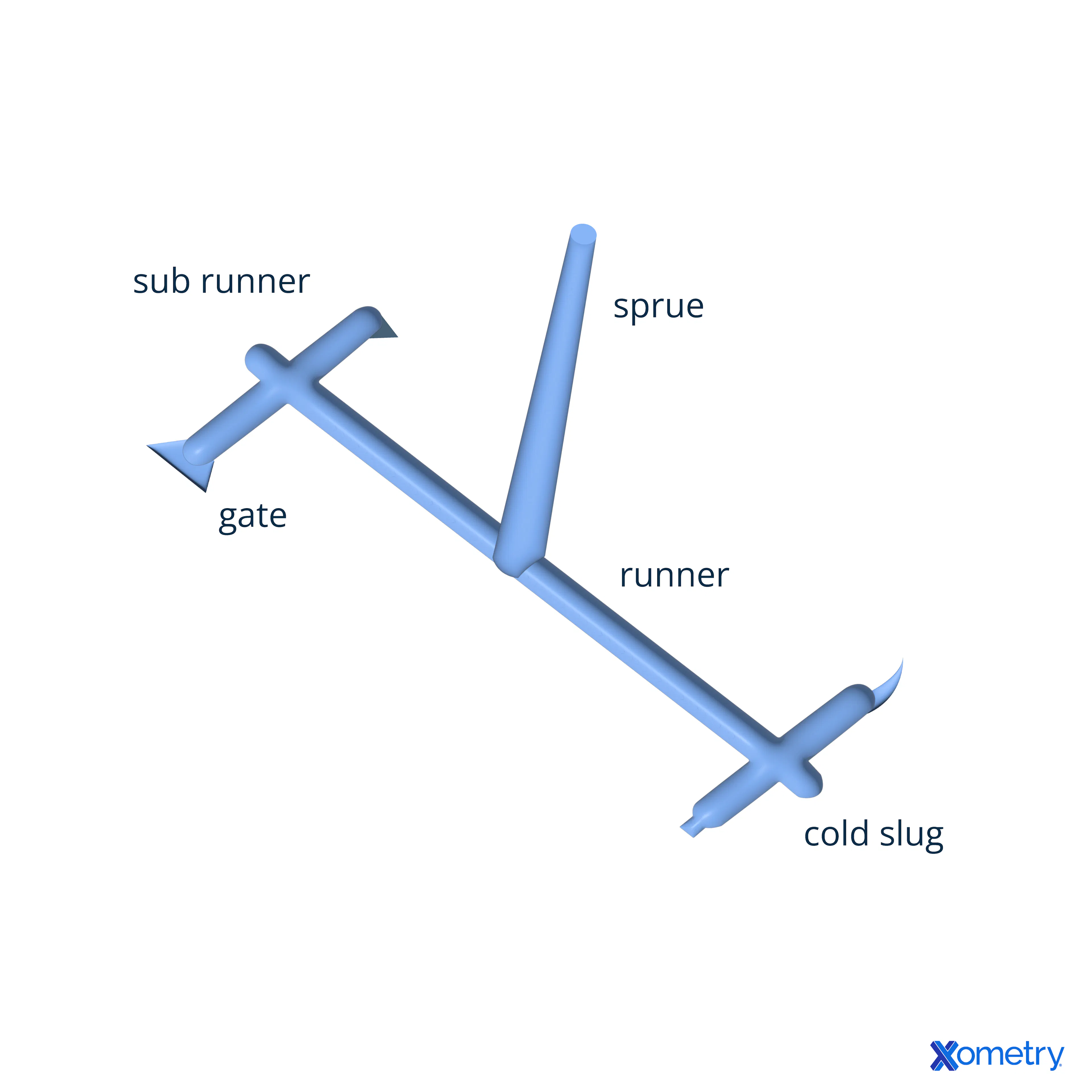

Gates, Runners, and Sprues: The sprue is the main channel from the injection molding nozzle that feeds plastic into the mold cavity. It is typically perpendicular to the mold cavity’s axis but can sometimes be directly piped into the cavity (in that instance, the sprue is known as a direct sprue gate). Runners are the channels that feed multiple mold cavities with molten plastic from the sprue. Most injection molds use runners as iit is more economical to mold multiple parts in one cycle (especially small parts like model kit parts, for example). Gates are the entry points from the runner into the core and cavity and are typically much narrower than the runner.
Each of these components affect core and cavity placement and must be smartly designed. The sprue and runner locations must be placed in such a way that allows for sufficient filling of all features of a part. Proper gate location affects core and cavity placement, as they influence how the core and cavity fills and how the part will look aesthetically, as it is the point the part is cut off from the runner system (assuming a cold runner design).

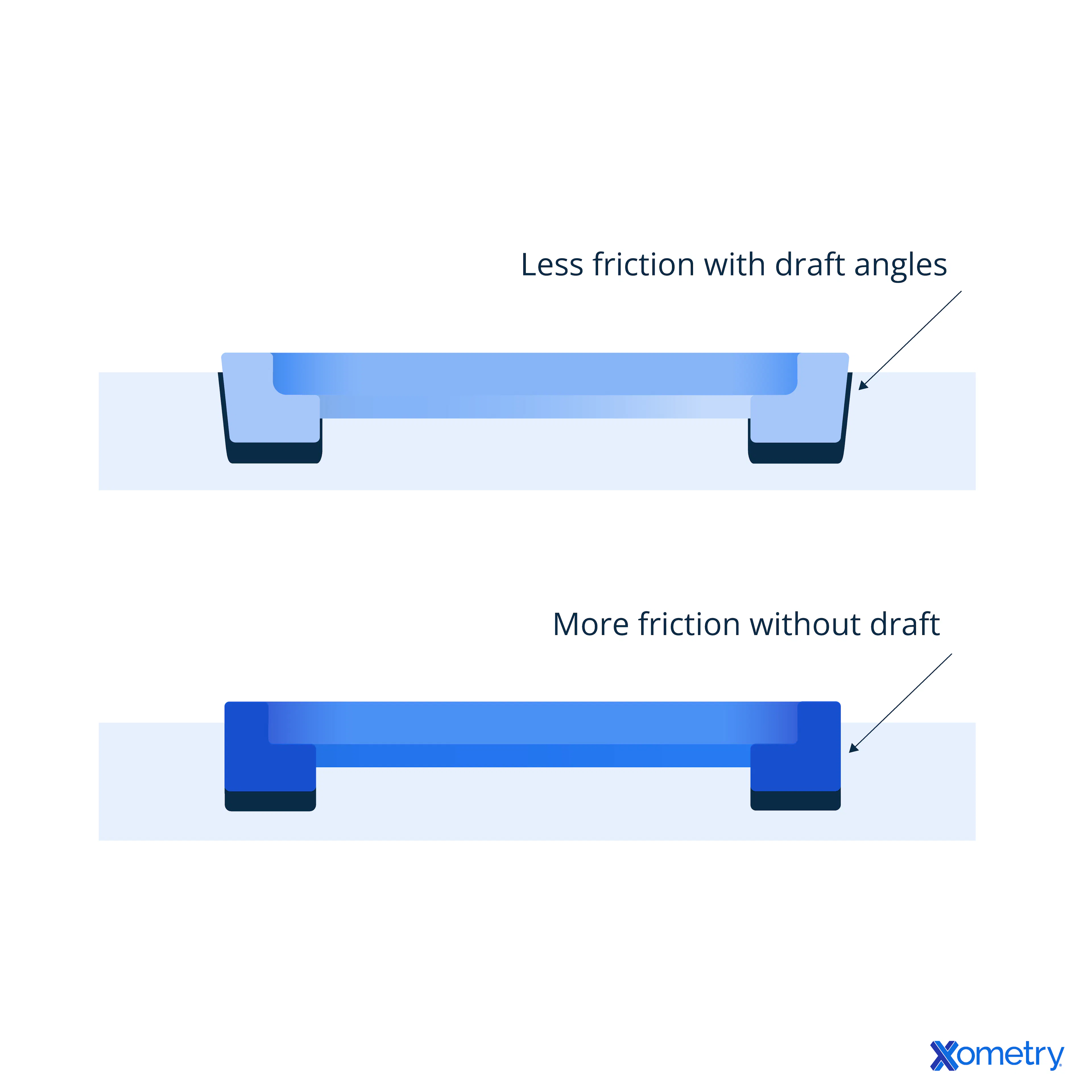

One especially important aspect of core and cavity design is the draft angle, which is the angle of the walls to the mold’s vertical axis. Its purpose is to take shrinkage into account and allow for easy ejection, as well as prevent any damage during removal. Here’s what it looks like:
draft angle
Checking surfaces for draft angle.
When plastic is perfectly vertical in a mold design—especially inside a cavity or around a core—it will experience friction and suction as you try to remove it from the mold. But you can reduce the friction and release the vacuum by providing space and designing proper draft angles. Along with the core and cavity placement, draft angles can also be used to keep the part on the right side of the mold.

Sprues, runners, gates
A sprue is the main channel that feeds the plastic from the nozzle into the mold cavity. Most of the time, it’s placed at a right angle to the axis of the cavity, but sometimes it can be directly piped into it (known as a direct sprue gate). Runners are the channels that feed the melted plastic from the sprue into the mold cavities. Most molds actually use runners because it works out to be more economical to make several parts in one cycle. Gates are the entry points from the runner into the core and cavity. They’re typically much narrower than the runner.
