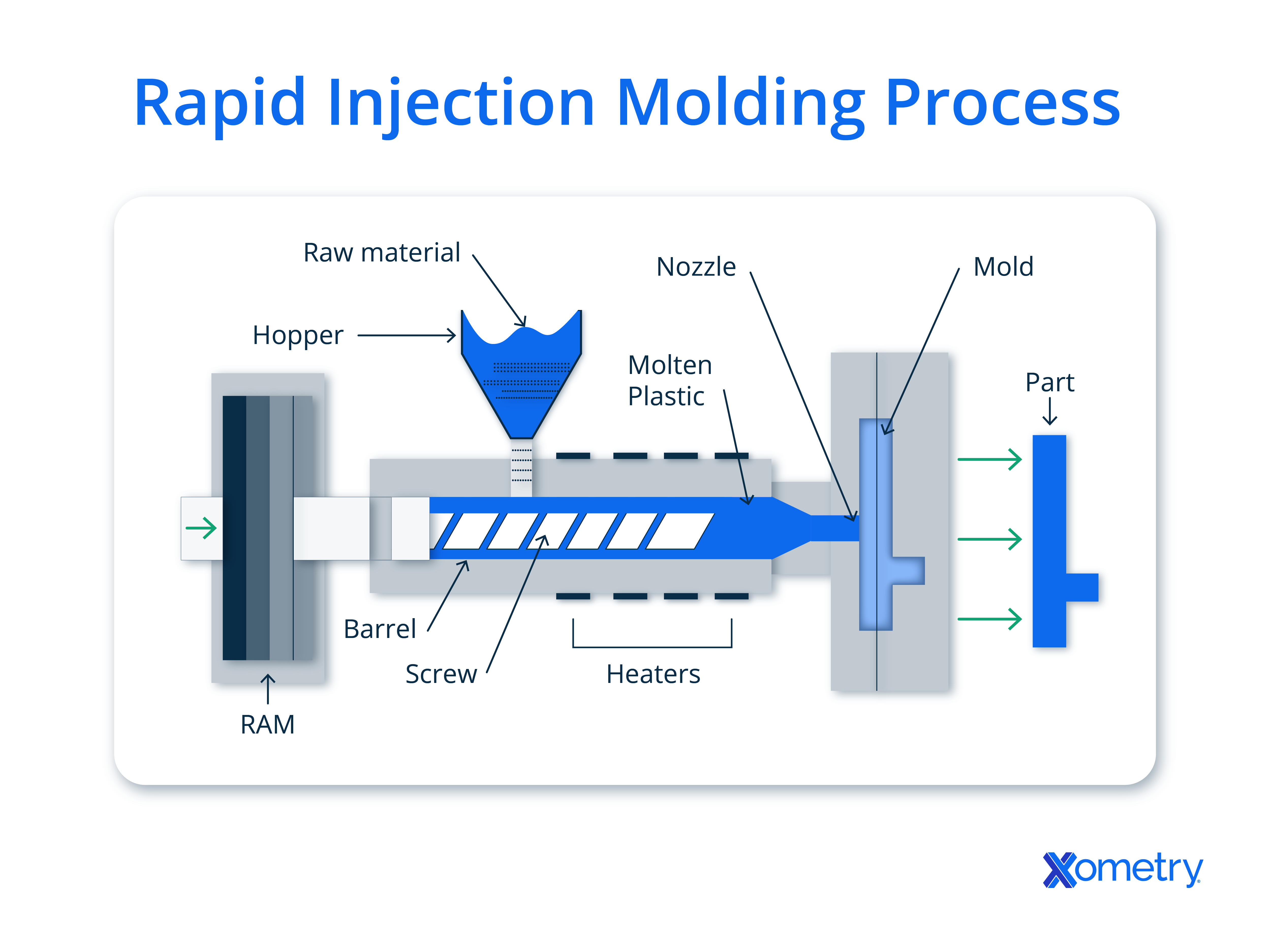

This article will describe the rapid injection molding process, explain how it works, discuss the equipment used, and provide some tips on selecting the optimal part material. A typical injection molding machine diagram is shown in Figure 1.

An illustration of the rapid injection molding process

Once the specialized RIM mold is manufactured, its two halves (core and cavity) can be mounted onto the stationary and moving plates of a normal injection molding machine setup, because the rest of the molding process is the same for both RIM and standard injection molding. The halves of the mold are brought together and held in place with hydraulic rams.
To actually make parts using the RIM process, the raw material (typically thermoplastics) is fed into a screw housed in a cylinder called a barrel. A combination of heat provided by external heaters mounted on the barrel and heat produced by shear (or frictional) forces between the plastic pellets and the action of the screw in the barrel, melts the plastic pellets. Once enough plastic has been melted, the screw pushes this plastic into the mold through a nozzle, and a one-way valve on the screw stops pressure from receding back into the screw. High-pressure plastic then fills the mold, and the hydraulic rams ensure that the plastic does not ooze out at the split line between the mold halves. After a few seconds, the plastic solidifies and the mold opens. The part is ejected using ejector pins, the screw retracts, and the process repeats. It is worth noting that rapid injection molding does not produce individual parts any faster than standard injection molding.

1. Hopper
The hopper is where the thermoplastic resin pellets are placed for dispensing. The hopper is normally fed from bulk bags or a silo, depending on the required production volume and part size. This hopper provides a continuous supply of material to the screw. In some cases, it dries or preheats the resin to improve melt consistency in the screw and barrel. This reduces the per-part production cycle time. The hopper may also have level sensors to warn operators that they need to top up the material in the hopper.
2. Screw
The reciprocating screw has multiple functions. First, it meters and transports the correct amount of material from the hopper into the mold. While transporting the raw material, it rotates, forcing the pellets into an ever-decreasing volume, primarily due to the screw channel depth decreasing along its length. This creates enough heat to melt the pellets via the shear force created by the plastic pellets shearing against the screw and the barrel. Some screws also mix the material to create a more homogeneous melt, and in some cases, to ensure evenly mixed additives. Once enough material has been melted, the screw rams forward and a one-way valve at its tip prevents backflow, forcing the melt into the mold. The screw then retracts, and the process is repeated.
3. Barrel
The barrel houses the screw and is designed to guide the raw material into the mold. The barrel typically has heating elements wrapped around it to assist in melting the pellets. The screw forces the plastic pellets against the barrel and causes an increase in friction, which melts the plastic. The injection nozzle is located at the end of the barrel.
4. Heaters
The barrel has a number of electrical heaters wrapped around it to aid in heating up the plastic pellets. These heating elements initiate melting, but the majority of heat comes from shear generated by the screw. The screw action forces pellets against the barrel wall, generating shear heat that helps melt the plastic.
5. Materials
Rapid injection molding primarily uses thermoplastics, which may be commodity grades (such as polypropylene) or engineering grades (such as nylon and polycarbonate).
6. Nozzle
The nozzle directs the injected plastic into the mold.  It may have a diameter of anywhere from 2.5 to 10 mm, depending on the capacity of the injection molding machine. The nozzle is screwed directly onto the barrel. Nozzles may have filters to prevent unwanted particles from entering the mold. There are two different filter styles: screen pack and gap filters. Screen pack filters are not popular, as they impede the flow through the nozzle, creating pressure loss. In contrast, gap filters provide a larger filter area and do not impede the flow as much. Nozzles can also have a mixing function that creates a homogeneous melt and helps in dispersing additives like colorants more evenly throughout the melt.
7. Mold
The mold is typically made from two parts: the core and the cavity. The different parts of the mold are each mounted to a plate called a platen. One mold half is held stationary while the other half is pressed against it with a hydraulic ram. This ram applies enough pressure to ensure that the plastic does not exit the mold at the parting line. Molds often have cooling channels machined into them to allow for a heat transfer fluid to remove heat from the mold. These cooling channels help the part solidify quicker and reduce the overall cycle time. Once the part solidifies, the molds open, and a set of ejector pins pushes the part from the mold. The mold closes, and the cycle repeats.
RIM molds are often made from aluminum or softer steels and are designed to last from a few hundred to several thousand parts, depending on part complexity and material abrasiveness. Another method used to reduce costs and increase production speed in RIM is to use master unit dies (MUD), which allow for modular molds that enable quick implementation of design changes without having to remanufacture an entire mold from scratch.
