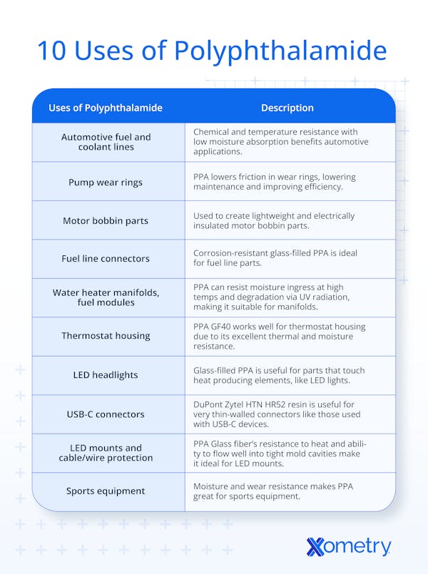

Polyphthalamide has excellent moldability, which makes it well-suited for injection-molded components with intricate features and thin sidewalls. This article will describe 10 uses of Polyphthalamide – as summarized in the table below – and give reasons why this material works so well.
A table outlining the 10 uses of polyphthalamide.
