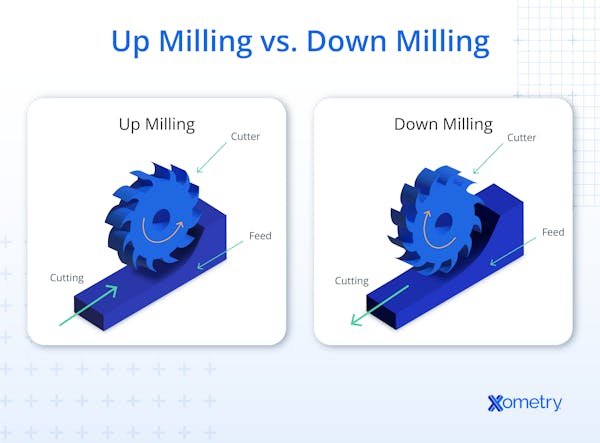

Key Differences Between Climb Milling And Conventional Milling
The key differences between climb milling and conventional milling boil down to the following:
  1. Cutting Direction and Chip Formation: In climb milling, the cutter rotates in the same direction as the feed. This means the cutting force is directed downward, aligning the chips' formation with the cutter’s movement. As a result, chips start thick and thin out, which minimizes wear on the cutting edge. Conversely, the cutter rotates against the direction of the feed with conventional milling. This setup leads to a scenario where the cutting force acts upward, initiating chip formation that is thin and grows thicker. This can increase friction, heat, and wear on the cutting tool due to the greater resistance encountered at the start of each cut.
  2. Tool Engagement and Cutting Forces: In climb milling, the tool engages with the material at its maximum chip thickness and exerts a downward force. This stabilizes the workpiece but requires a rigid setup to prevent displacement. Conversely, with conventional milling, the tool engages at a minimum chip thickness, with forces that gradually increase and can lift the workpiece, demanding strong clamping.
  3. Surface Finish and Tool Life: Climb milling often produces a superior surface finish because the cut starts with the largest chip thickness and ends with the smallest, thereby exerting less force on the material at the point of exit. This smooth transition typically reduces the tearing of the material surface. Conventional milling, on the other hand, is more likely to yield a rougher finish due to the potential for greater tool deflection and the chance of recutting chips that are not ejected efficiently from the cutting area.
  4. Impact on Machine Performance and Stability: Climb milling demands precise machinery capable of handling its downward cutting forces without causing backlash. This is ideal for newer CNC machines with backlash compensation. Conventional milling is less dependent on machine precision. It is better suited for older machines or those with potential backlash effects, but may require more extensive work holding to counteract lifting forces during cutting.
  5. Tool Wear: Climb milling typically experiences less tool wear due to the consistent cutting load and efficient chip removal. The process also generally operates at cooler temperatures, further extending tool life. Conversely, conventional milling tends to have more tool wear due to the high-friction environment created by the tool engaging the workpiece with minimal cutting action at first, then gradually increasing to full engagement.
  6. Safety and Control: While offering numerous benefits, climb milling can potentially pull the cutter into the workpiece if not adequately controlled or if the machine exhibits backlash, posing significant safety risks. Conventional milling provides more control over the cutting process, as the cutter tends to be pushed out of the workpiece, reducing the likelihood of aggressive, unintended cuts.
An illustration showing the differences between up milling and down milling
An illustration showing the differences between up milling (conventional milling) and down milling (climb milling)
