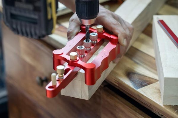

Drill bit and centering dowel jig. Image Credit: Shutterstock.com/kasarp studio
Jigs and fixtures may be small and inexpensive compared to other manufacturing aids, but without them, parts wouldn’t be as consistent, functional, accurate, or even as aesthetically pleasing. Often confused for one another, jigs and fixtures are manufacturing aids that most times work together, but are very different.
Let’s take a look at exactly what these manufacturing aids are, how they’re used, and how you can design your own for your manufacturing needs.
What Are Jigs in Manufacturing?
A jig is a typically lightweight aid designed to guide a tool so that it can repeat a specific task in the same manner every time. It’s used mainly in manual jobs like drilling and tapping. It provides a sort of template that makes sure the tool does always the same thing. For instance, if you want holes that are evenly spaced out on a part, a jig will show the tool where to drill and prevent it from drilling outside of the designated spot. Jigs can also save you some money. If you want to drill a hole at an angle (that isn’t just a simple up and down) without a jig, a 3-axis machine won’t be able to do it because it doesn’t have the ability to tilt either the tool or the part. The hole would simply just have to be drilled straight in. You could do this with a 5-axis machine since these can tilt and move as required, but these machines are notoriously expensive. The lowly jig is a very simple and cost-cutting solution to this problem. Take a look at the picture below to get an idea of what a jig could look like:
centering dowel jig
A drilling jig being used to make strong joints. Image Credit: Shutterstock.com/kasarp studio

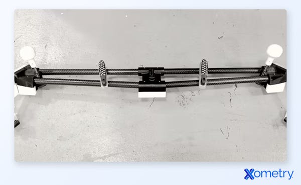

A fixture has one task, and that is to hold a material or workpiece in the right place to allow the tool to do its job. Without the fixture, there’s a good chance of the material moving and you could end up drilling or cutting in the wrong place. They’re fixed in place and more about supporting and positioning each workpiece in the exact same way so that the tool will drill or cut it (and all following pieces) consistently. Although they’re not exactly clamps, they can be actuated so that they do clamp onto a material when it’s in the correct position. A good example is a robotic arm. Fixtures are used in processes like milling, turning, broaching, grinding, and fabrication, and can look something like this:
A Xometry-manufactured fixture used for alignment of the vehicle back end during assembly processes. The fixture is made up of cut carbon fiber tubing, CNC machined plastic and metal parts, and 3D printed Ultem components made by Xometry.

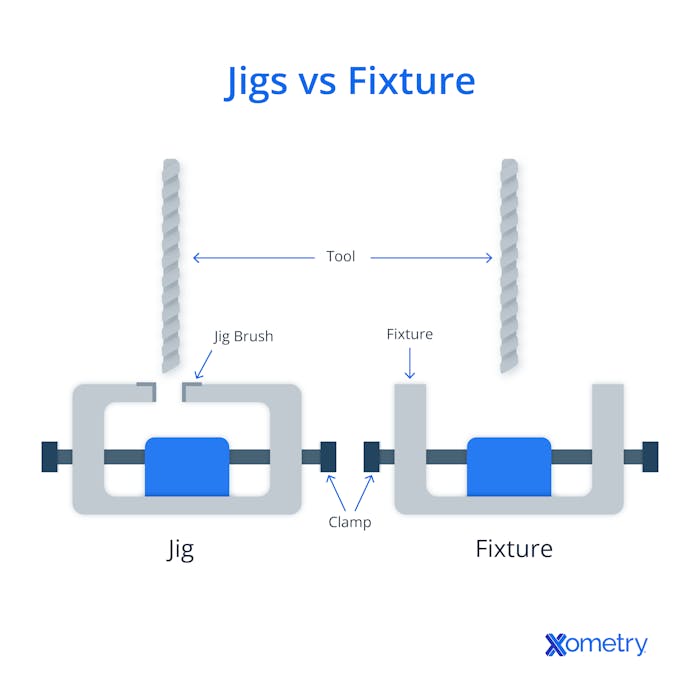

Jigs are the Bonnie to fixtures’ Clyde, and vice versa. As mentioned, jigs guide the tools, and fixtures align and hold the parts or materials that will be worked on securely in place. Together, they offer just about the most precision you can get in manufacturing — especially when it comes to mass production of an item — without having to resort to using (or investing in) a CNC machine. Here’s a visual representation of their differences:
Difference between jigs & fixtures
The difference between jigs & fixtures
