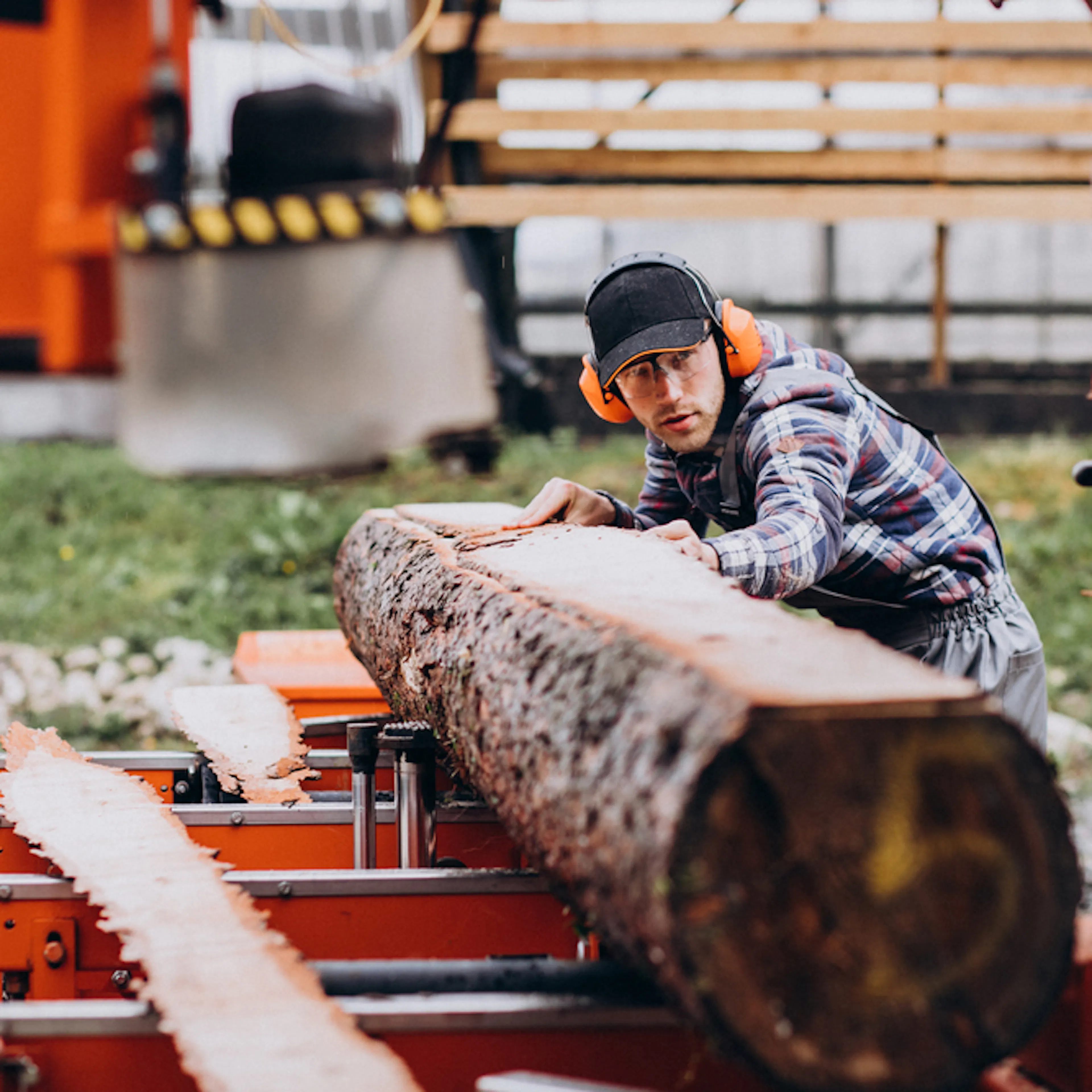

Sawmilling. Image Credit: Shutterstock.com/PH888
Sawmilling is essential for converting raw logs into usable lumber, which meets the demand for processed wood products in the lumber industry. Sawmills, ranging from traditional to modern, facilitate this conversion process. Sawmills produce various lumber products from logs of different tree species.

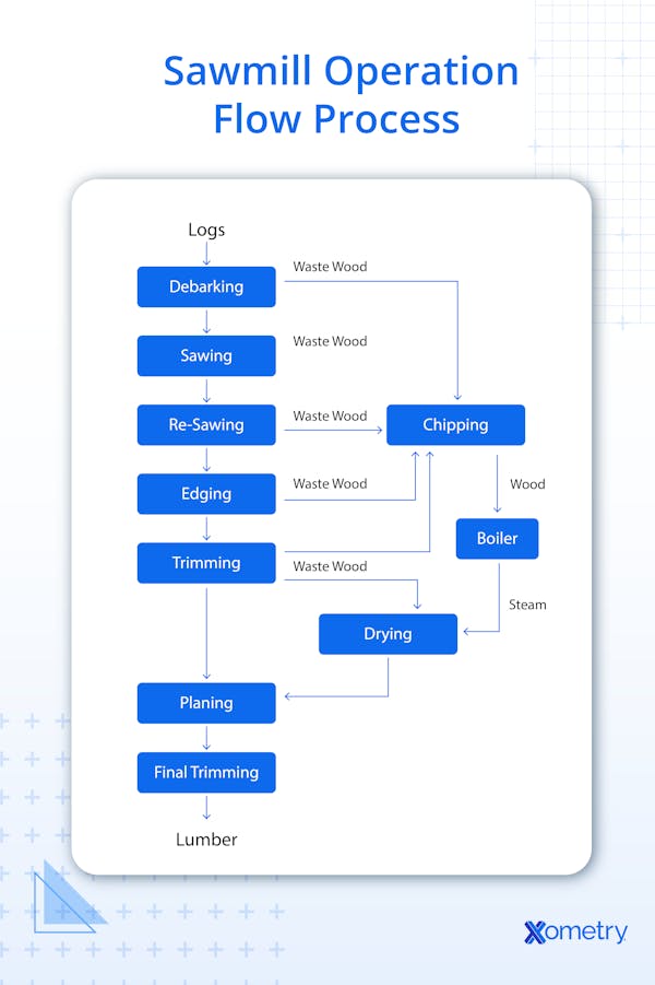

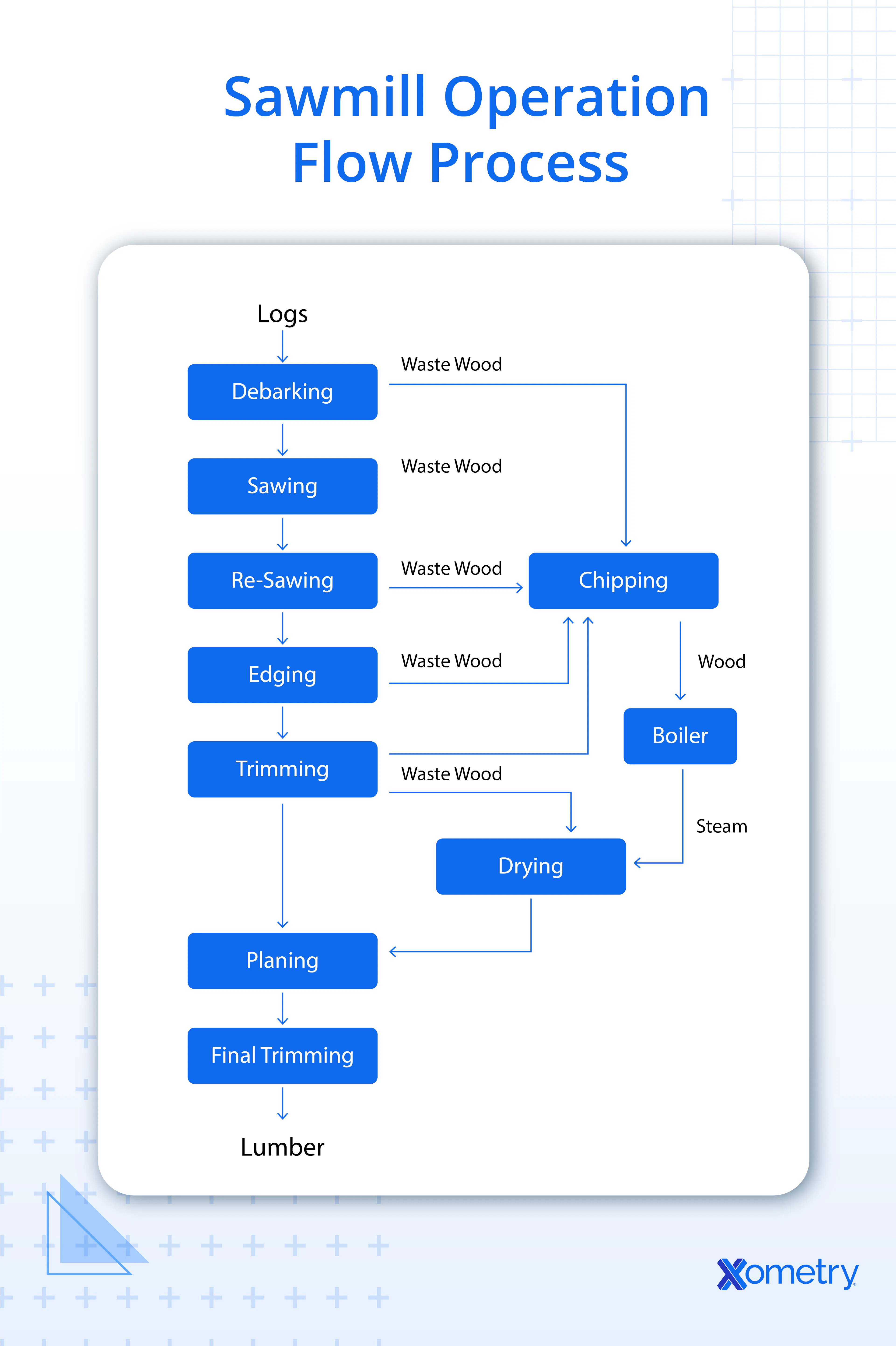

A sawmill operates through a systematic process, as illustrated in a sawmill process flow diagram in Figure 1 below:
An illustration of the sawmilling process.
The process begins with debarking, followed by primary sawing to produce cants and flitches, then resawing, edging, trimming, drying, and planing. The final trimming ensures precise dimensions, yielding lumber. Waste wood is repurposed into products like wood chips, mulch, or fuel for drying kilns and boilers. Chipped wood can be used in boilers to generate steam, which powers drying kilns or mill equipment. This cyclical and efficient workflow maximizes resource utilization and minimizes waste. The integration of various stages, from log processing to energy generation, characterizes the comprehensive and sustainable nature of sawmill operations.
