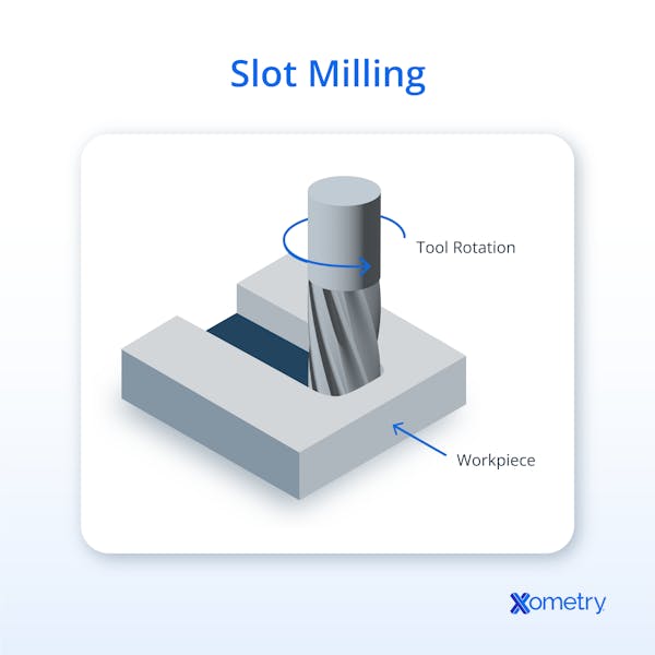

How Does Slot Milling Work?
Slot milling is a machining process that uses a rotating tool with multiple cutting edges. Key factors affecting the outcome include the required geometry (width, depth, undercut) and the workpiece material. The correct choice of tools, feed rate, speed, and cooling fluids can have a dramatic effect on the ultimate quality of the machined feature.
A diagram of slot milling.
