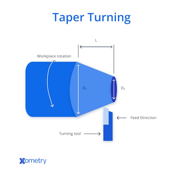

An illustration of taper turning in machining.

What Is Taper Turning?
Taper turning is a lathe operation used to create a conical shape by gradually reducing the diameter of a cylindrical workpiece along its length. The method is valued for its ability to generate precision tapers while controlling heat buildup and tool wear. The outcome is a clean taper with a smooth surface finish suitable for tool holders and mating parts.
What Are Taper Turning Methods?
Taper turning can be achieved using several setups, depending on the desired precision and taper length. Common methods include:
  1. Tailstock Set Over, for short, gentle tapers.
  2. Taper Turning Attachment, which guides the tool along an angled path.
  3. Form Tool, which shapes the profile directly in one pass.
  4. Combining Feeds, in which longitudinal and cross feeds move together diagonally.
