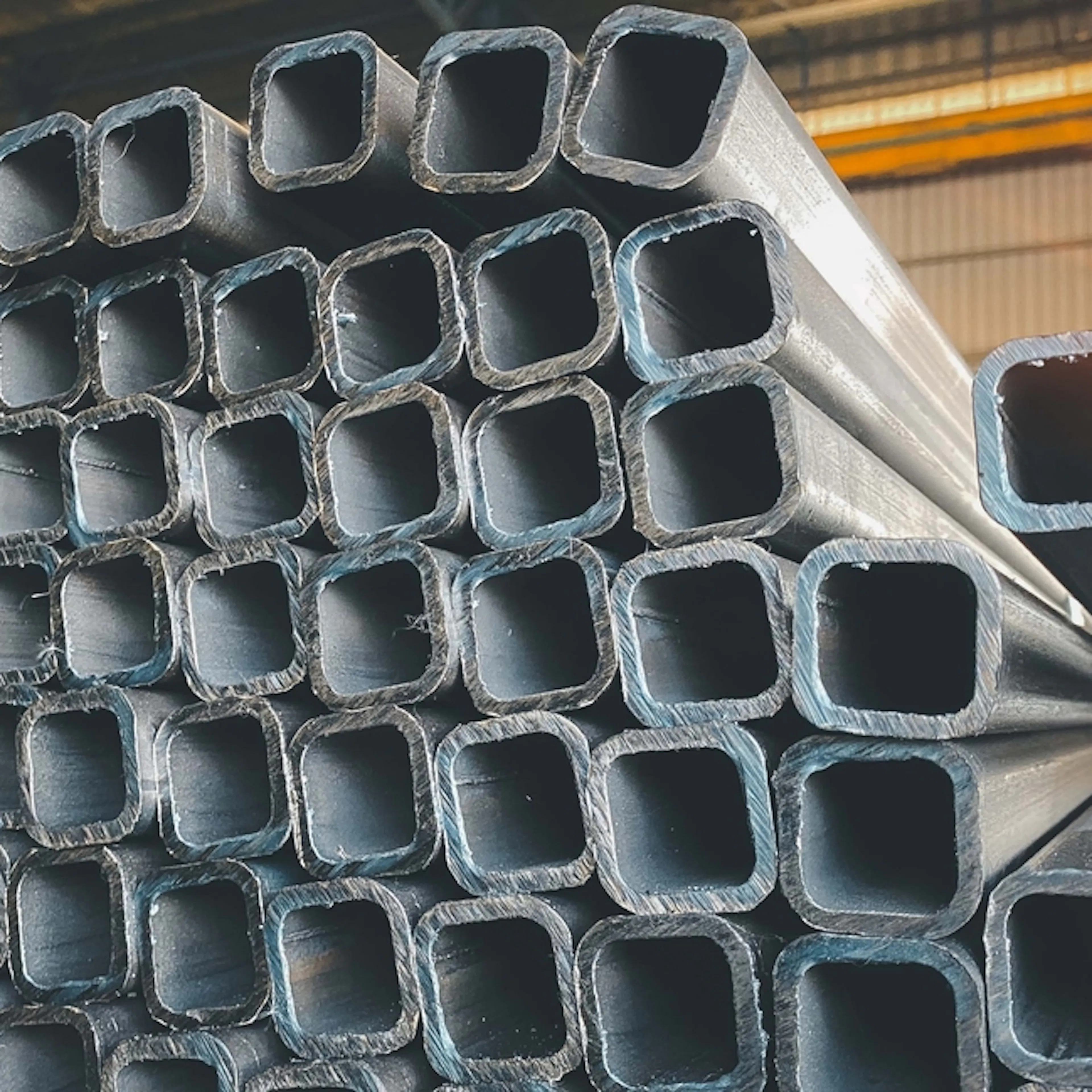

High carbon steel. Image Credit: Shutterstock.com/saweang.w
