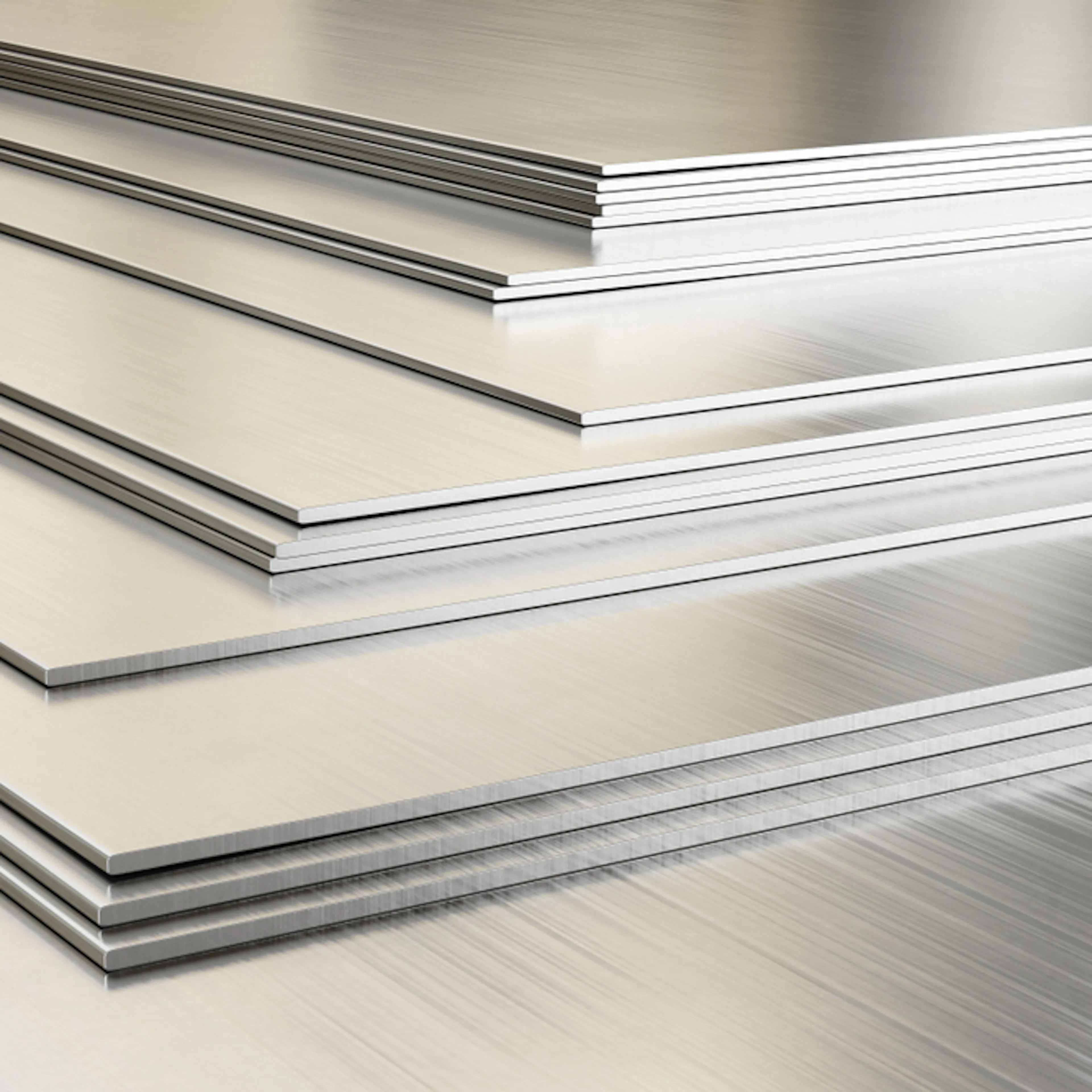

Essential facts and helpful pointers to have in mind when manufacturing with this common alloy
410 stainless steel sheet. Image Credit: Shutterstock.com/SimoneN

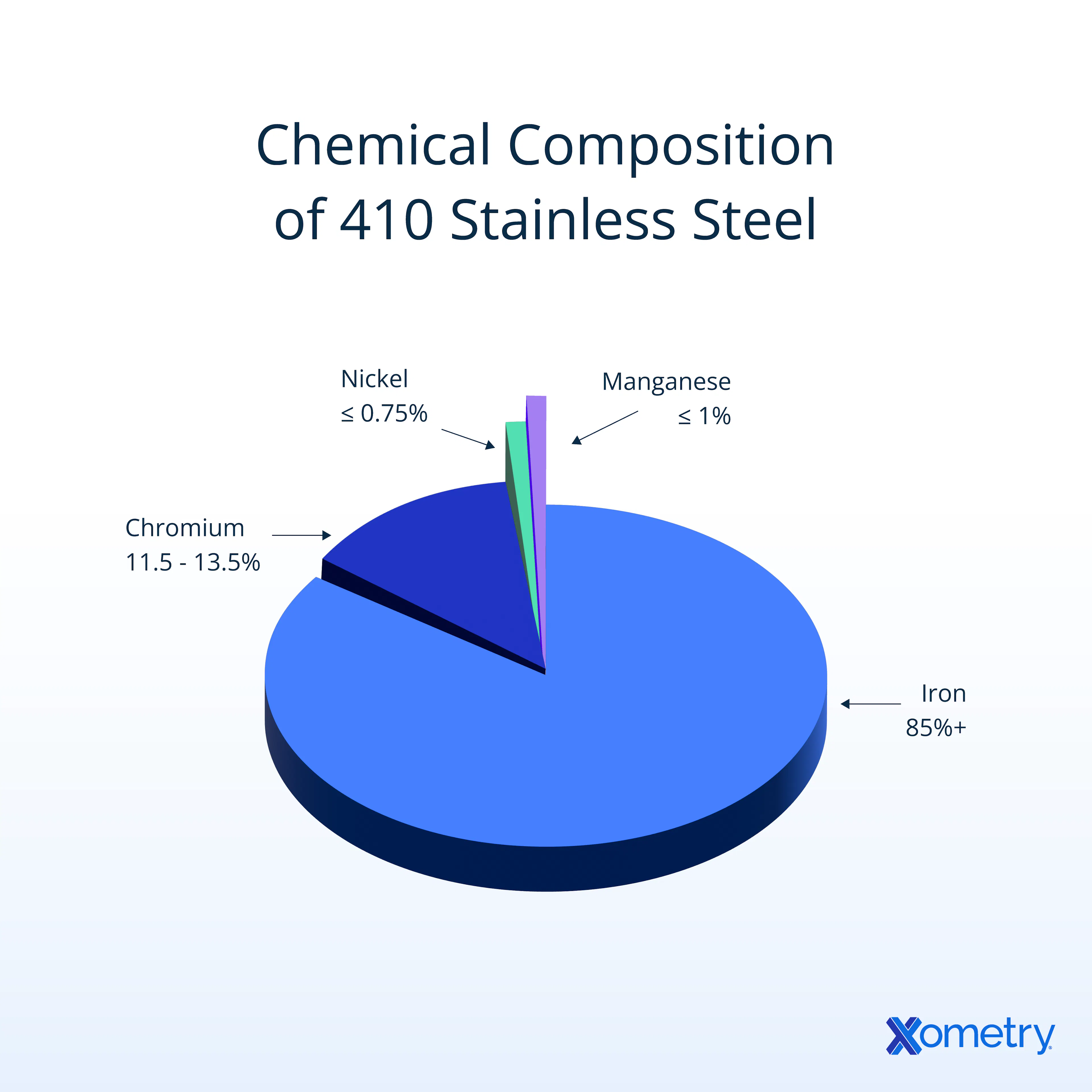

What Is the Chemical Composition of 410 Stainless Steel?
410 Stainless steel is mostly made up of iron. The rest of its chemical composition is shown in the pie chart below:
Chemical composition of 410 stainless steel
What Is the Carbon Content of 410 Stainless Steel?
410 stainless steels have around 0.1% carbon content. It has a higher carbon content than some mild steels, contributing to higher strength and reduced ductility. The general range of 0.08–0.15% is much less than that of medium-carbon steels which have 0.30-0.60% carbon.
