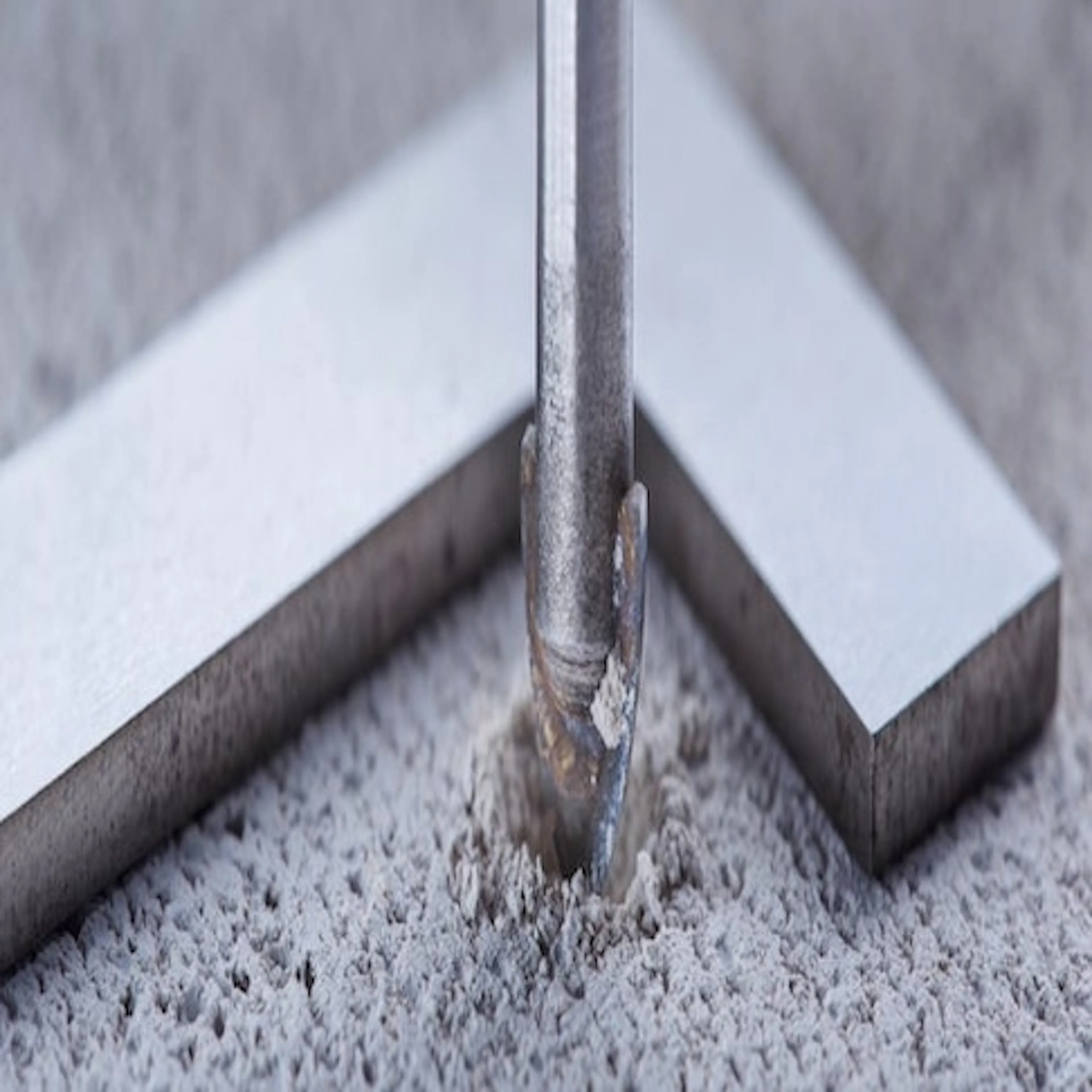

Alloy steel drilling - Image Credit: Shutterstock/evkaz

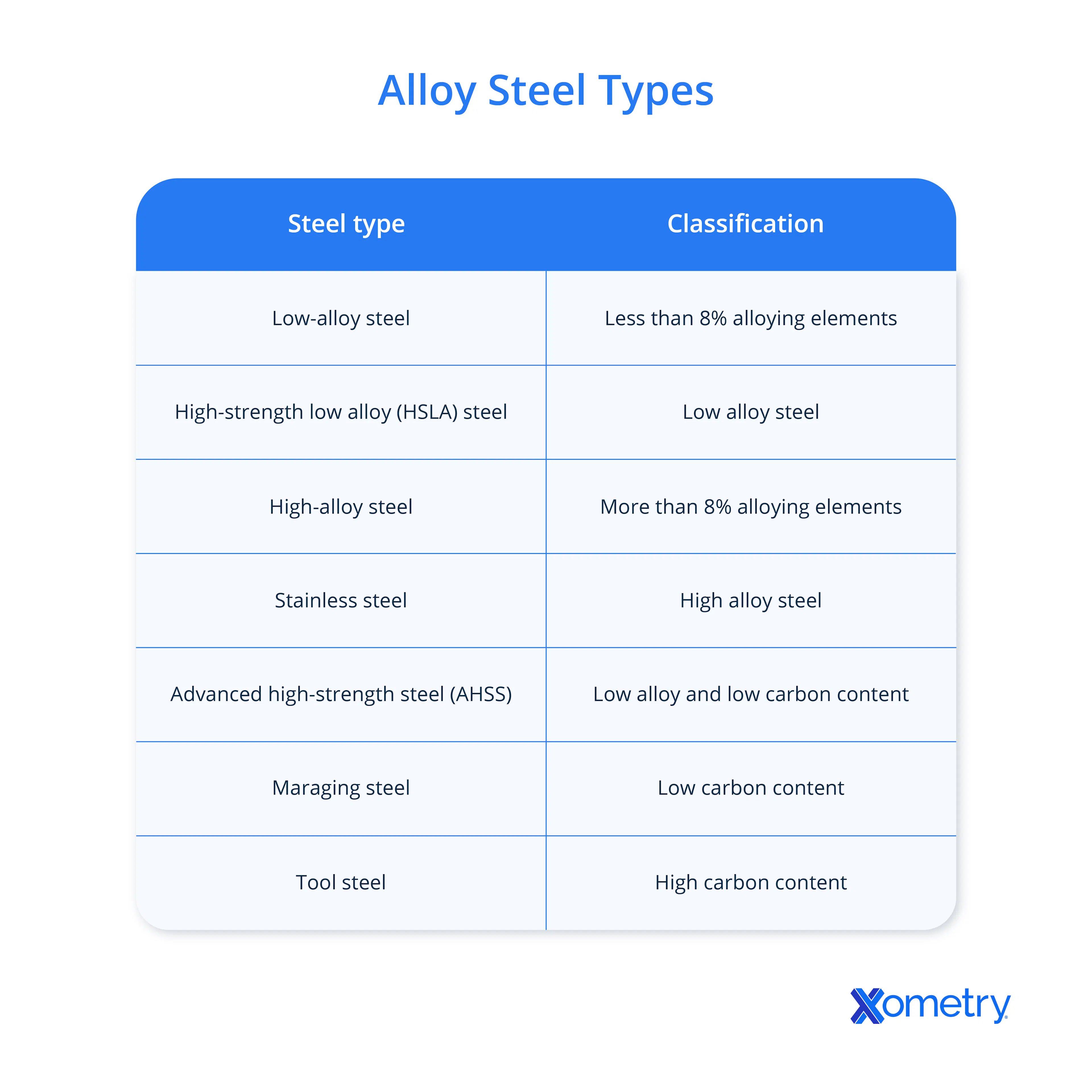

While low-alloy and high-alloy can be used to categorize alloy steels in a broad sense, we can actually get a bit more granular. In the table below, we break out the different types of alloy steel into seven categories instead of just the two we mentioned in the prior section. Following the table, we’ll go into a little more detail about each category.
To learn more, see our full article on Types of Alloy Steel.
Here’s the breakdown:
Alloy steel types
1. Low-Alloy Steel
Low-alloy steels contain elements (usually less than 8% of their total composition) that are added to improve the steel’s mechanical properties. So if molybdenum is added, it would increase the steel’s strength. To make it corrosion-resistant and improve its toughness and high-temperature strength, nickel and chromium could be added.
2. High-Strength Low Alloy (HSLA) Steel
High-strength low-alloy (HSLA) steel, also known as micro-alloyed steel, is strong and resistant to atmospheric corrosion. It’s often either hot-rolled or cold-rolled for the automotive industry to make things like suspension systems, wheels, seat mechanisms, or seat brackets. We can break down HSLA steel into six sub-categories: weathering steel, acicular ferrite steel, pearlite-reduced steel, dual-phase steel, control-rolled steel, and micro-alloyed ferrite-pearlite steel. HSLA steel can be very strong but hard to form. Sometimes, zirconium or calcium can be added to make it easier to work with.
3. High-Alloy Steel
High-alloy steel stands out because of its high alloy content, which is usually more than 8% of its total composition. It’s not the cheapest to make or the easiest to work with. However, because this type of alloy steel is very tough and corrosion resistant, it’s perfect for applications within the automotive, structural components, chemical processing, and power generation equipment sectors.
4. Stainless Steel
Stainless steel is probably the most well-known alloy steel around the world and one of the most popular types of steel Xometry customers choose for CNC machined parts. It’s also the most corrosion-resistant. It’s generally alloyed with some combination of nickel, chromium, and molybdenum as its major alloying elements, and these make up around 11–30% of its total composition. There are three subcategories: austenitic, ferritic, and martensitic. Let’s take a look at each of them.
  • Austenitic steels are common within the pharmaceutical, architectural, chemical, and mining sectors, where they’re used to contain corrosive liquids and machinery. They can contain a lot of nickel (up to 35%), molybdenum, chromium (16–26%), and niobium, and up to 0.15% carbon. They’re usually the most corrosion-resistant of all the stainless steels and have high formability and strength. They’re also great for extreme temperatures.
  • Ferritic steel contains less than 0.10% carbon and more than 12% chromium, which gives it its stainless properties. You’ll see this type of stainless steel used in industrial machinery and cars, and that’s mainly because it was designed to resist corrosion and oxidation, specifically stress cracking corrosion. Ferritic steel is basically unable to be hardened through heat treatment and can only be marginally hardened by cold rolling.
  • The last of the stainless steel sub-categories is martensitic steel which you probably have in your own home. It’s often used to make cutlery and has a general chromium content of 11.6% to 18%, as well as 1.2% carbon, and sometimes nickel is added. Generally, the highest chromium content of martensitic steels is lower than the highest in the other two categories. It hardens excellently but is only somewhat corrosion-resistant, making it ideal for cutlery, wrenches, surgical instruments, and turbines.
5. Advanced High-Strength Steel (AHSS)
Advanced high-strength steel (AHSS) is mainly found in automobiles as it’s great for reducing vehicle weight. It’s also very strong and easy to form with processes like sheet metal bending and metal stamping, both of which are services Xometry offers its customers.
6. Maraging Steel
Maraging steel is a special kind of steel alloy that has a low carbon content. Compared to most other types, maraging steel is incredibly strong, tough, and ductile. However, instead of carbon, precipitation of intermetallic compounds processes are used to harden it. The main precipitate types are Ni3Mo, Ni3Ti, Ni3Al, and Fe2Mo, which are also found in high-volume fractions. This is another steel type that’s popular in aerospace, as well as tool and weapon production. It can be 3D printed with our direct metal laser sintering (DMLS) process.
7. Tool Steel
Tool steel is a broad term that refers to a range of carbon and alloy steels that are suitable (i.e. hard, tough, wear-resistant, and can hold their own in high temps) for making tools. This type of alloy steel is used to make things like machine dies and hand tools, among others.
