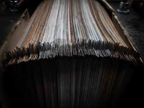

Electrical steel, also known as silicon steel or lamination steel, is a specific kind of steel made to have excellent magnetic properties. It is useful for a variety of electromagnetic applications. Its typical composition comprises iron and a range of silicon contents, with carbon and impurities forced to minimal levels. This type of steel is usually supplied in sheet form, intended for lamination, where multiple sheets are stacked together and insulated from each other.
Electrical steel is appropriate for power transformers, electric motors, generators, and other electrical equipment because of this combination of elements' efficient magnetic performance. Electrical steel is usually made in an electric arc furnace and then processed down to thin sheet form for use in laminated transformers. We will go into greater detail on the composition, characteristics, and uses of electrical steel in the sections that follow, illuminating its essential place in contemporary electrical engineering.

What Is the Most Common Form of Electrical Steel?
The most common form of electrical steel is in the shape of thin sheets, typically coated with insulating materials. They are used as laminations stacked to form cores for transformers, motors, and generators. The lamination process reduces eddy current losses and enhances the efficiency of electrical devices.
