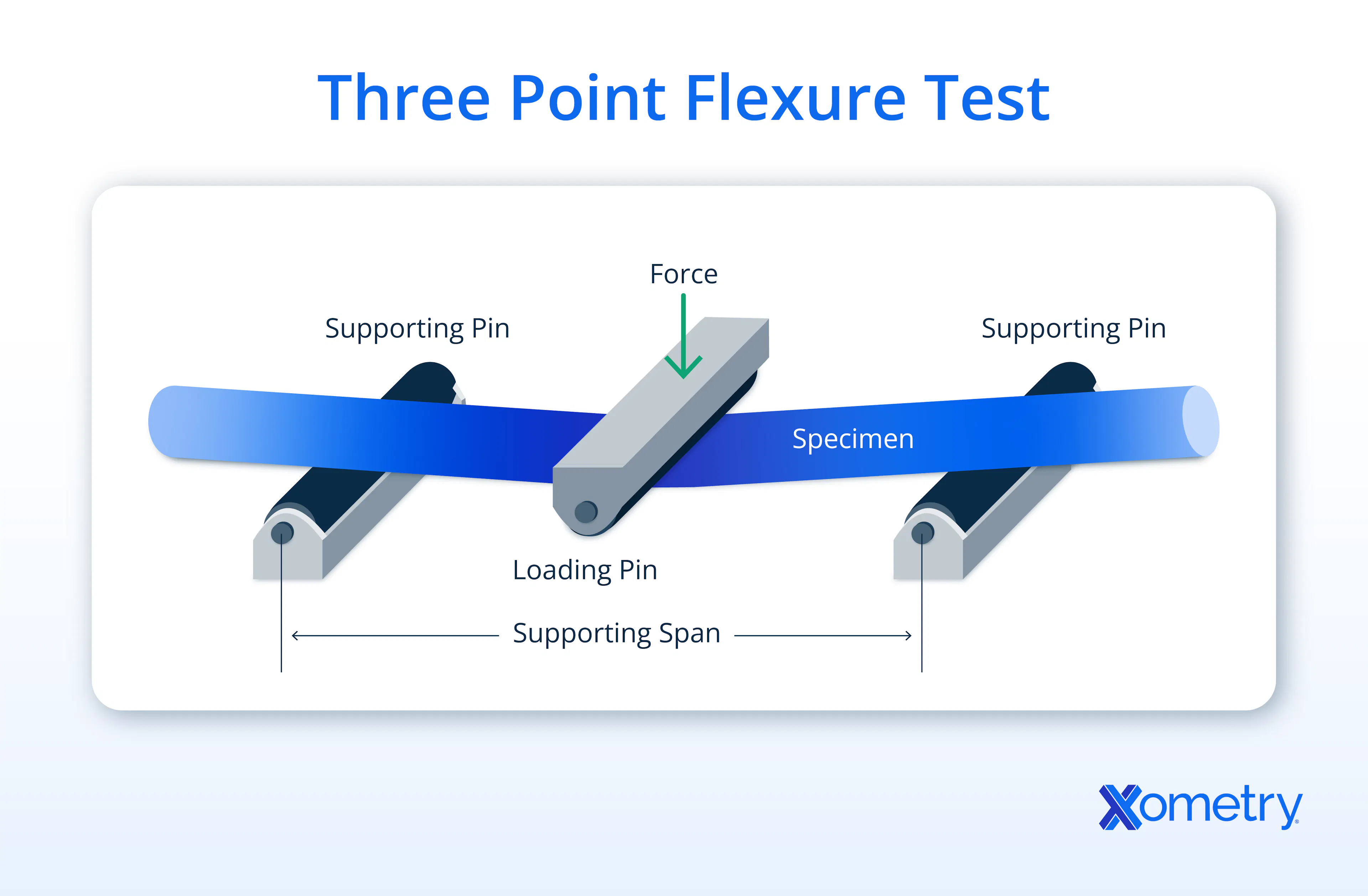

During flexure/bend testing, a sample or specimen is placed on supports. A force is applied to the center or at specific points on the specimen. This force causes the specimen to bend or flex, and the resulting deflection or strain is measured.
A flexure/bend test is performed using a universal testing machine. These machines are designed to assess the ductility, bend strength, fracture strength, and resistance to fracture of materials. A bend test is specifically designed to evaluate the crack resistance of ductile materials. During a bend test, forces are applied to the sample in a manner that induces deformation, emphasizing any flaws or cracks present in the material. This allows for the assessment of the material's ductility. These tests are typically conducted on ductile metals and metal products.

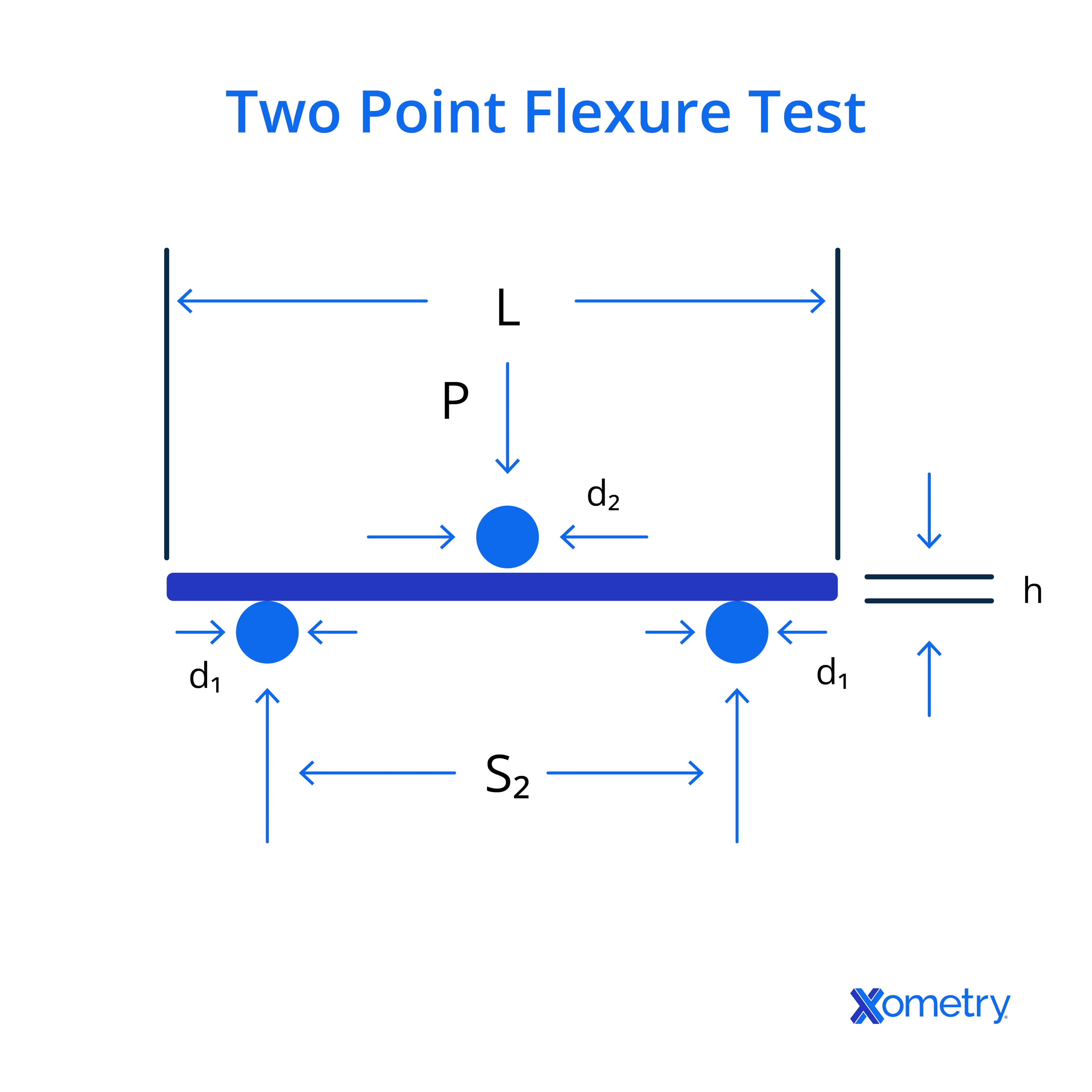

Two-Point
Setup
One end clamped, force applied at a set distance from the clamp
Effect
Creates a deflection-causing bending moment
Applications
Thin and flexible materials like paper, cardboard, and films

Sample supported at two outer points, load applied in the center
Effect
Localized force at the midpoint
Applications
Tough and elastic materials, widely used for plastics, metals, and composites

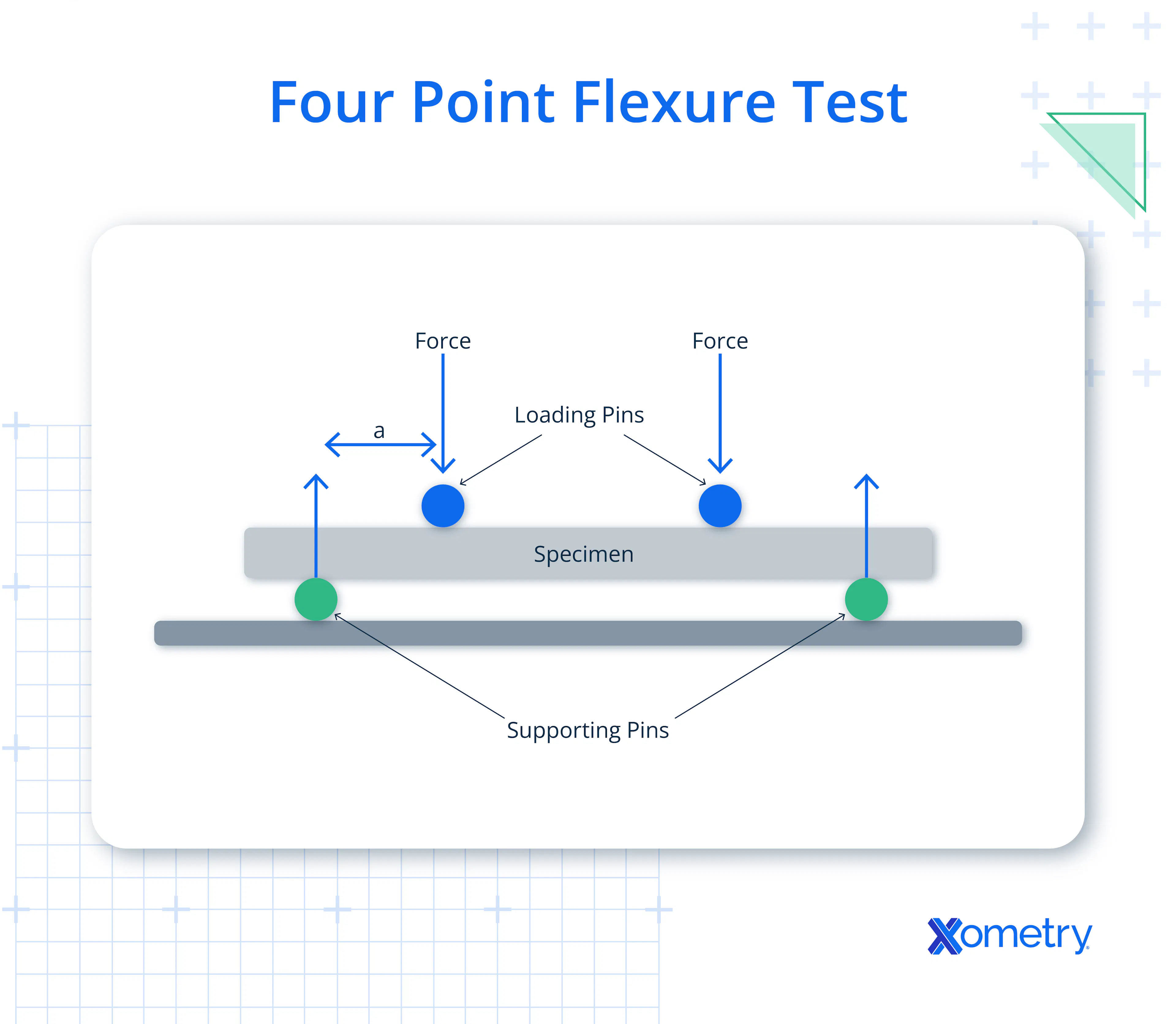

Sample supported at two outer points, load applied at two inner points
Effect
A more complex bending moment with uniform stress distribution, reducing peak stress
Applications
Brittle materials like ceramics and glass-fiber composites

Two point flexure test illustration
Three point flexure test illustration
Four point flexure test illustration
An illustration of a two point flexure test.

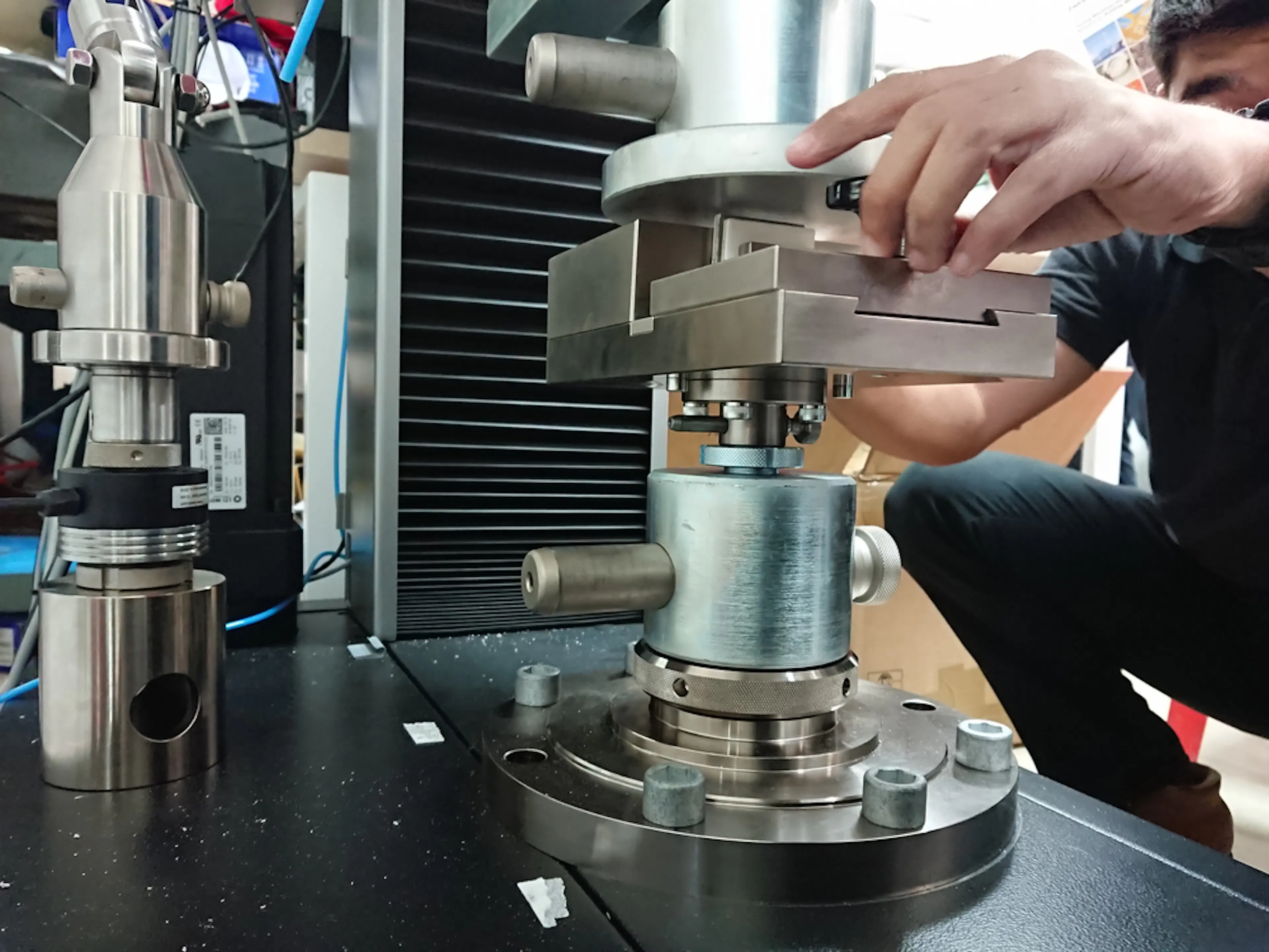

To perform a flexure/bend test, you’ll need the material sample being tested, which is usually rectangular or cylindrical, and a universal testing machine (UTM), which is a specialized flexure testing device that applies the load and measures the response. In addition, fixtures, supports, and anvils to hold the specimen in place (based on the test type) are needed, as well as measurement devices, like strain gauges, extensometers, or displacement sensors to track deflection and stress distribution.
What is the Process of Flexure/Bend Testing?
Once you’ve got all the necessary equipment, here are the steps in the flexure/bend testing process:
  1. Cut and prep your sample, and inspect it for defects.
  2. Place the material on the supports and calibrate the machine according to the chosen testing standard (ASTM, ISO, etc.).
  3. Set the machine to apply the force at the designated point(s), which will cause the sample to bend.
  4. Measure track deflection, stress, and strain as the force increases.
  5. Keep going until the sample reaches its breaking point or its maximum deflection limit.
