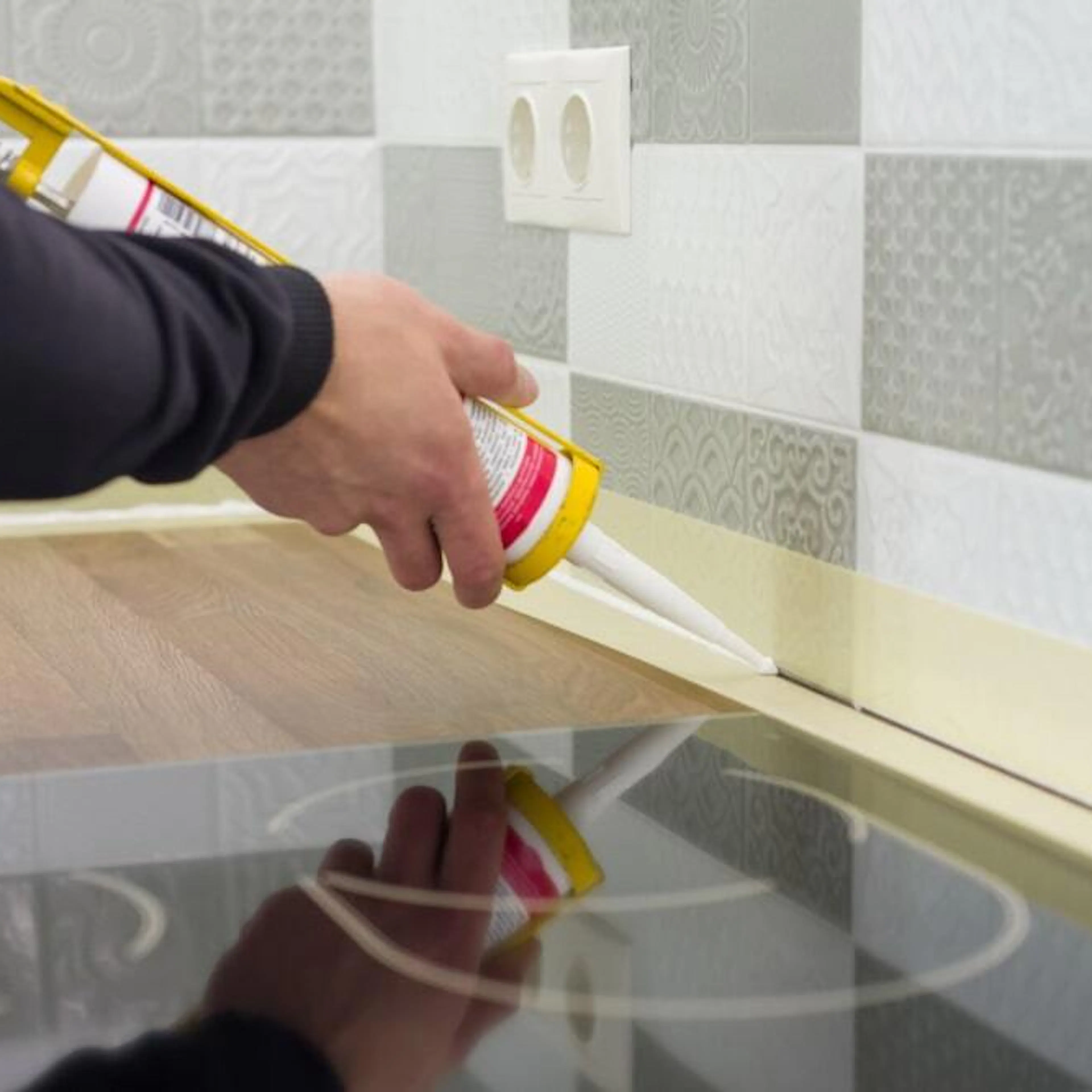

Applying silicone sealant with construction syringe. Image Credit: Shutterstock.com/VH-studio

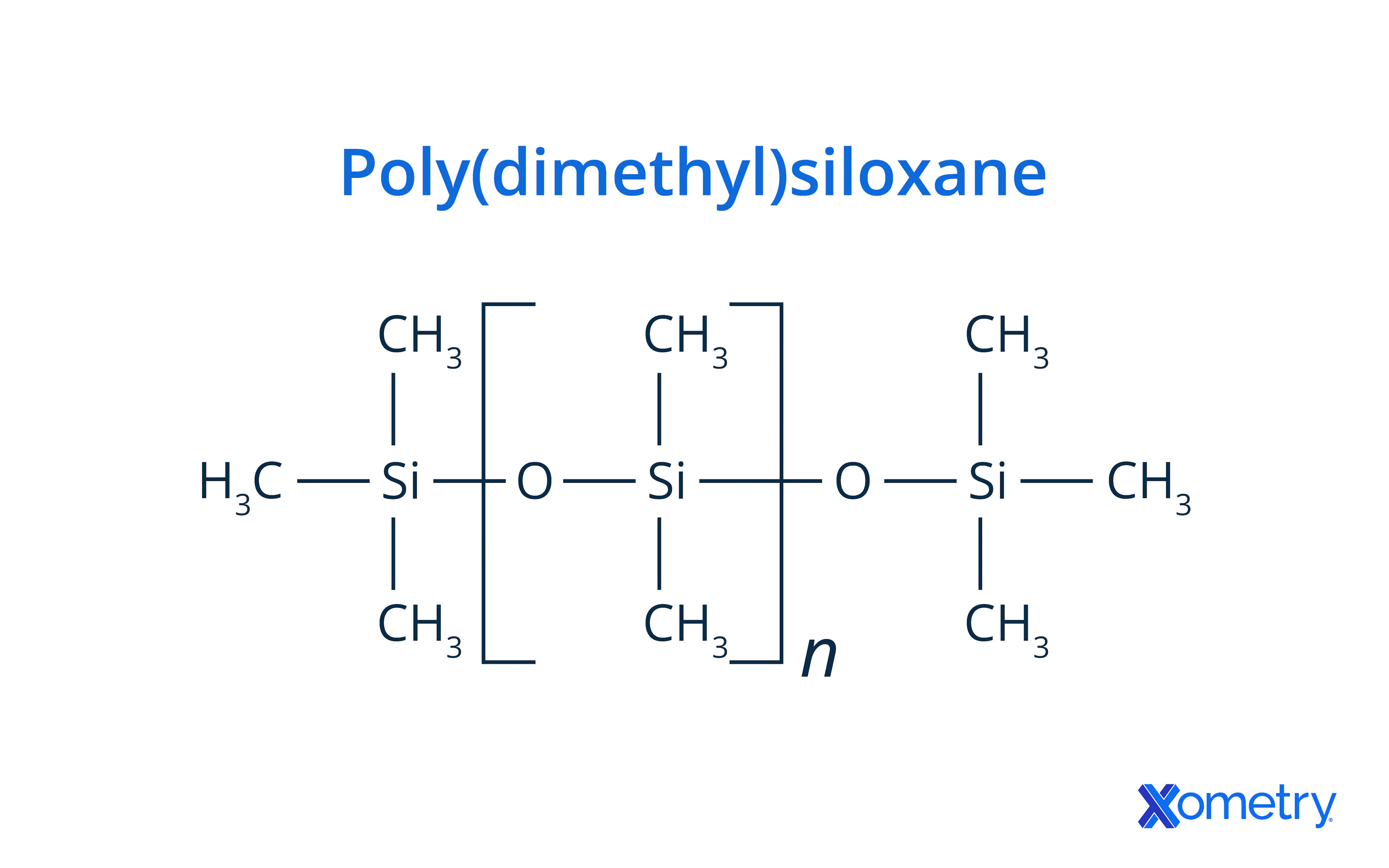

What is Silicone's Chemical Composition?
Silicone, technically referred to as “polysiloxane,” consists of a chain of alternating silicon and oxygen atoms. Silicon atoms, like carbon atoms, have space for four covalent bonds with other atoms. Two of those spots are occupied by oxygen atoms, one on each side. The other two spots will bond with other molecular groups that are available. The general chemical formula for silicone is [R2SiO]n. “R” indicates whatever groups are attached to the silicon atoms. The most common silicone is polydimethylsiloxane (PDMS), in which methyl groups (CH3) are attached to the silicon atoms along the Si–O backbone. Its general formula is [–Si(CH3)2–O–]n. Although it contains organic groups, the backbone itself is inorganic (Si–O), giving it hybrid organic–inorganic polymer properties. Figure 1 shows the chemical structure of polydimethylsiloxane.
poly(dimethyl)siloxane molecular structure
Poly(dimethyl)siloxane molecular structure
