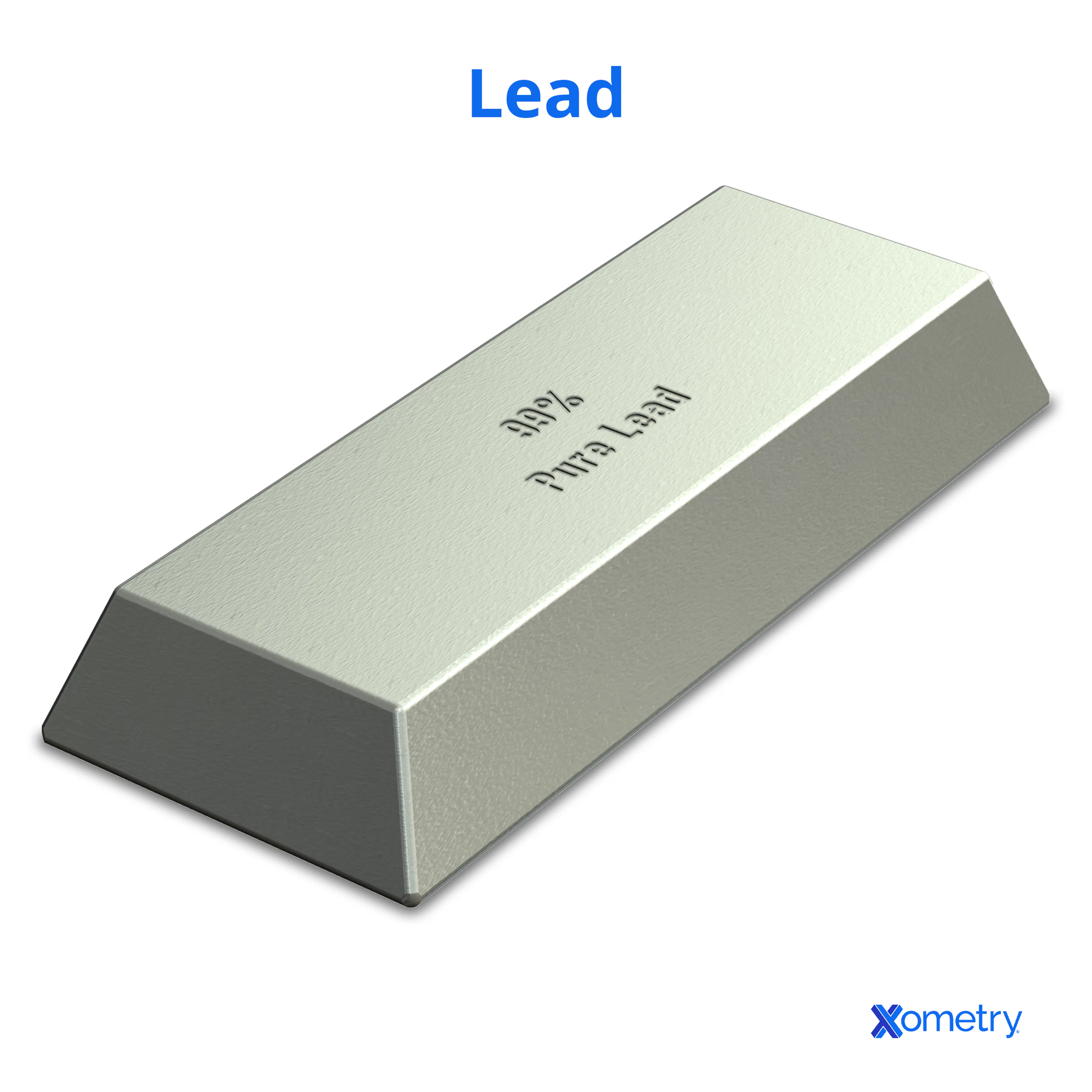

Lead ingot. Image Credit: Shutterstock.com/KimTieng Tow
Lead is the chemical element represented by the symbol Pb and possesses the atomic number 82. It is a heavy metal with various properties that have made it useful for a range of applications. Lead is also profoundly and near-universally toxic, which has led to progressively increasing and significant restrictions on its use in most industrial and domestic applications.
Lead has been used in the production of: batteries, radiation shielding, ammunition, and soldering materials. It is also still widely used as an alloying element in various materials to facilitate free-cutting properties. This article will discuss lead, its properties, importance, uses, and advantages.

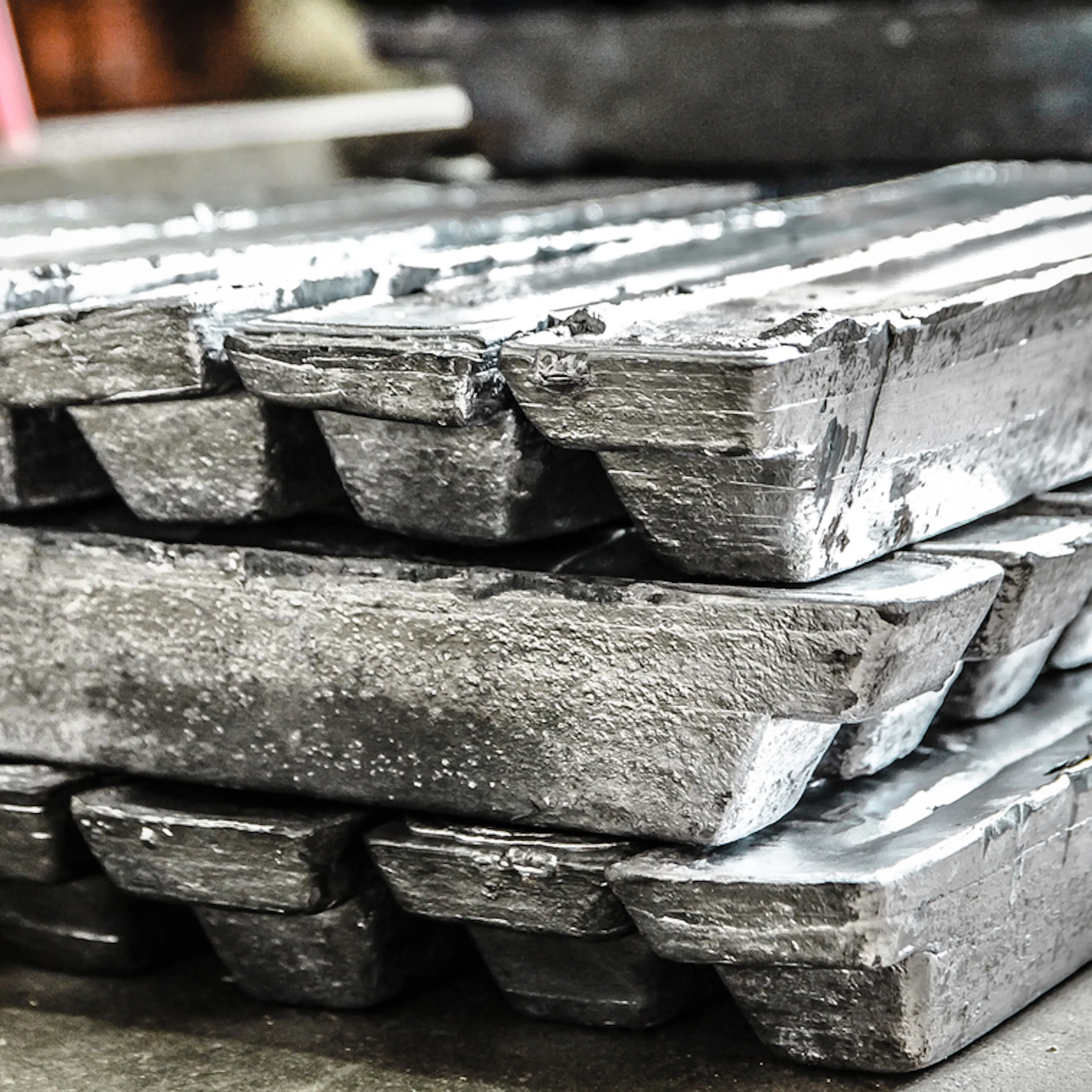

Lead was one of the first metals known to man. It does not generally exist in metallic form in nature. However, it is easily extracted from various minerals by the application of heat and charcoal. outcome.
Lead has many applications due to its: flexibility, malleability, abundance, and ease of refinement and use. Lead’s widespread use is in part explained because its properties can be enhanced by alloying it with other metals such as antimony or copper. It played a crucial role during the Industrial Revolution. Pure lead is bluish-white in color with a bright luster, and crystallizes in a face-centered cubic structure, with no known allotropic modifications. On exposure to moisture, this luster is lost through the formation of an oxide coating that protects the underlying metal, slowing bulk oxidation.
Pure lead
Pure lead
