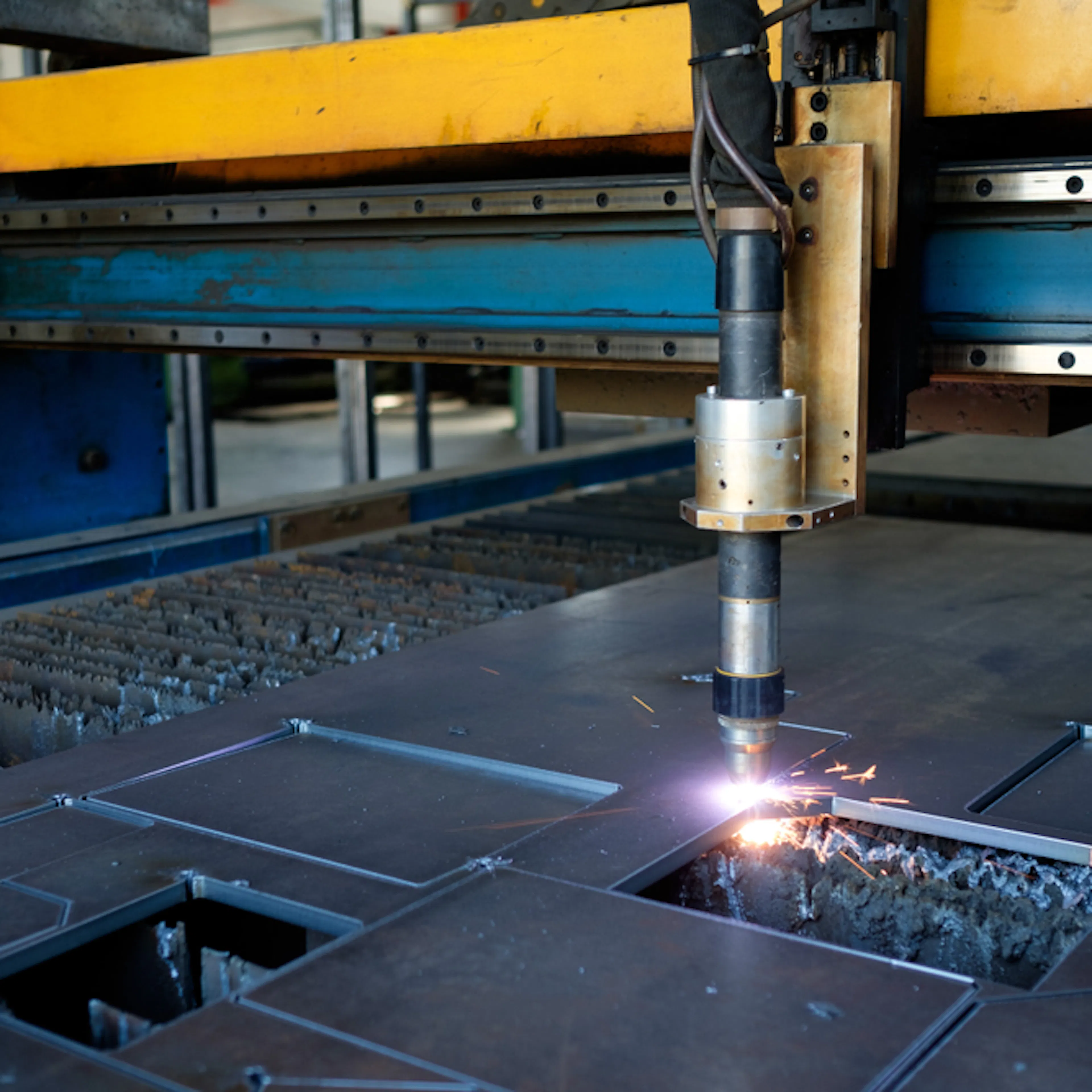

Plasma cutting machine. Image Credit: Shutterstock.com/Codegoni Daniele

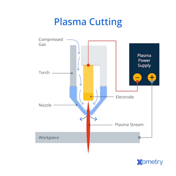

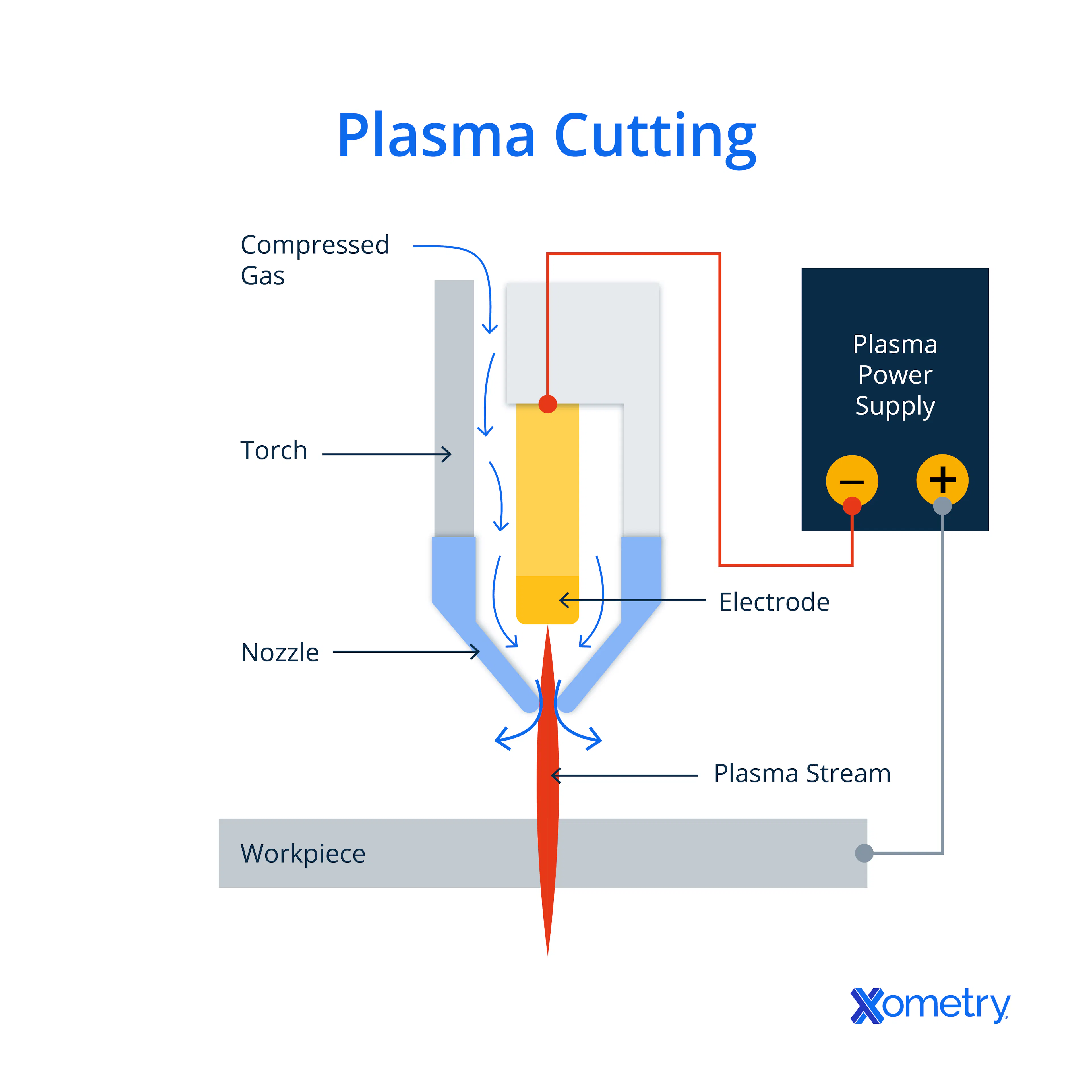

Plasma cutting is a cutting process that employs heat to cut through metals or electrically conductive materials such as aluminum, steel, brass, and copper. The thermal cutting process of this technology works by creating an electrical channel of ionized gas, known as plasma. A gas (oxygen or nitrogen) passes through a small nozzle while subjected to a high electrical voltage. The result of this process is an electrical arc that strikes the material of choice to cut it. Plasma can reach temperatures of up to 40,000°F, which melts and cuts through the material.
This method of cutting is faster than conventional cutting methods, including mechanical cutting and oxy-fuel cutting. Various cuts can be made depending on the device's power and the thickness of the materials, ranging from thin sheets to thick sheets. The cost of a plasma-cutting device can vary depending on the power and size of the system, as well as any additional features it may have. On average, the price of a small, portable plasma-cutting system costs about $2,000, while a larger industrial-grade system costs about $10,000. The choice between a laser cutter and a plasma cutter will depend to a large extent on the specific requirements of the application. For instance, lasers are usually more expensive and cut greater levels of detail. On the other hand, plasma can be used to cut thicker metal plates than lasers.
An illustration of plasma cutting.
