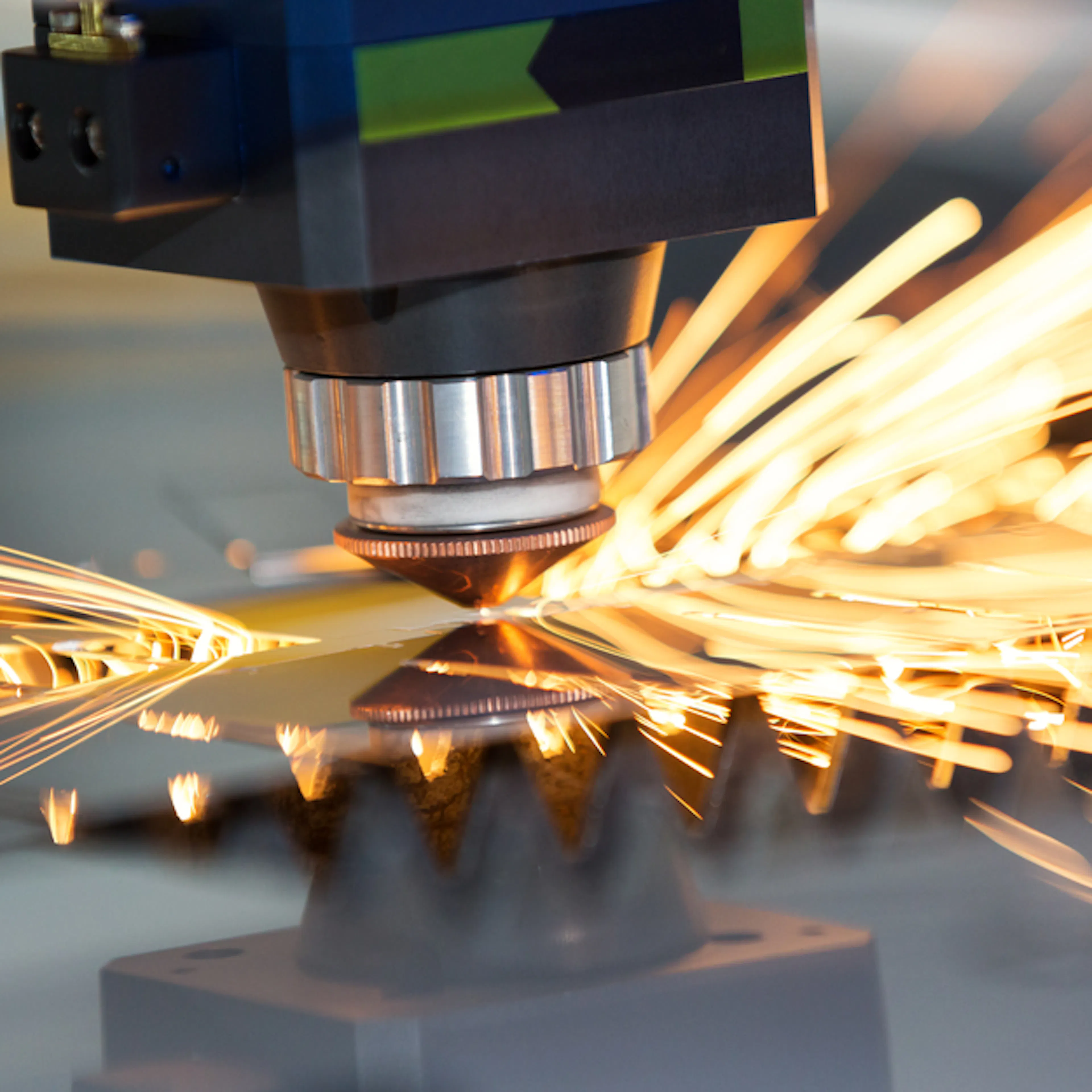

Laser welding. Image Credit: Shutterstock.com/Aumm graphixphoto
Laser welding is used in many industries because it’s accurate and quick and can be used for many projects. At Xometry, our manufacturing partners may use this technique when welding sheet metal components and assemblies. The laser welding manufacturing process works with a highly concentrated light beam that melts and fuses materials together to create a strong bond.
