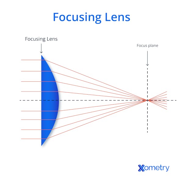

1. Lens
A focusing lens of known focal length and minimal aberration is used to bring the collimated laser beam to a waist. This allows the beam radius to be measured at defined positions along the propagation axis. The lens properties (focal length, coatings, and optical quality) must be well characterized to ensure accurate M² determination.
