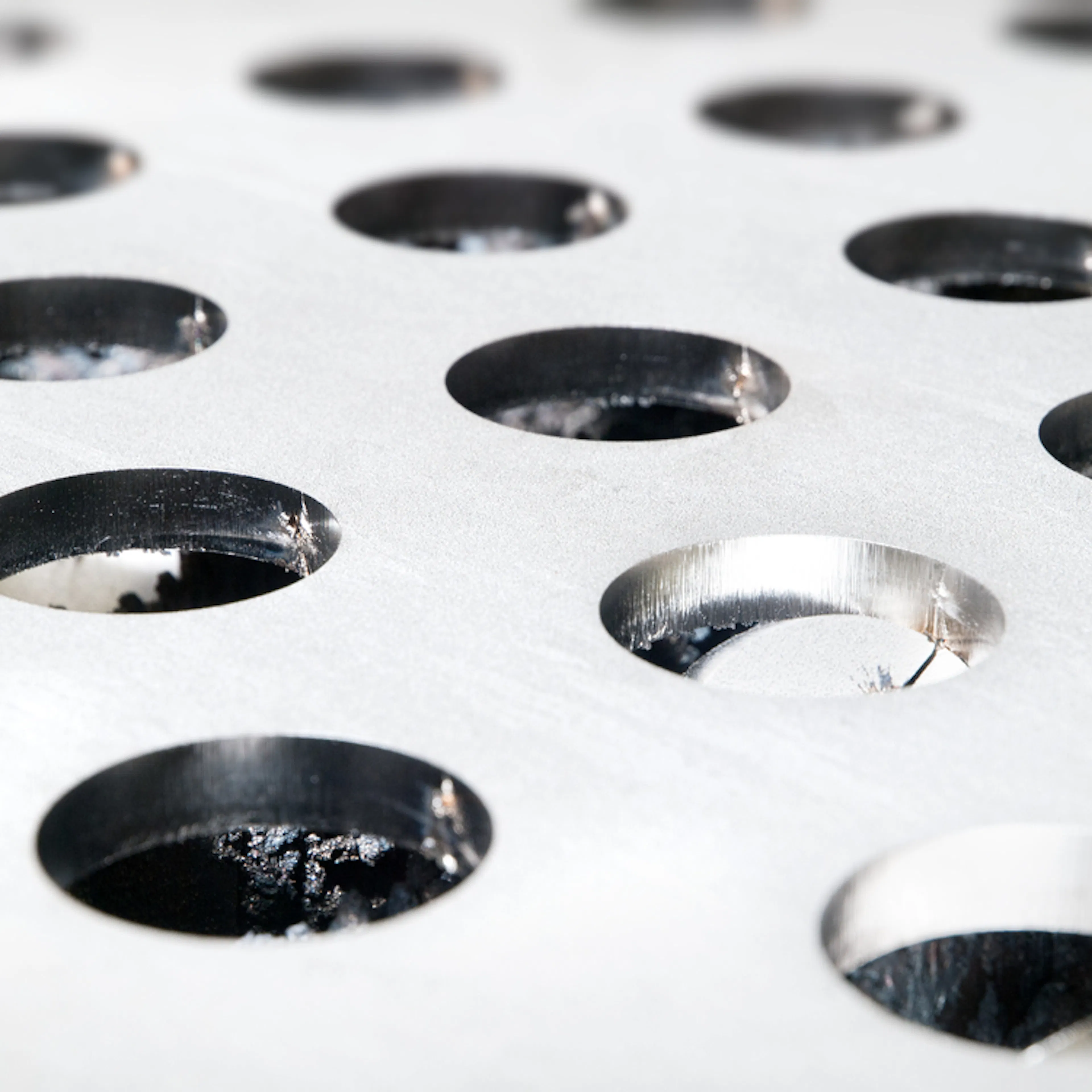

Laser cutting aluminum uses a tightly focused and collimated beam of light radiation to heat and melt a small spot on the surface of the material, with minimal vaporization. This melted material is then blown away with a gas stream, exposing deeper material, which is similarly removed. By this means, a path is cut as the laser advances through the depth of the cut and progresses along the line of the cut, to extract a CAD-designed component from a flat or formed sheet, an extruded section, or a tube, depending on the need.

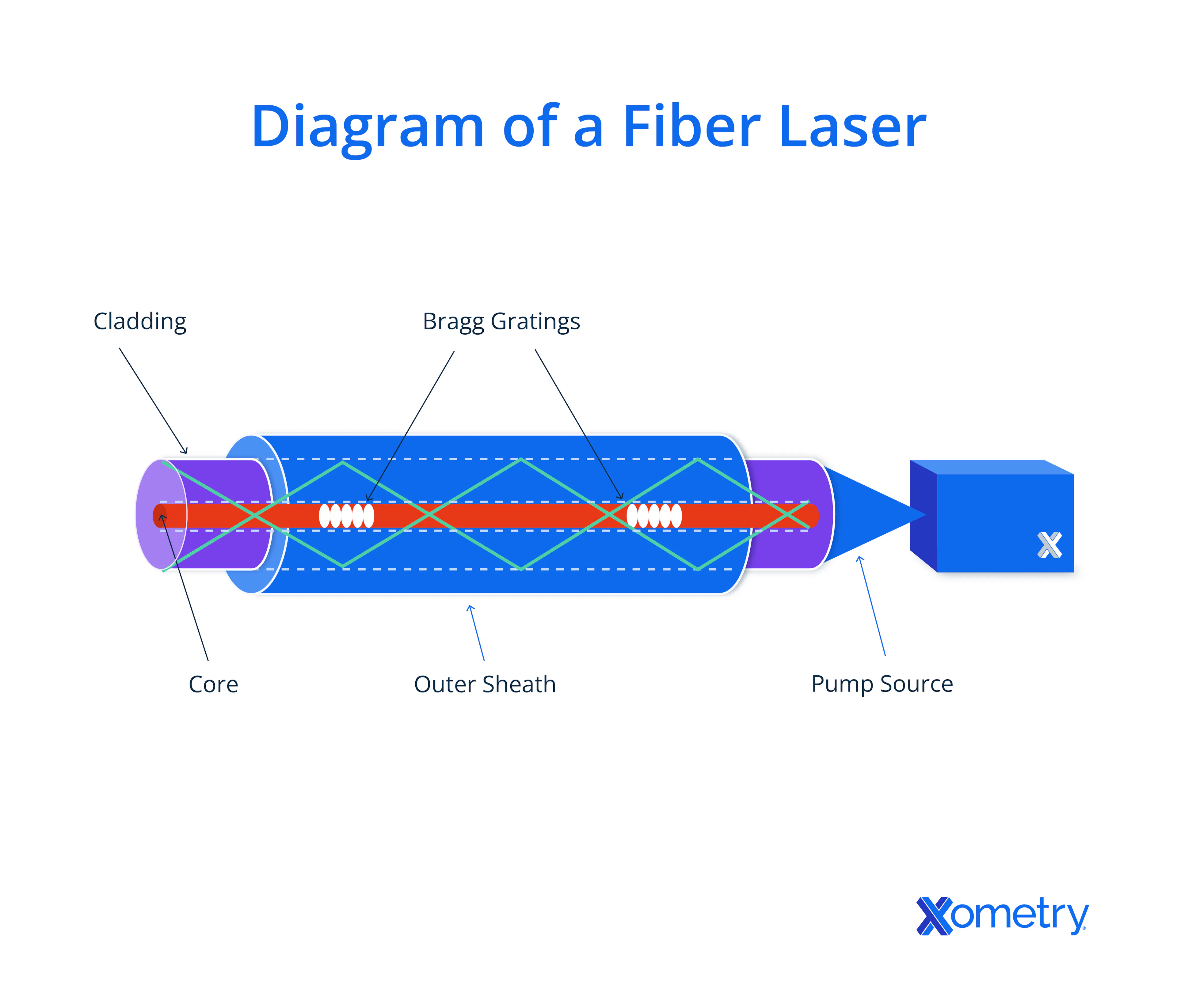

Aluminum can be cut using several types of lasers, with fiber and CO₂ systems being the most commonly used. Both of these types offer specific advantages and are suitable for different applications and thickness ranges. Fiber lasers use solid-state laser diodes to generate the beam, which is then transmitted via optical fibers to the cutting head. They are known for their high power density, excellent beam quality, and elevated energy efficiency. Fiber lasers are effective for aluminum cutting in the range of 0.5 to 15 mm, with specialized high-power systems capable of cutting up to around 25 mm. As such, fiber lasers represent key equipment in the precise and fast cutting of aluminum for applications in automotive, aerospace, electronics, and signage usage, among others.

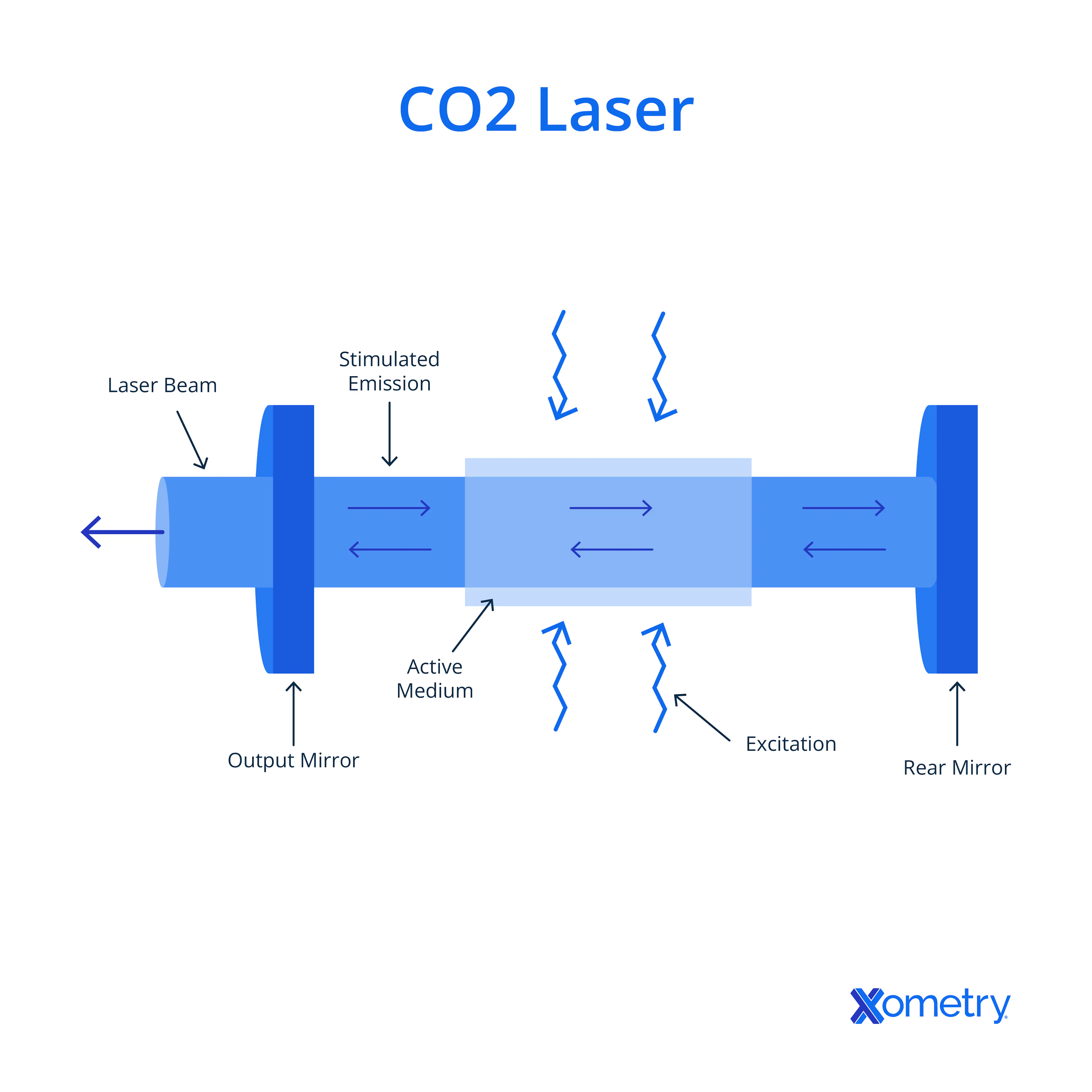

CO₂ lasers use a gas mixture of carbon dioxide, nitrogen, and helium, excited by electrical discharge to produce laser light. They are relatively economical to buy and suitable for a wide range of materials, including aluminum. This is despite the strong reflection characteristic of aluminum that coincides with the laser emission frequency. CO₂ lasers can cut thicker aluminum (above 6 mm), but their effectiveness is limited by aluminum's high reflectivity at CO₂ wavelengths (10.6 µm), often requiring special optics or coatings and higher power levels.

  6. Laser cutting can leave surface discoloration or oxidation, especially when using oxygen as the assist gas. Nitrogen helps prevent this.
