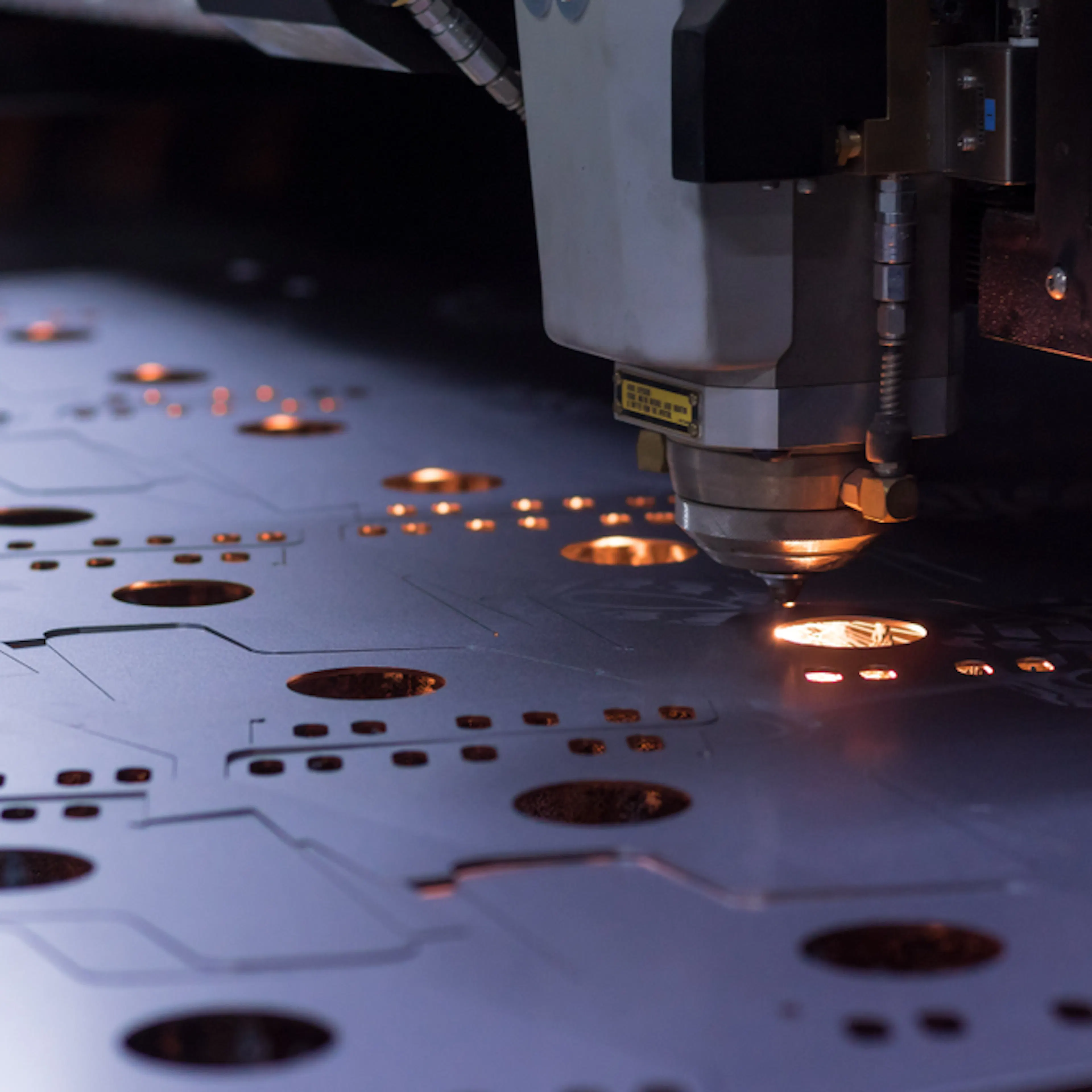

Laser cutting machine. Image Credit: Shutterstock.com/Denys90
