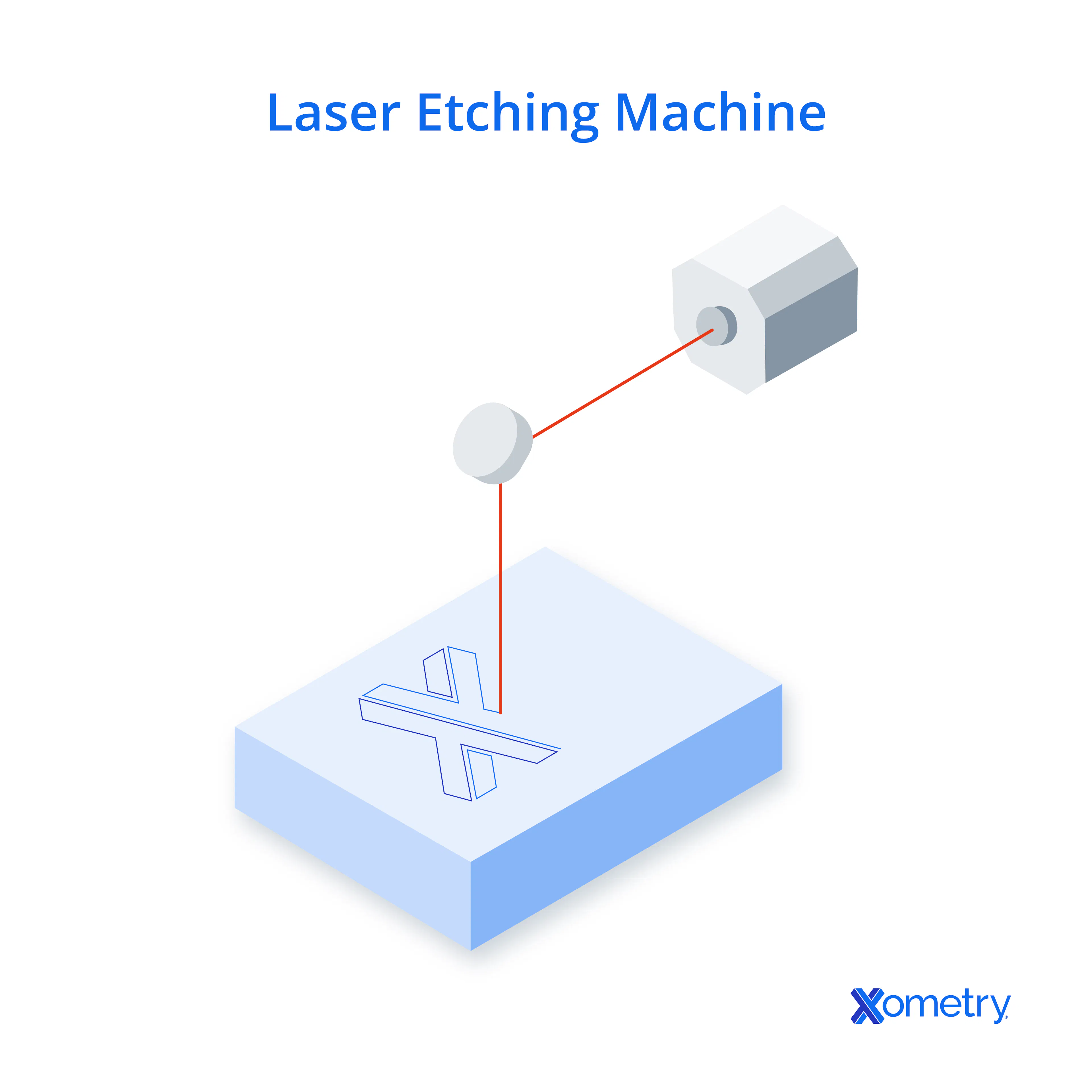

What is Laser Etching?
Similarly, laser etching also removes material to make the markings, but instead of vaporizing it, the workpiece is melted where necessary. The laser causes the material to expand at the point of focus, and this leaves a raised mark that can be seen and felt with your fingers. It doesn’t go as deep as to cut the workpiece, but just enough to mark it. Below is a diagram of how this process works.
How laser etching works
In addition, laser etching has fewer power requirements and less energy density than laser engraving (melting is a lot more cost-effective than vaporizing, in both high and low production volumes), and is also a lot quicker. Here’s a picture of laser-engraved parts made by the Xometry team.
