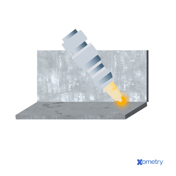

What is Laser Welding?
Laser welding is an efficient and quite gentle method that joins metal parts with a high-intensity light beam that causes the materials to melt and fuse together when cool and dry. The equipment used is either a large stationary machine or a hand-held torch, similar to stick welding. The process is easy to automate and delivers high-volume production and consistent quality that you could only really achieve with spot welding via other methods. Sometimes a metal filler is used for extra bonding power, but this isn’t always necessary. The laser welding beam is typically generated by a solid-state, fiber, or CO2 laser, each of which has its own advantages over the other (we’ll talk more about this a little further down).
At the beam’s focus point, the metal reaches its melting point and forms a localized pool, into which the filler rod can be melted as required. The laser beam is then moved along the surface of the joint. This melts a leading edge and leaves the molten, fused trailing edge of the pool to cool and solidify. In a successful weld, the cooled metal attaches to both parts to a roughly equal degree and remains free of oxidation. The process’s standout feature is by far its accuracy. If you have a tiny spot to weld, you can get to it easily without affecting the surrounding material, or causing any damage to the workpiece.
Laser welding in action

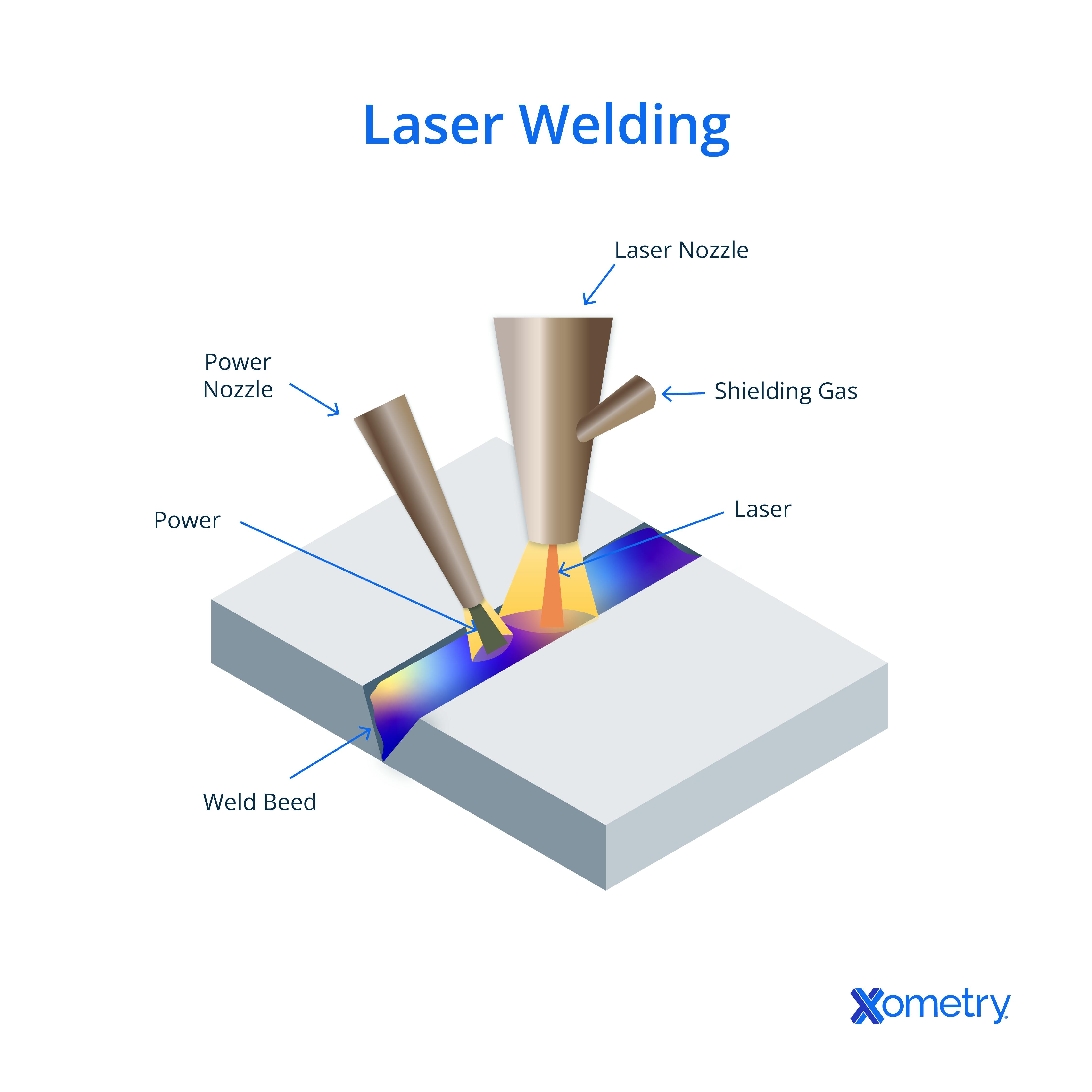

What Is the Process of Laser Welding?
These are the generic steps in the laser welding process:
  1. Clean the parts you need to weld and position them as accurately as possible. The line where they meet should be totally closed without any gaps.
  2. Use manual clamps or automated fixtures to hold parts in place and keep them stable during the welding process.
  3. Adjust the beam’s focal point onto the welding area. The optical gear in the welding torch usually provides for easy adjustment of focus.
  4. Adjust the power of the beam and test it on some scrap material. Before moving to the workpiece, make sure it is putting out sufficient energy to melt the material but not enough to excessively heat parts.
  5. Aim the beam at the start of your weld area and once you’ve got a good melt going, traverse it along the connection steadily. Traditional welding techniques such as hot point rotation will encourage good fusion and improve weld quality.
  6. Cool the part naturally once the welding is complete. You can also quench it in water or use other cooling methods.
Laser welding diagram
The laser welding process
