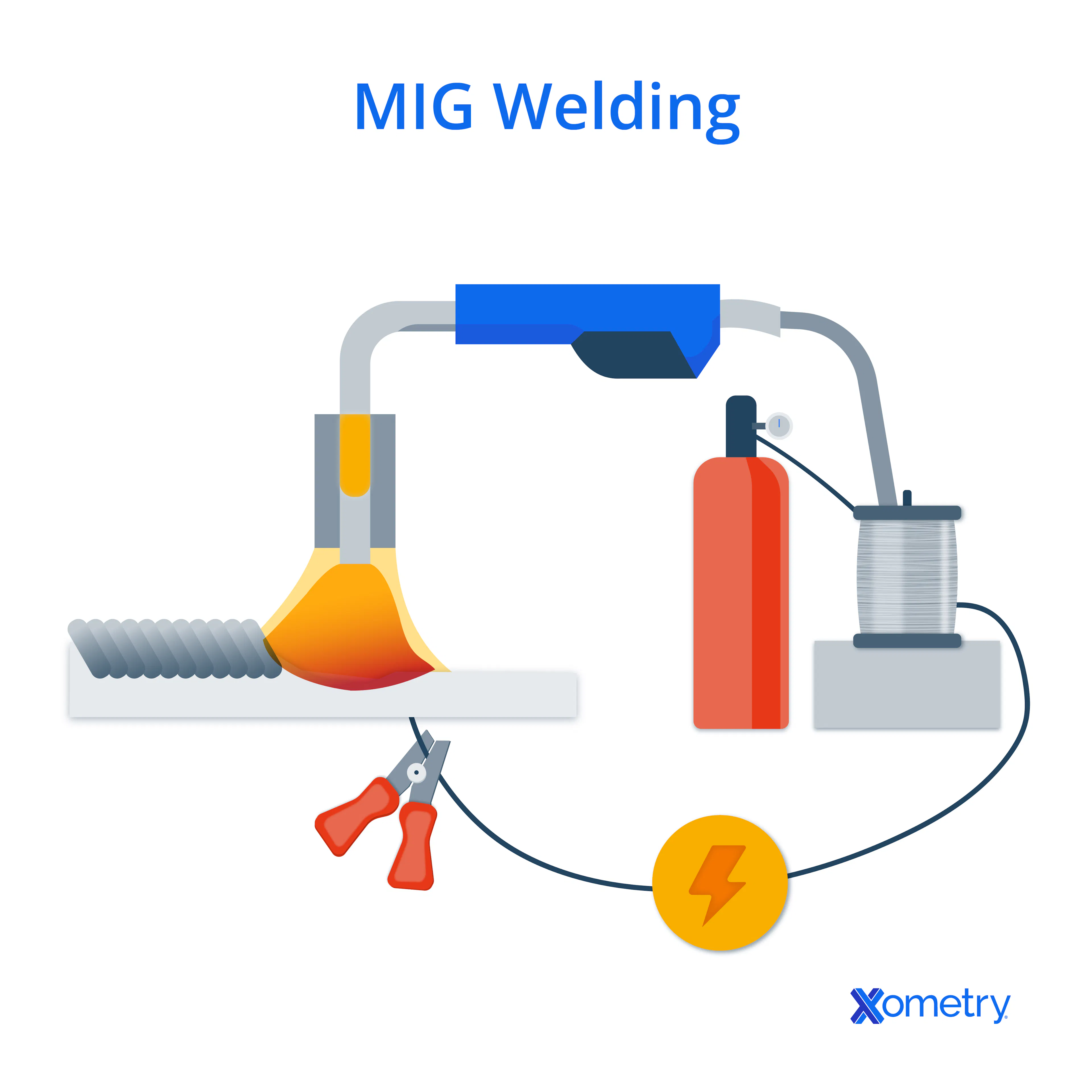

How Does MIG Welding Work?
MIG welding works by feeding a metal wire through a gun which conducts electricity from the welding machine. It generates an arc with the target material in order to melt both the metal wire and part of the joint and form a metal bond. As the wire is fed through and a molten weld pool is created, the weld is protected by a shielding gas. The shielding gas protects the weld from contaminants in the atmosphere.
