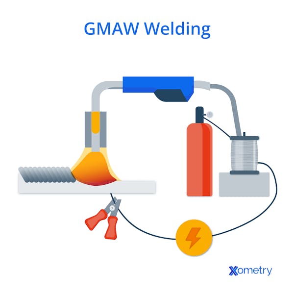

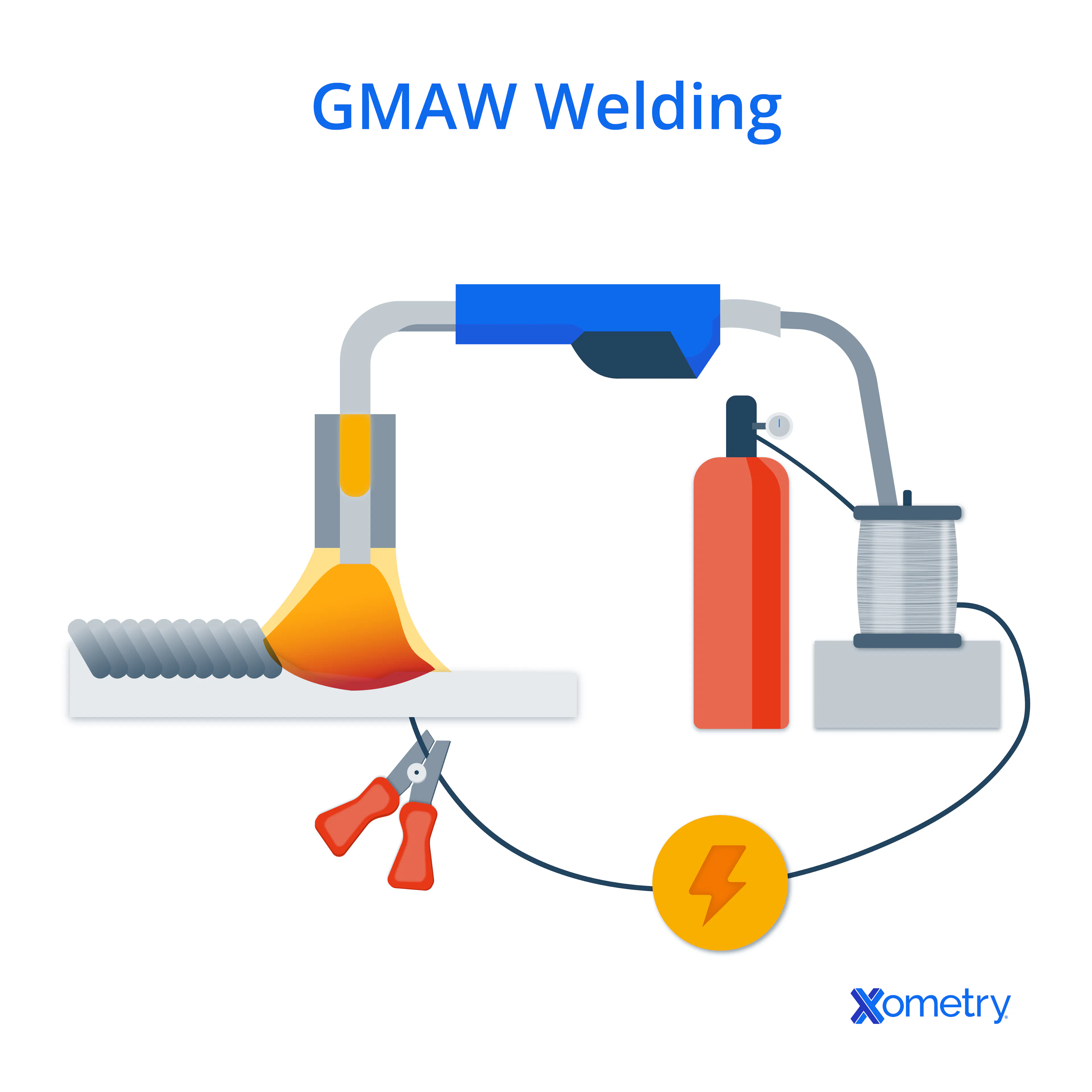

Gas metal arc welding (GMAW) is a semi-automated process that uses a continuous wire electrode and shielding gas. It is widely used in industries such as automotive, aerospace, and manufacturing for welding steel, aluminum, and other metals. GMAW is favored for its speed, efficiency, and clean welds. Figure 1 below is an example of gas metal arc welding:
An illustration of GMAW welding
How Does Gas Metal Arc Welding (GMAW) Work?
GMAW works by creating an electric arc between the part and a continuous wire electrode. The electrode, which is fed through a welding gun, melts and combines with the workpiece to form a weld. A shielding gas, such as argon or a mixture of argon and carbon dioxide, is used to protect the weld zone from atmospheric contamination. The shielding gas also helps stabilize the arc and control the welding process.
