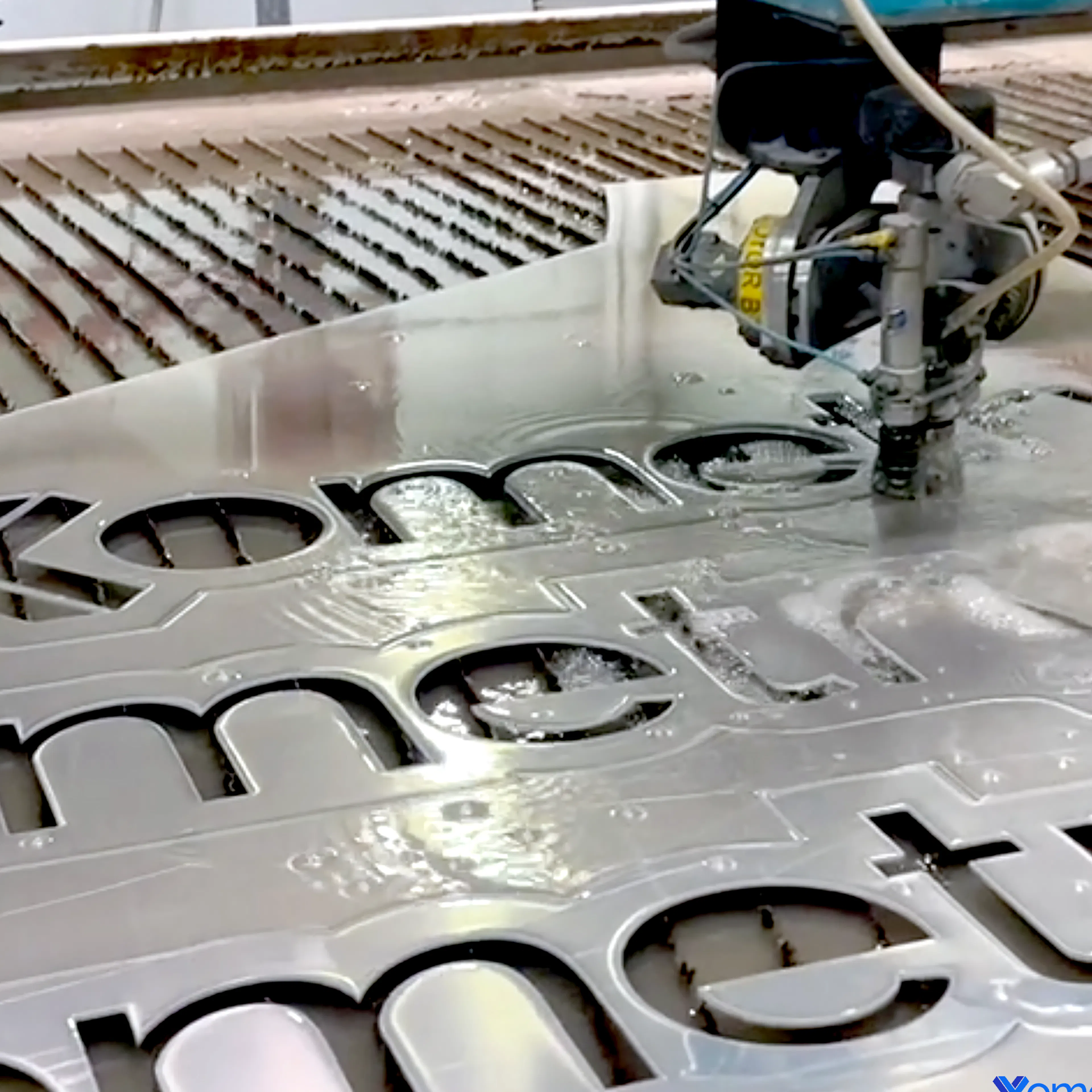

Surface finishing is critical when your parts are visible or cosmetic rather than deep inside an assembly. Parts fresh off the waterjet or laser often have a burr on their bottom face, marks from handling, frosting near the cut line from overspray, and vestigial tabs from being held in place during cutting. Applying a finishing process to parts post-cutting will help you get parts that need minimal cleanup before installation.

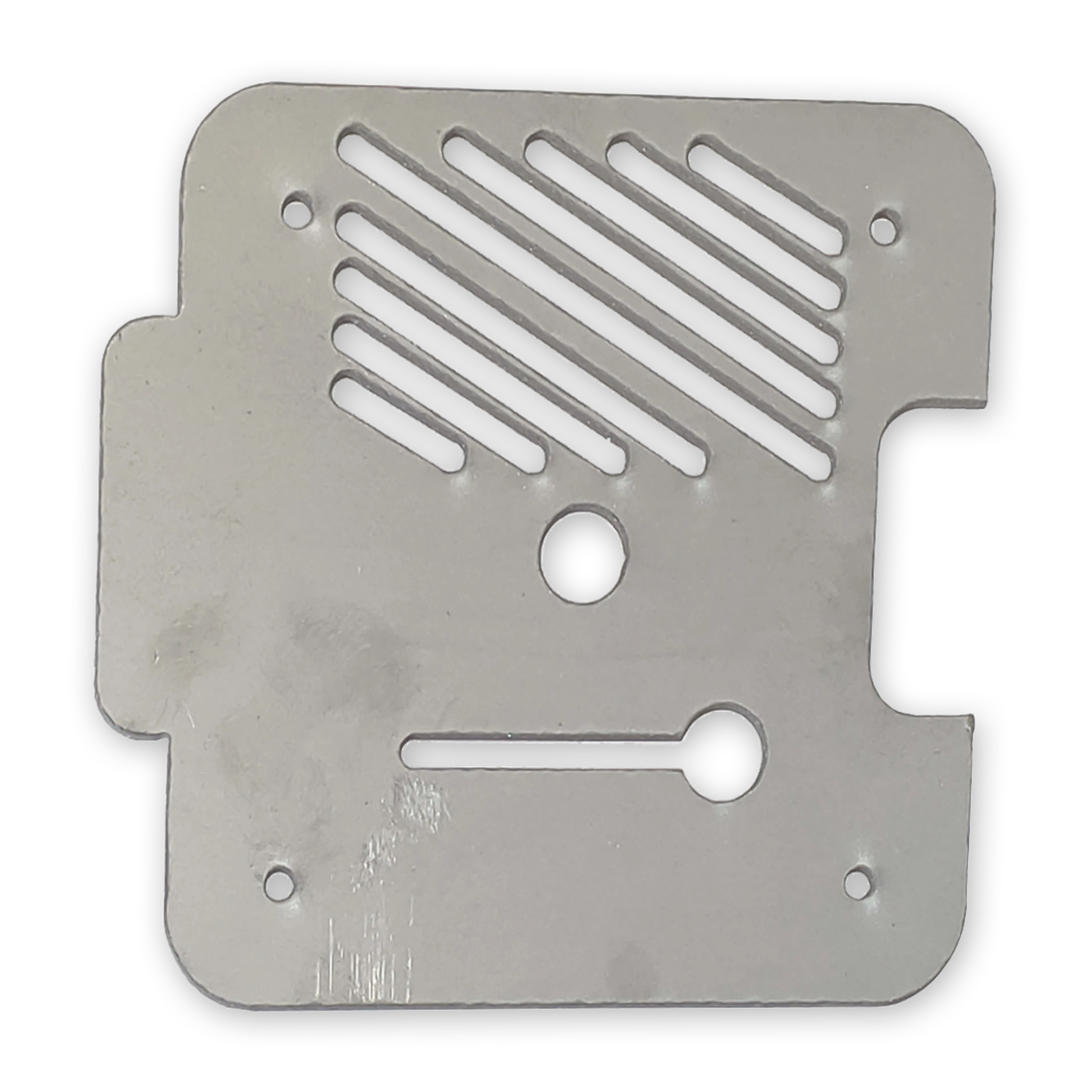

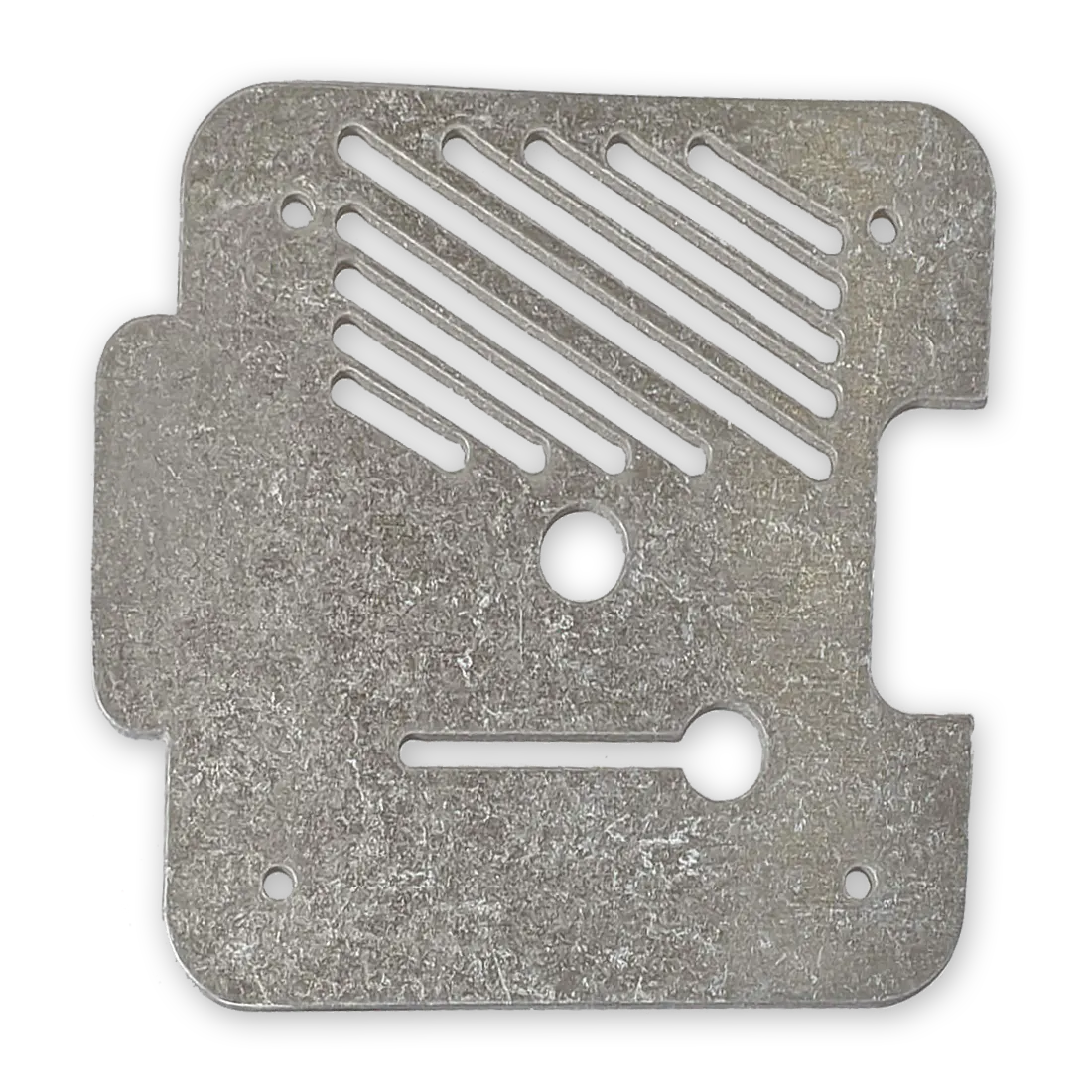

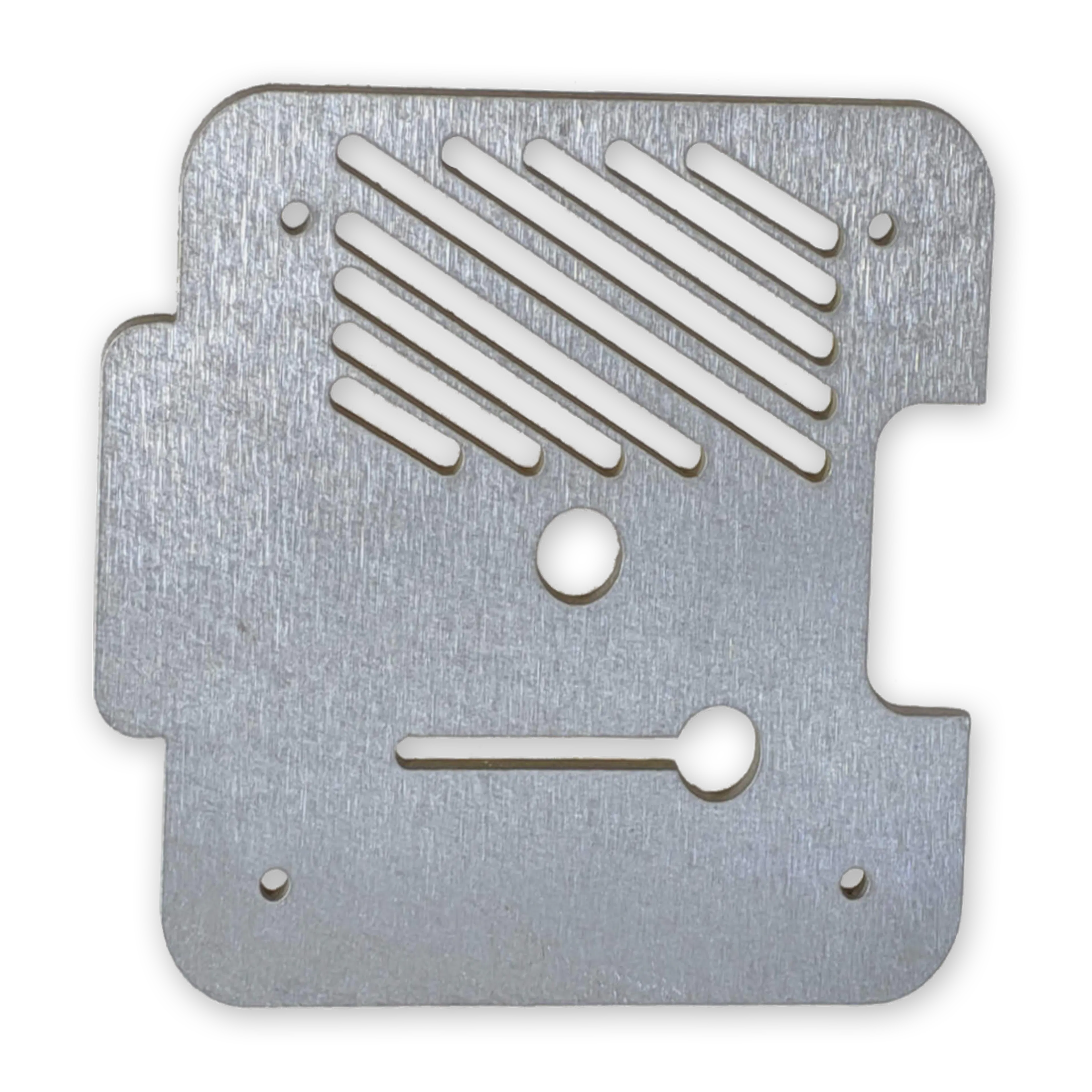

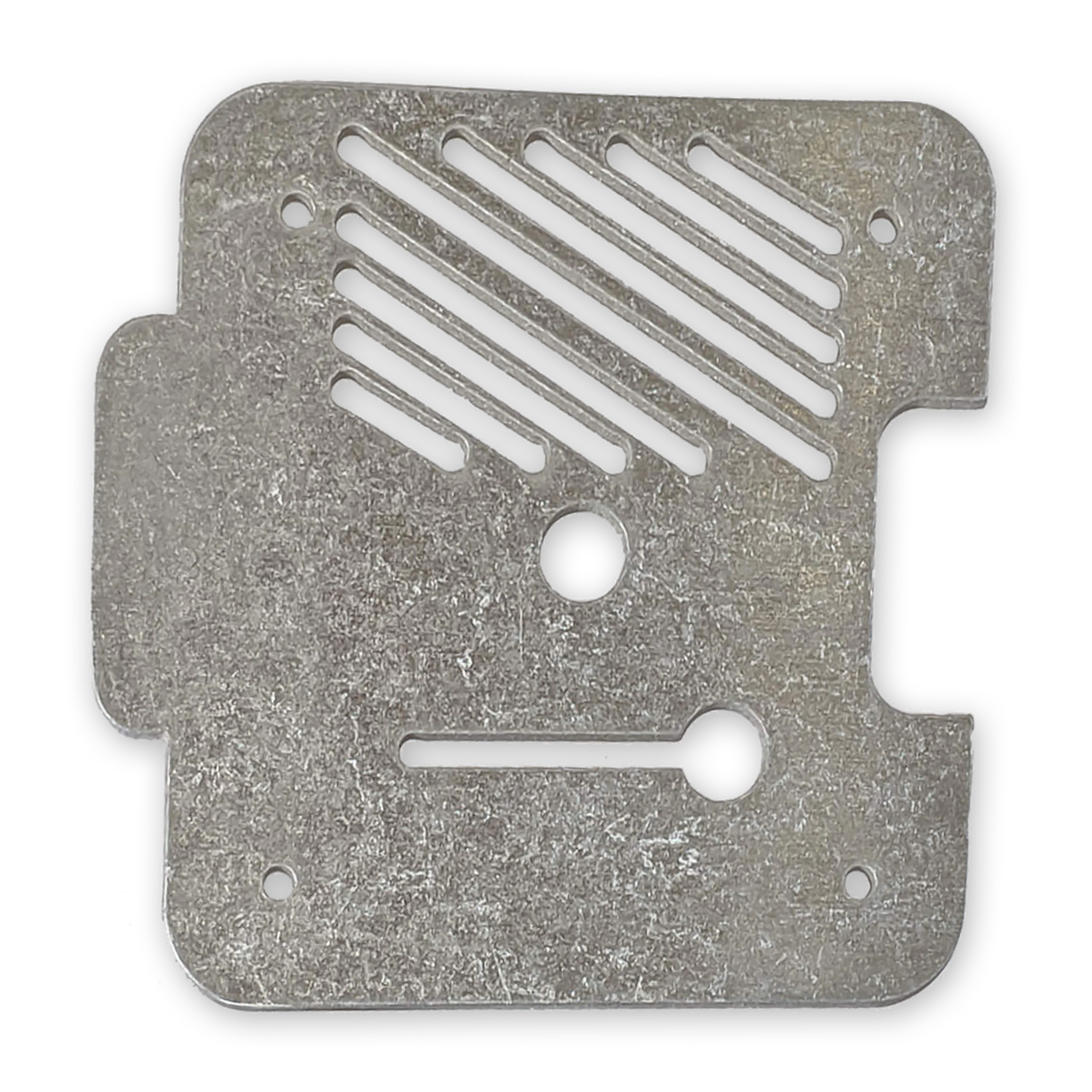

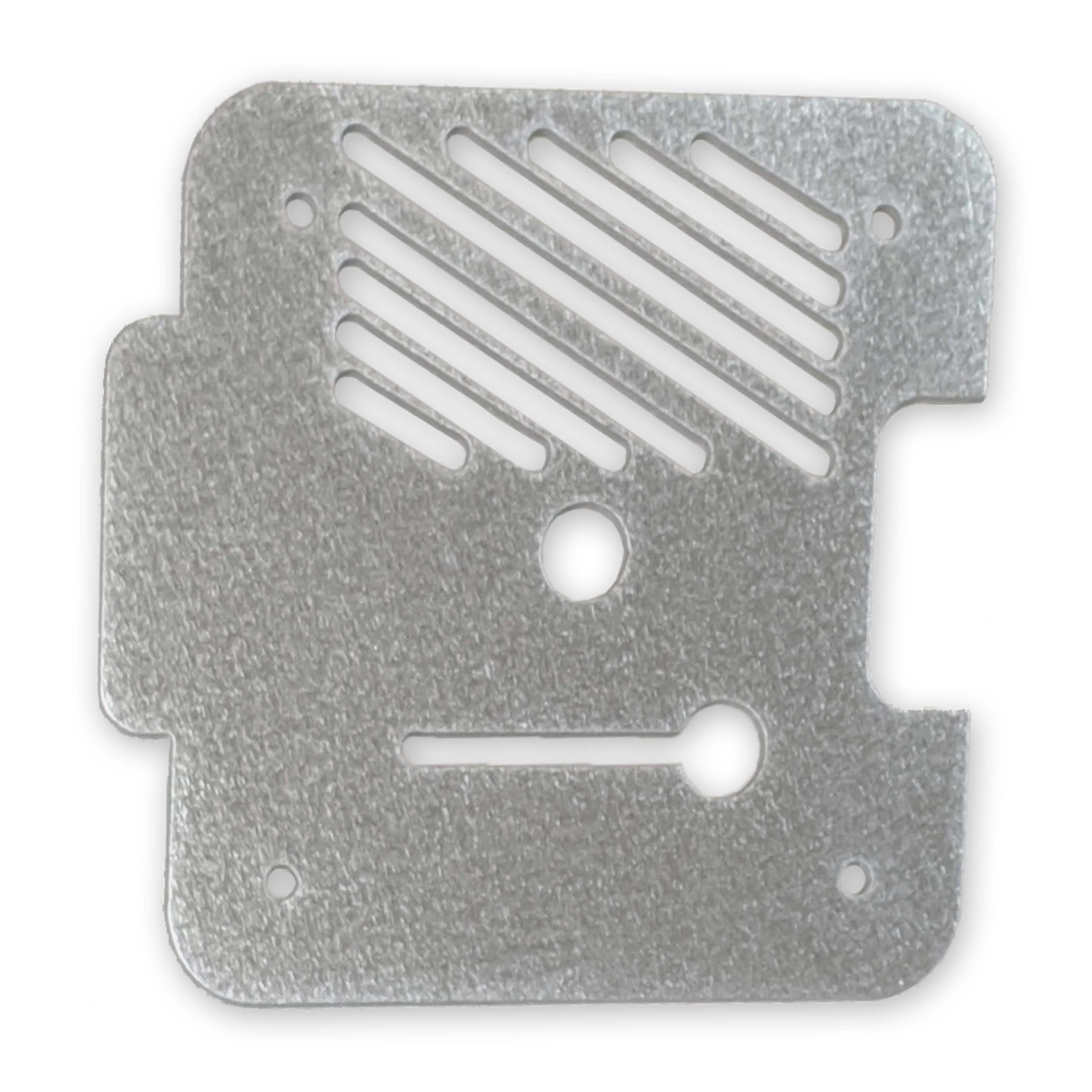

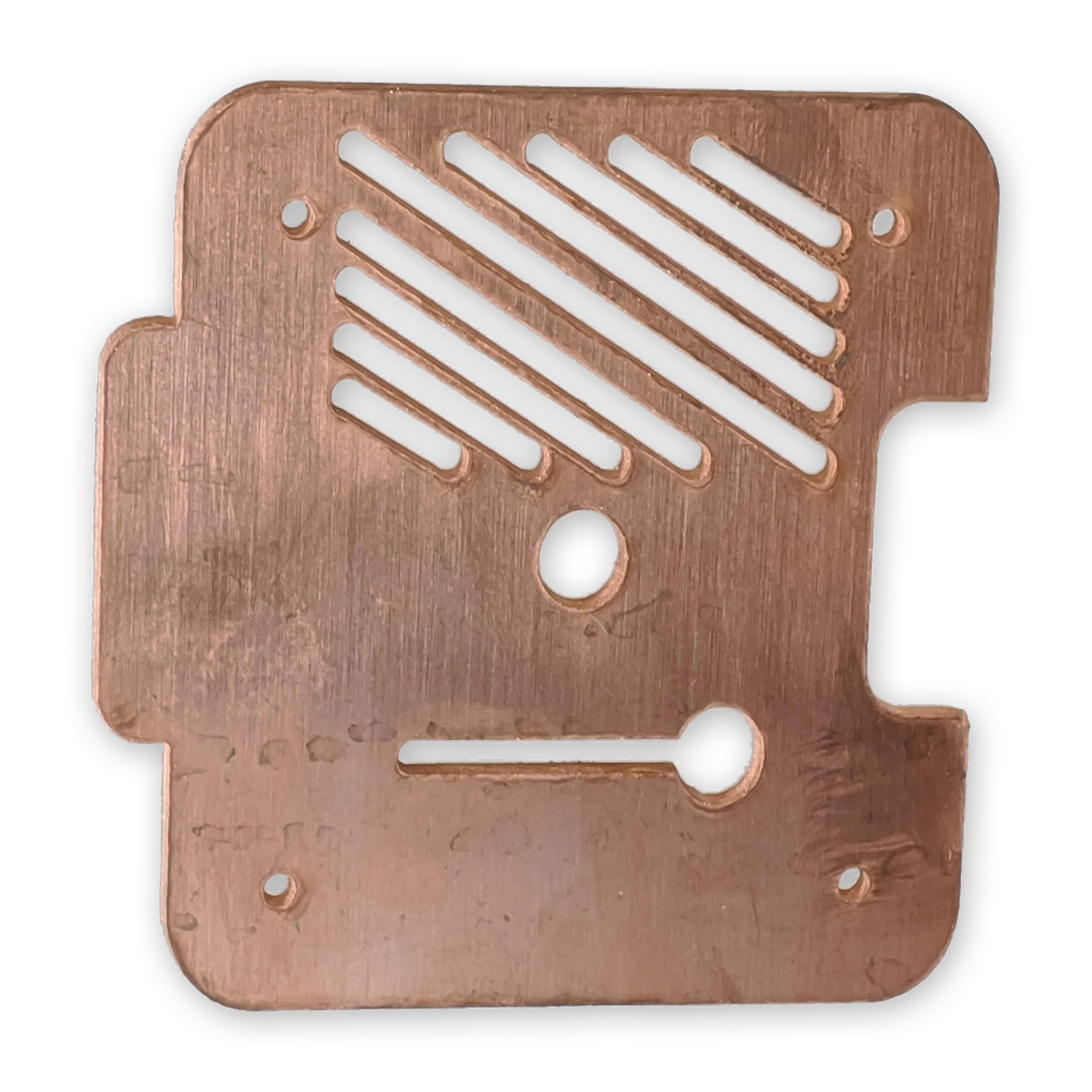

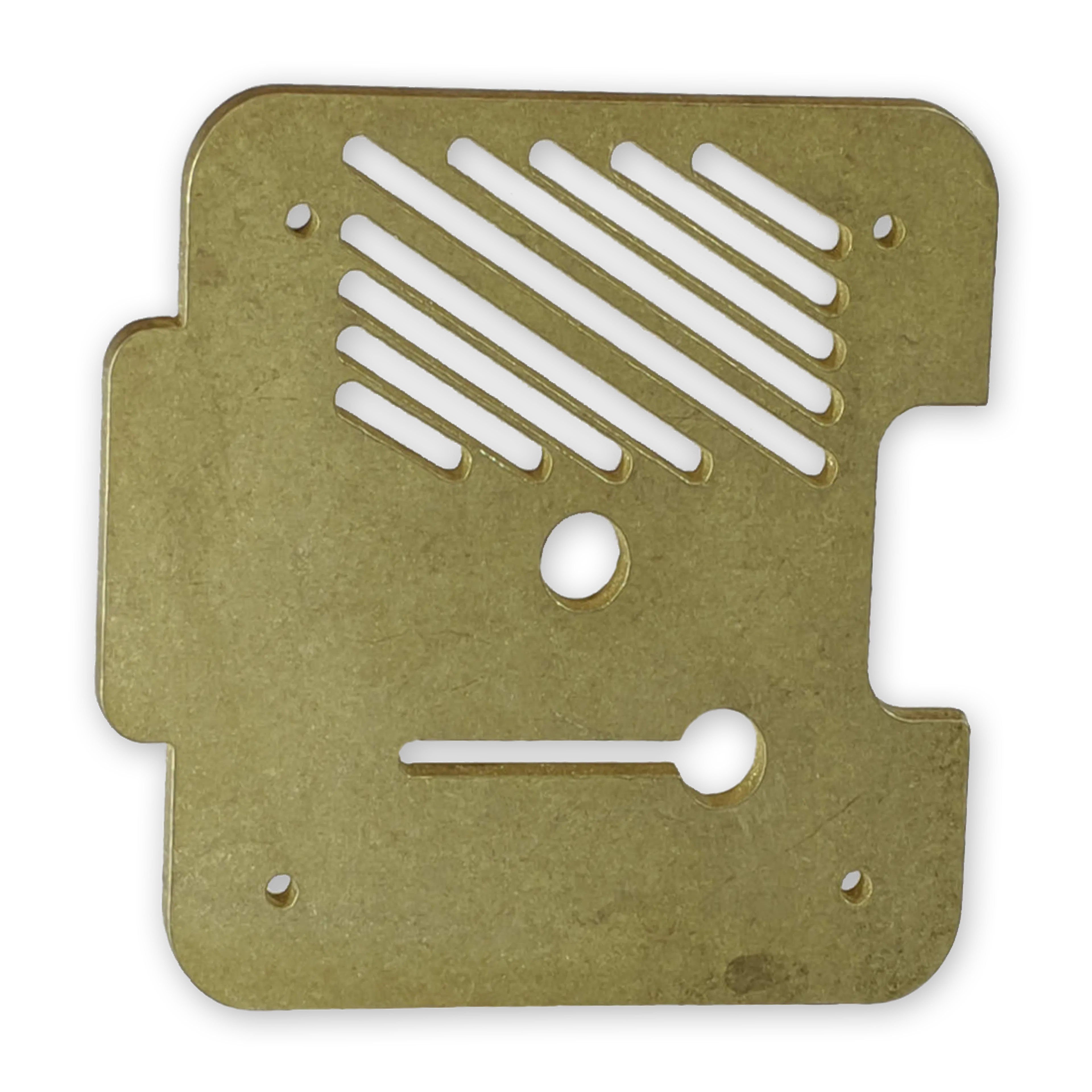

As-Cut Surface Finishes

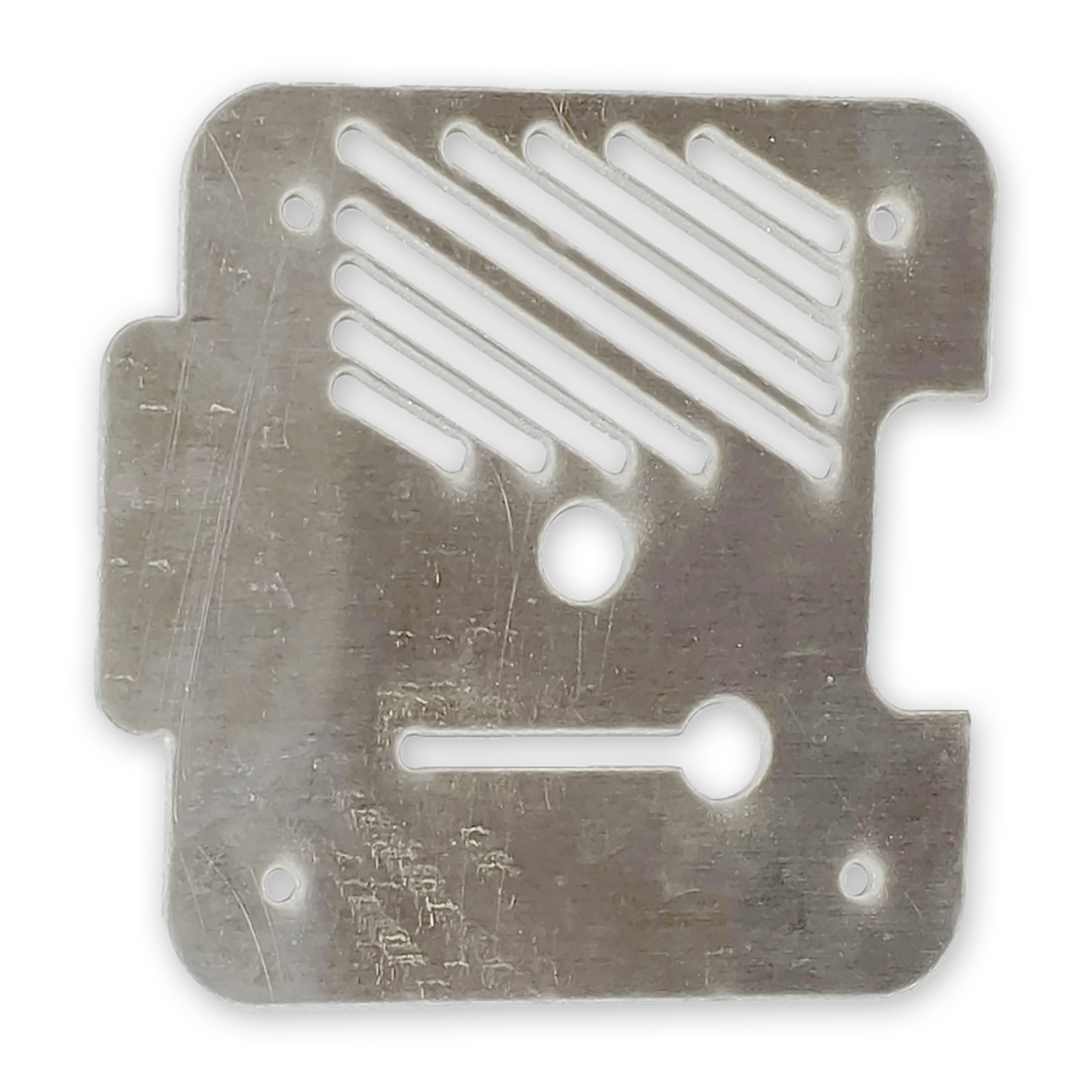

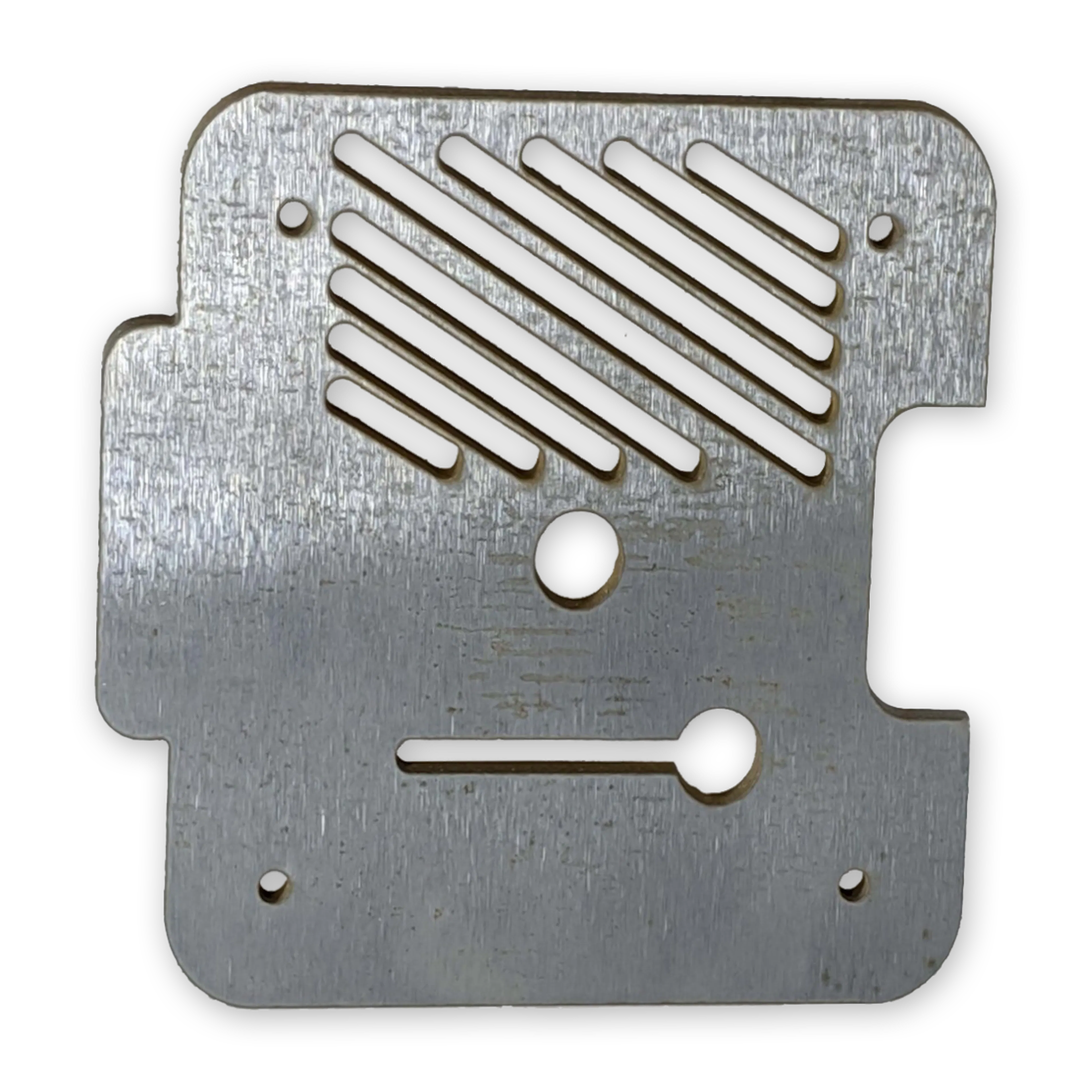

This process is the most common option for parts that will not be seen or handled, or if you will be applying your finish once you receive the parts from Xometry. As-cut flat sheet cut parts may not have a consistent cosmetic appearance. For example, overspray from the waterjet near the cut line, especially at pierce points and on the bottom face, may show a visible halo. There may be minor marks from handling on the top and bottom faces and from exposure to water. Similarly, lasers can discolor metal around the cut edges. Some metals also have mill marks from the manufacturer, which look like printed text.
On smaller parts where one or both dimensions are less than four inches, we have to tab the part to the sheet during cutting to keep them from ending up at the bottom of the waterjet tank. In these instances, we allow the techs to pop them off the sheets or ship you the sheet with the parts still attached. Tabbed parts are shipped still attached if the individual parts are so small they could easily get lost in packaging. If you want your parts to ship separated from the sheet, with the tabs ground down, you will want to select one of the finishing options below or select "Separated with Tabs Removed".

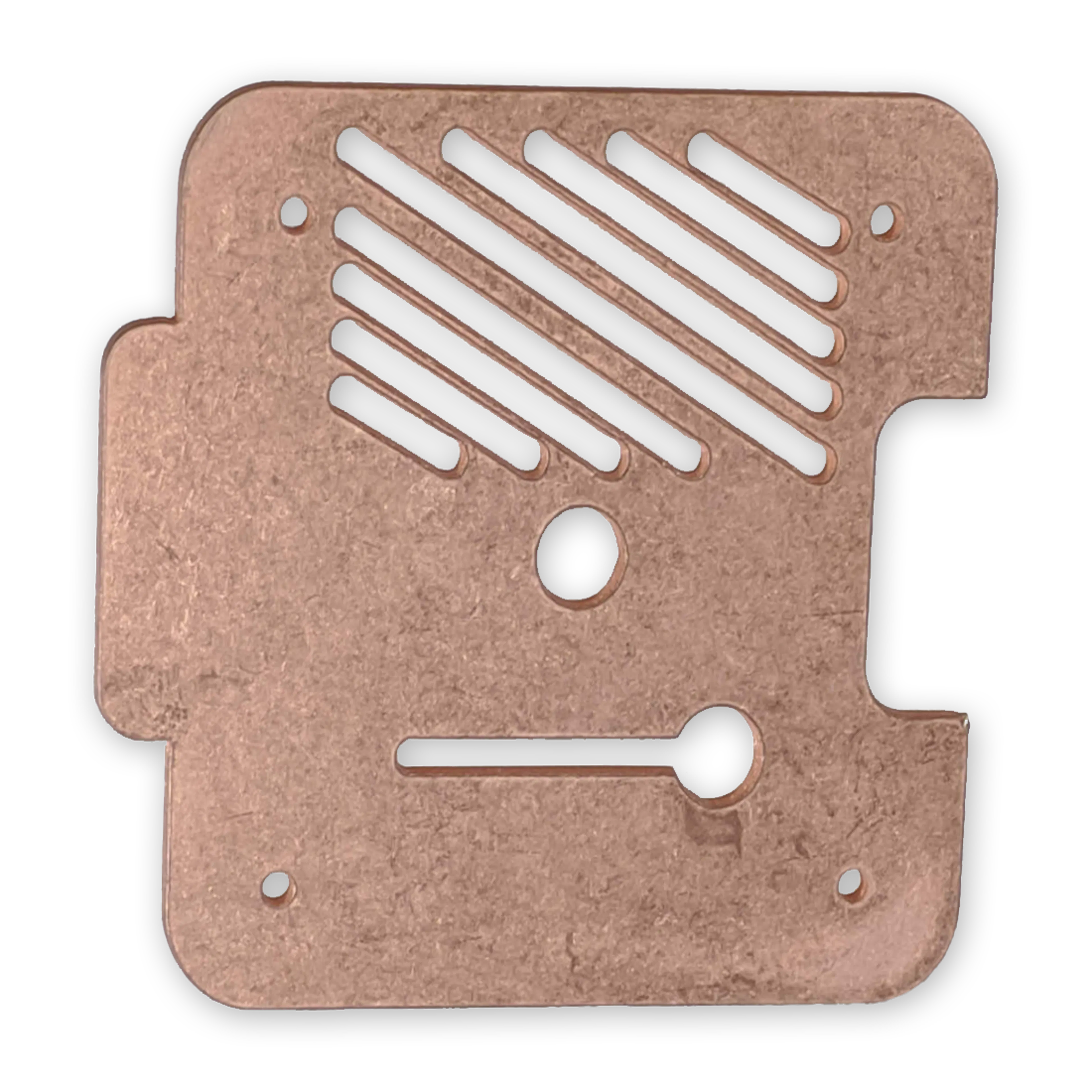

As-cut copper sheet metal.
As-Cut Copper Sheet

As-cut aluminum sheet metal.
As-Cut Aluminum Sheet

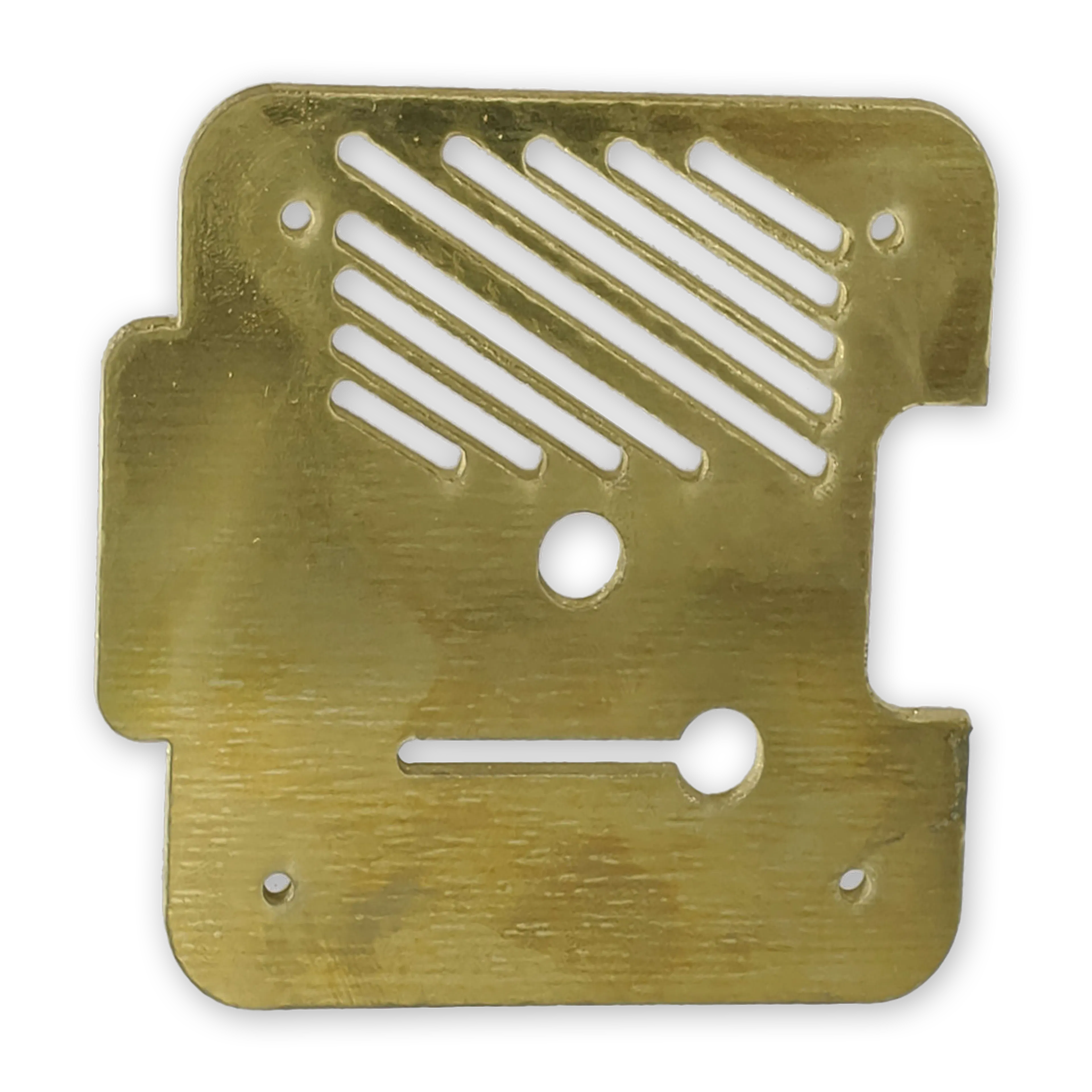

As-Cut Brass Sheet
As-Cut Brass Sheet
As-Cut Low Carbon Steel Sheet Metal

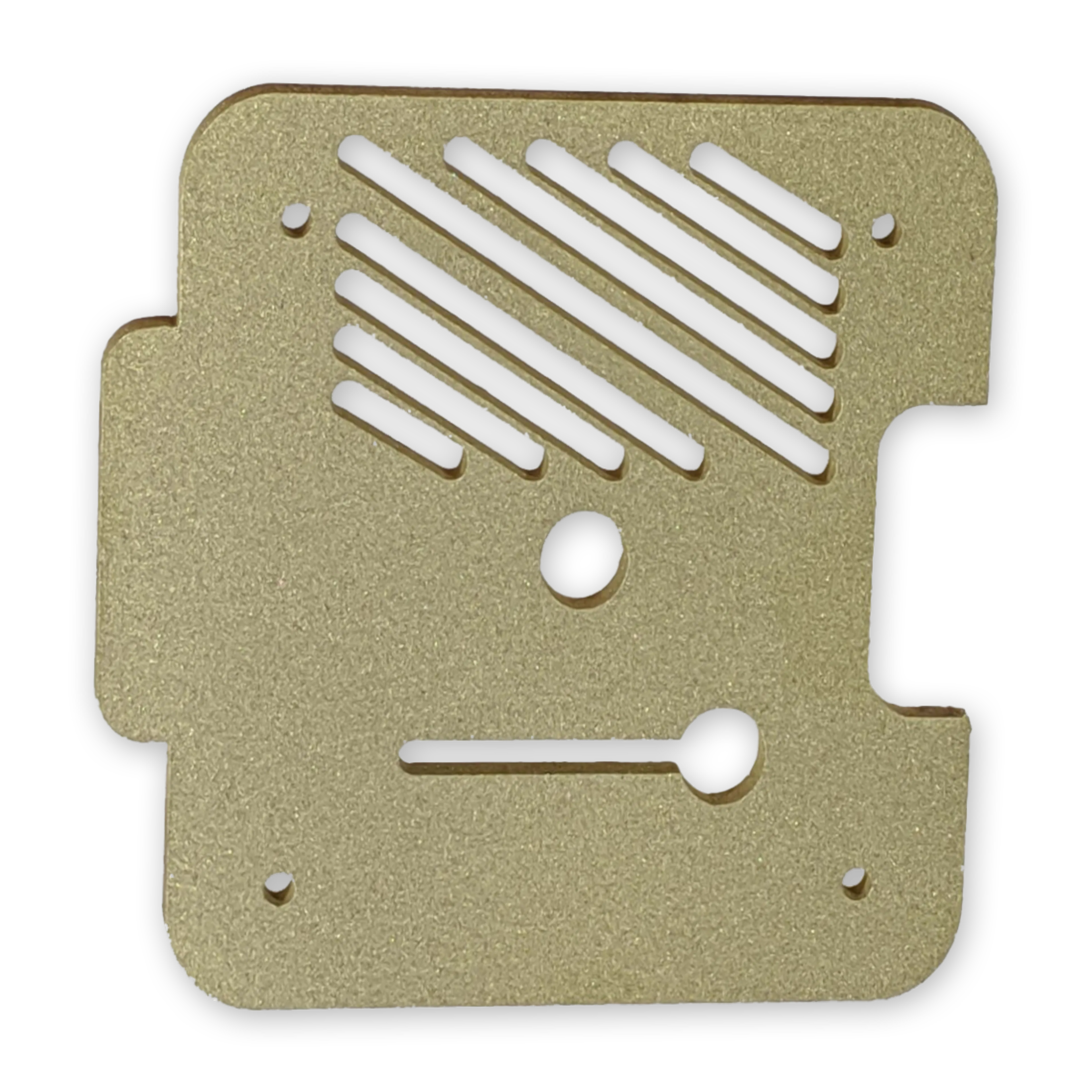

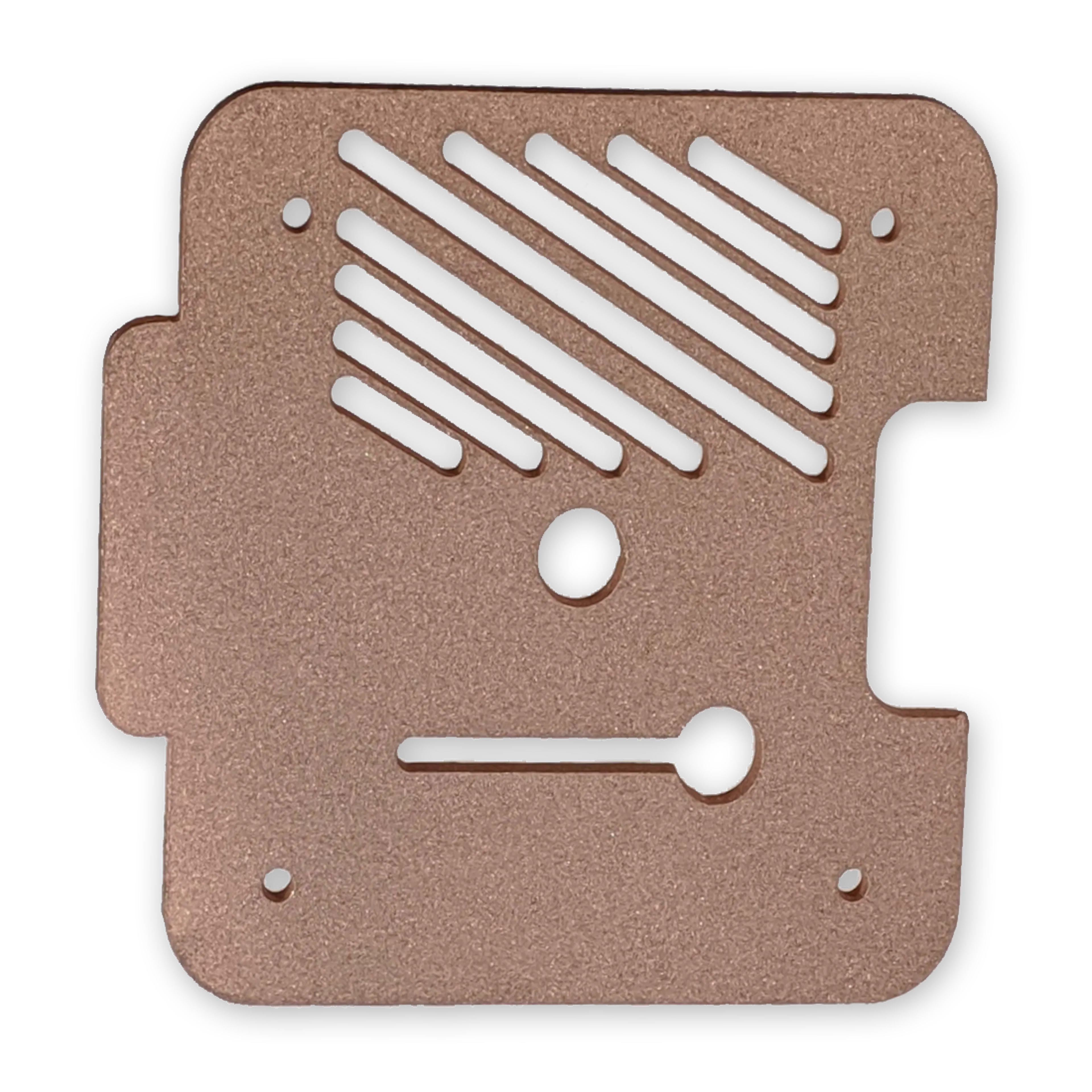

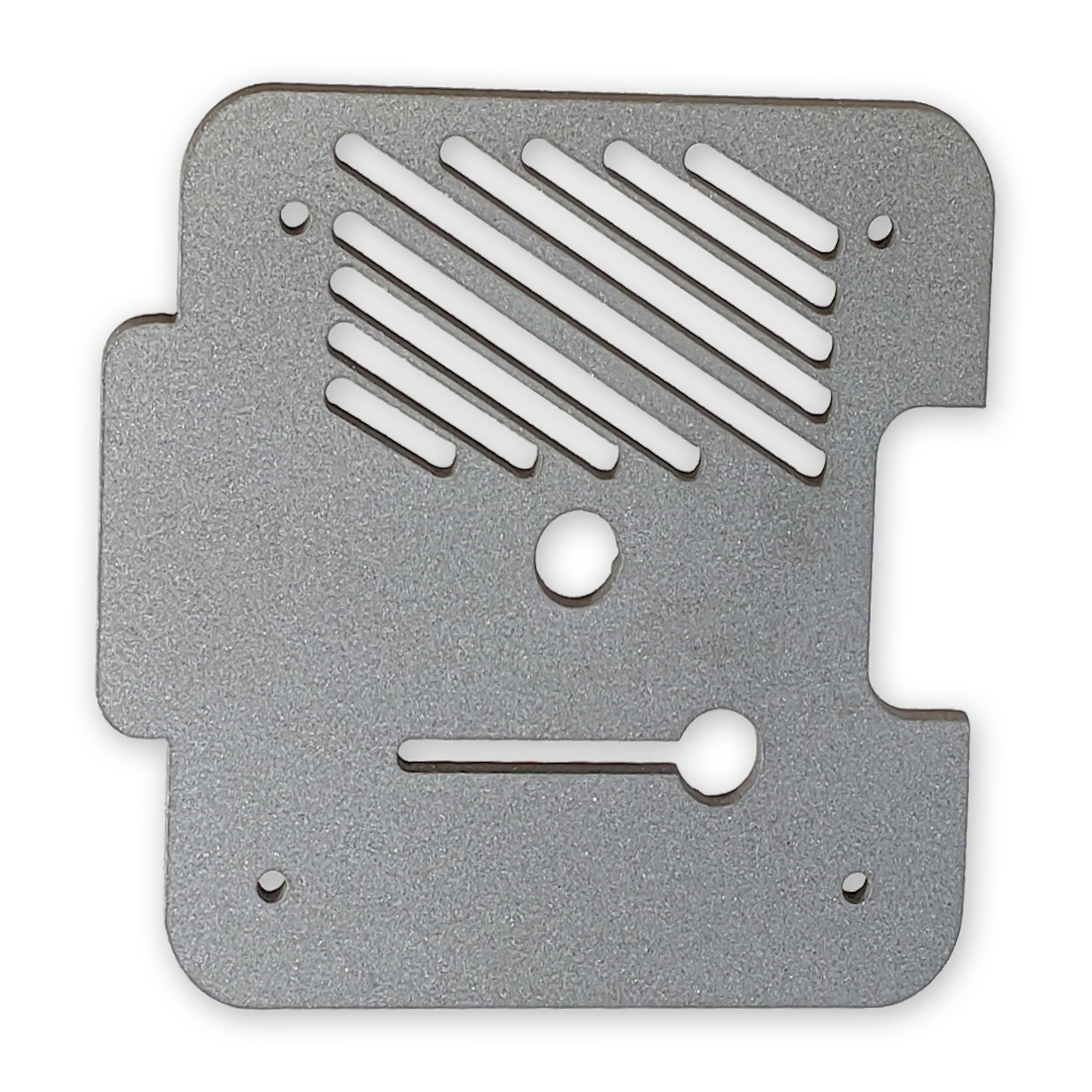

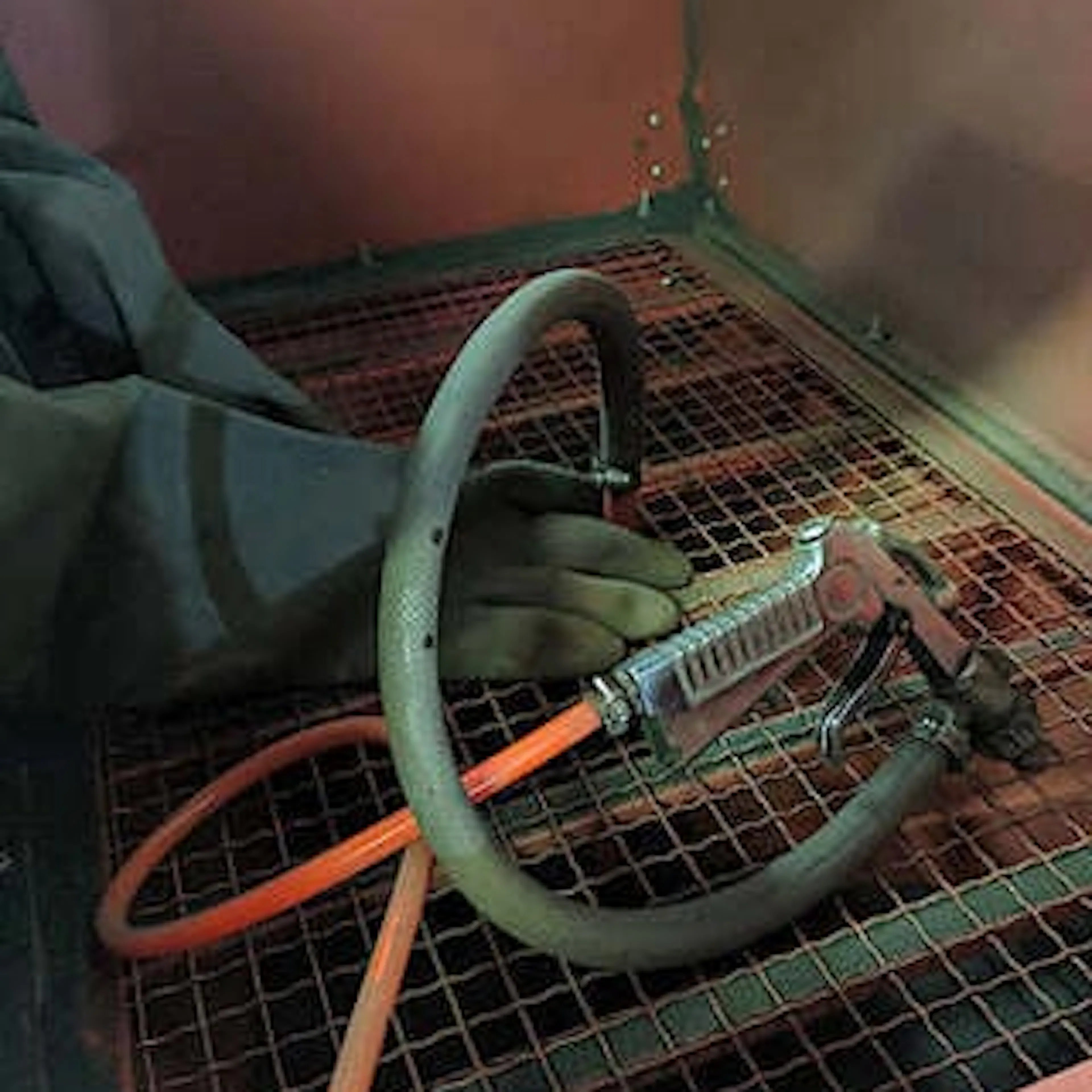

Bead Blast Finish

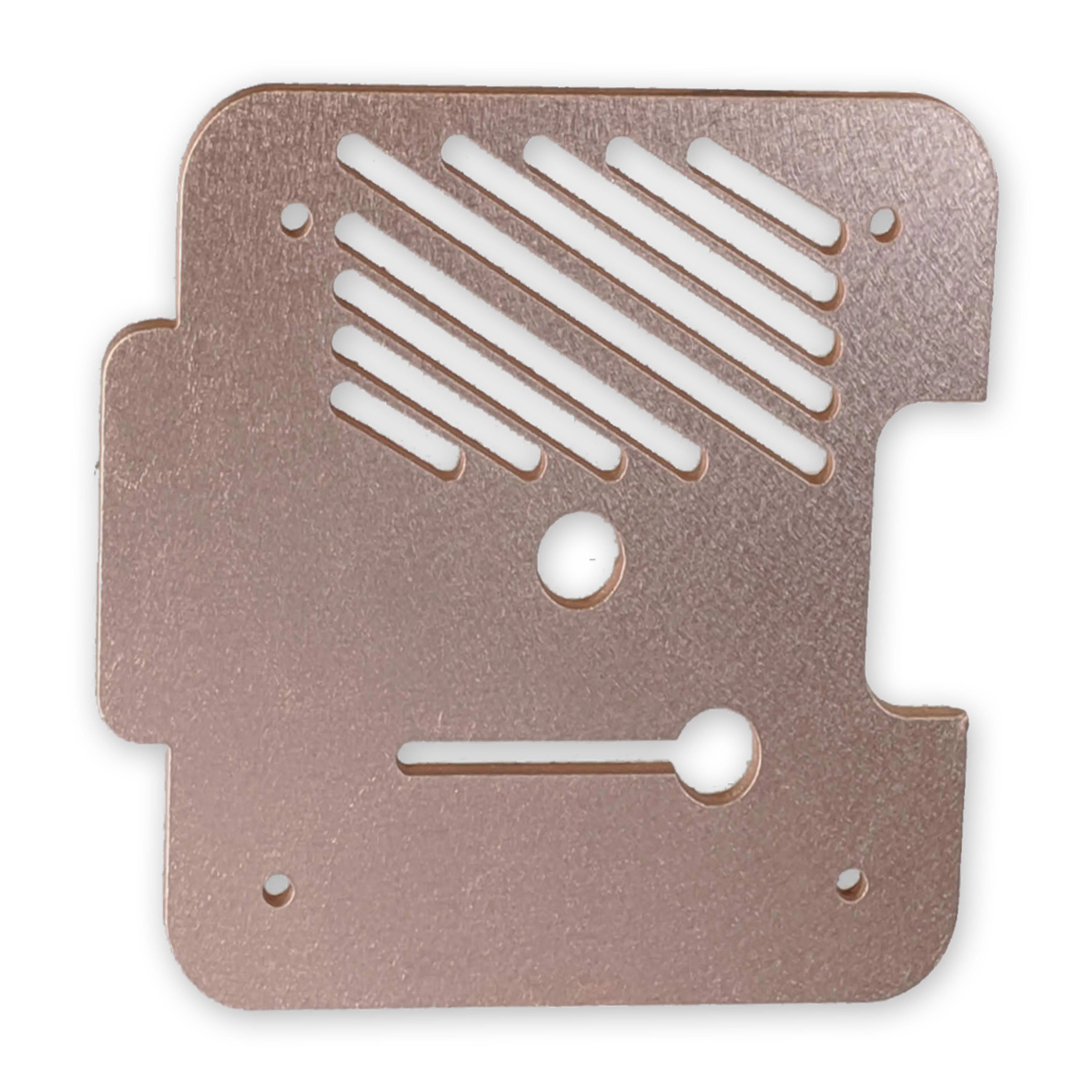

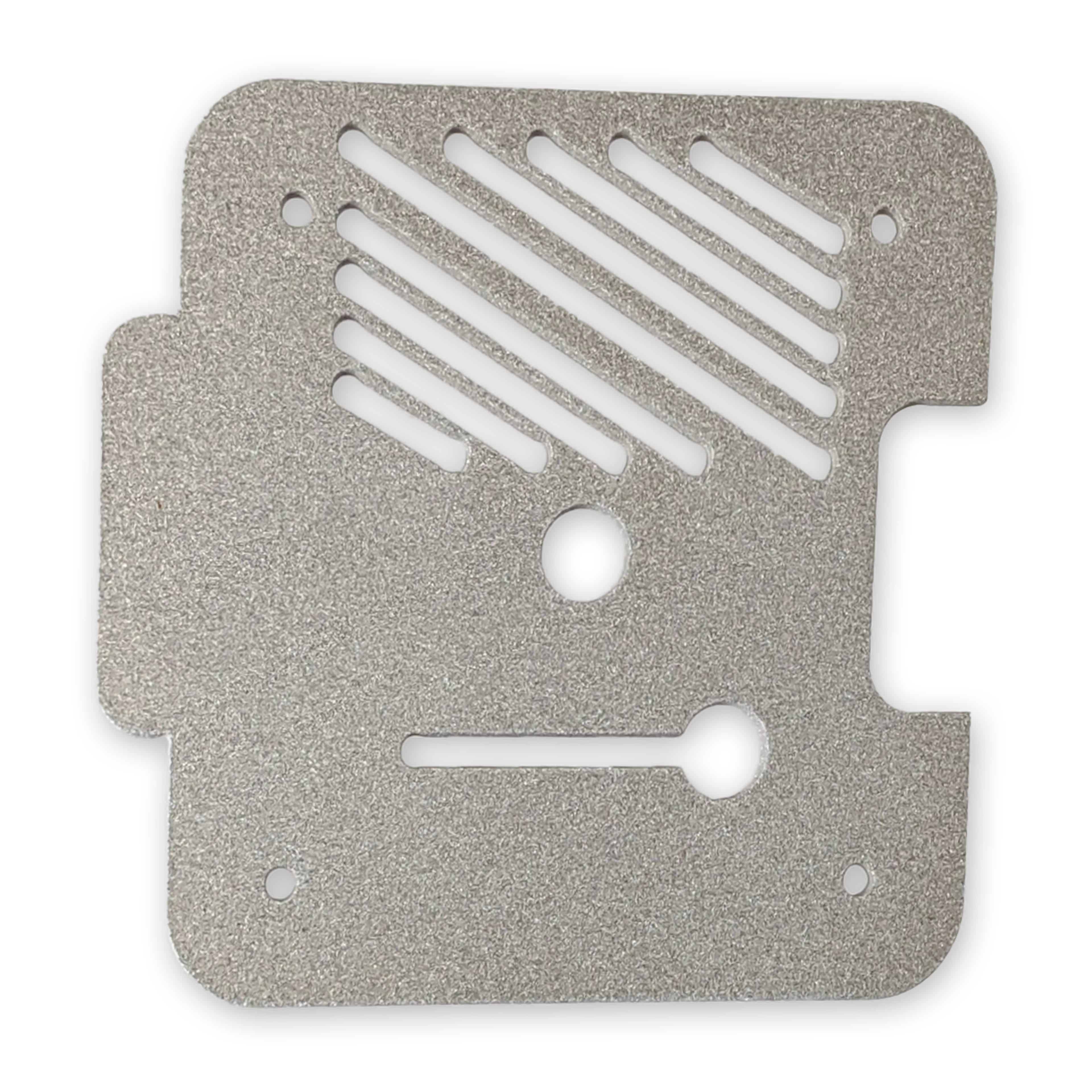

Bead blast finish removes burrs and surface imperfections while providing a fine grain finish across the entire part. We apply this finish by blasting the parts with a high-pressure stream of tiny glass beads. This option is a perfect match for waterjet cutting, as the surface resembles the cut edge produced by the garnet from the waterjet, meaning that the finish on the faces and cut edge are closely matched. Bead blast finish is an excellent option if you plan to paint your parts post cutting as the even "tooth" of the surface allows paint the nooks and crannies it needs to get a good hold of the surface. It is also a great option when looking for a matte finish. Before anodizing, bead blast and other matte finishes are ideal surface preparations, creating a nonreflective matte appearance.
The parts must fit in a blast cabinet to apply the bead blast finish; typically parts less than 24 inches in both height and width should fit. We recommend bead blast for parts over one square inch; any smaller, and the parts will be hard to hold and it will be difficult to apply the finish evenly. Parts given a bead blast finish will be removed from their source sheet and have their tabs ground off to make the edges as clean as possible.

Copper sheet part with a bead blasted finish.
Bead Blasted Copper
304 stainless steel sheet part with a bead blasted finish.
Bead Blasted 304 Stainless Steel
Aluminum sheet part with a bead blasted finish.
Bead Blasted Aluminum

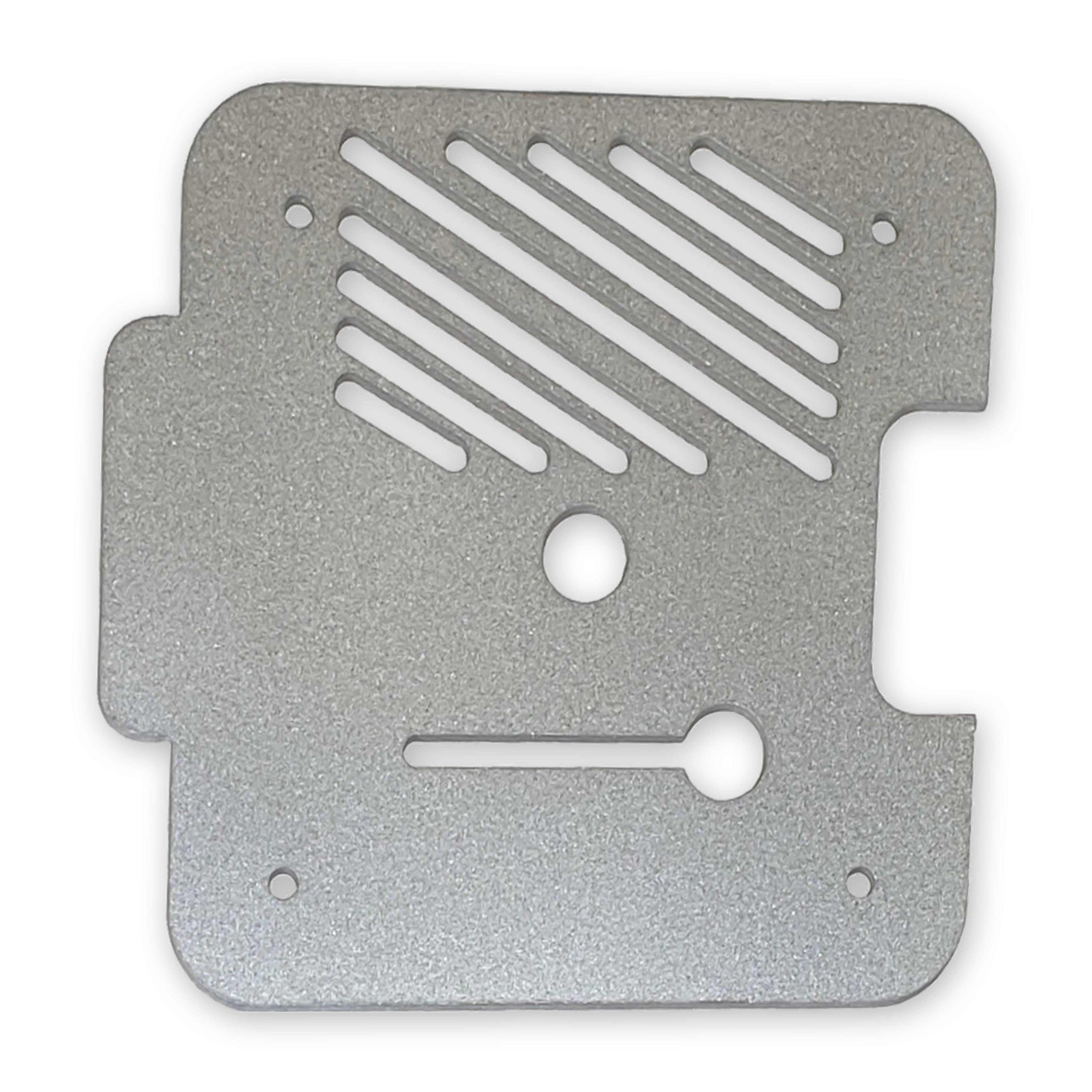

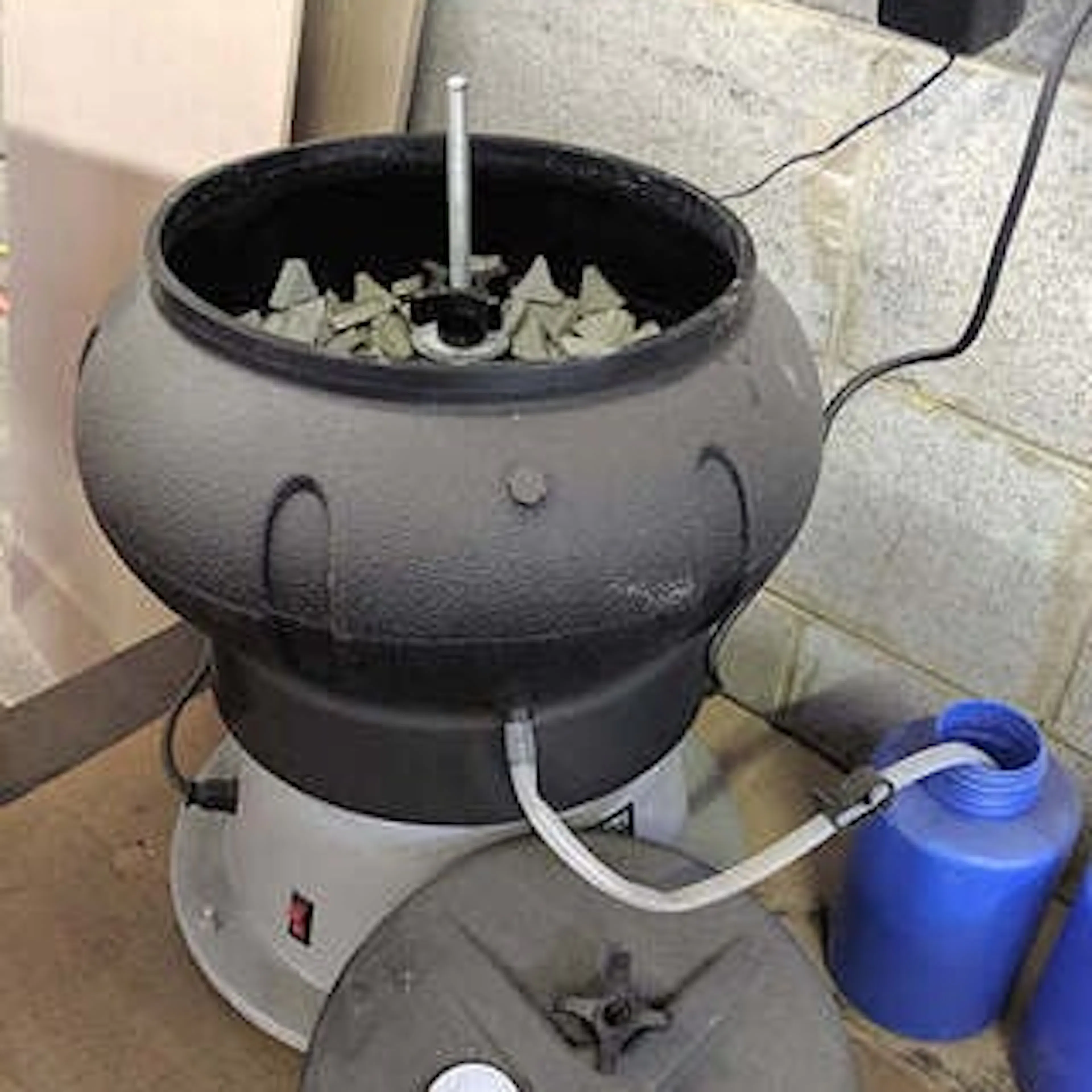

Media Tumbled Finish

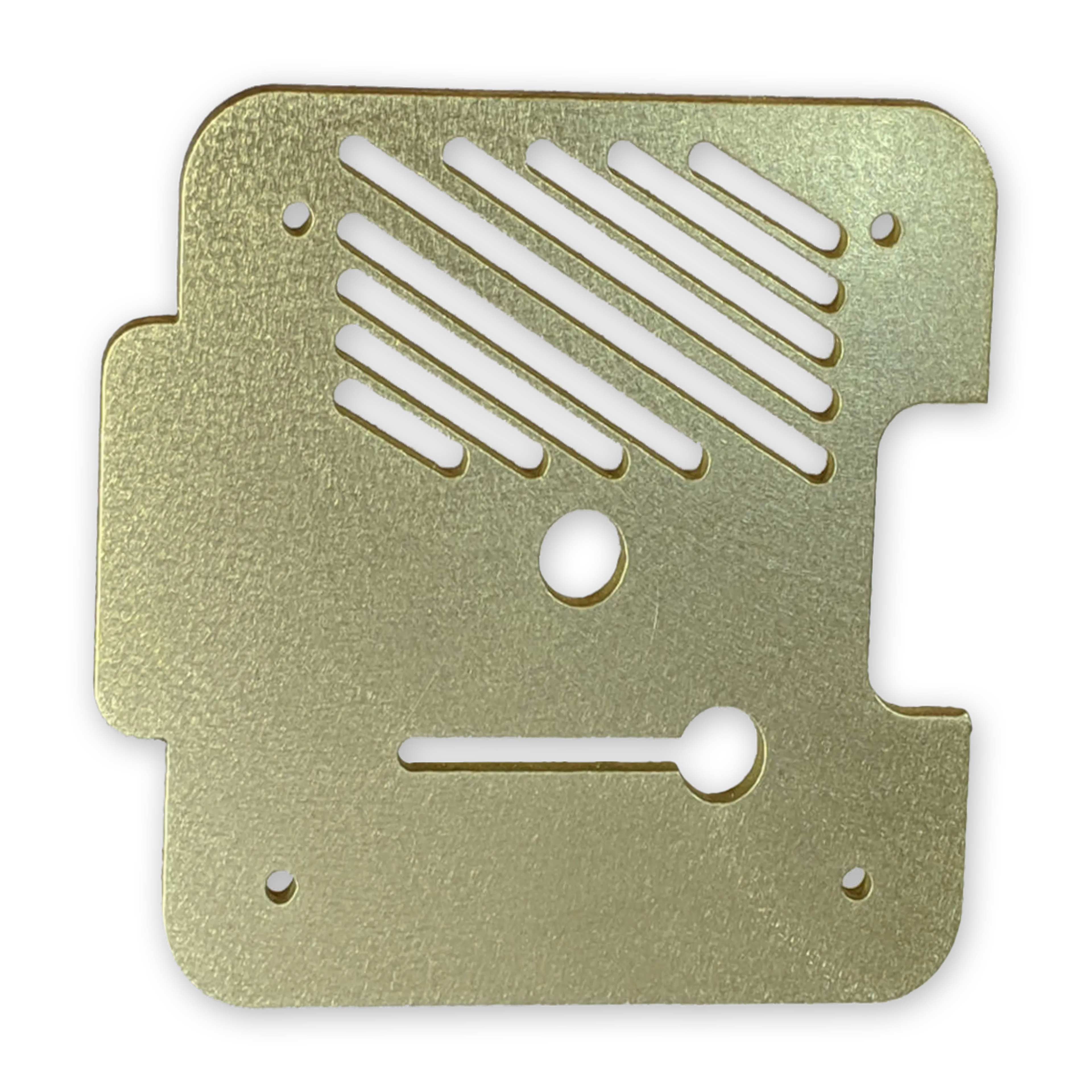

Media tumbling is an inexpensive way to remove burrs, reduce surface marks, and produce an even texture on smaller parts. We place parts in a vibratory tumbler with ceramic abrasive media. This combination of movement, water, and media puts a smooth and even surface all over the part's surface. Tumbling is excellent if you want to prep small jewelry parts or electrical connectors before further polishing or soldering. It is also a great way to process small parts for production work.
Suitable parts for media tumbling are typically smaller than four inches in both height and width. Also, the stock material must be strong enough to handle the tumbling process. We recommend stainless steel parts be 0.030" thick or greater for tumbling. For tumbled aluminum and other non-ferrous metals we recommend they be at least 0.045" thick. With a media tumbled finish, our techs will also remove any tabs by grinding so that they do not appear on the finished part.

Copper sheet metal part with a tumbled finish.
Copper With Tumbled Finish

Brass sheet metal part with a tumbled finish.
Brass With Tumbled Finish

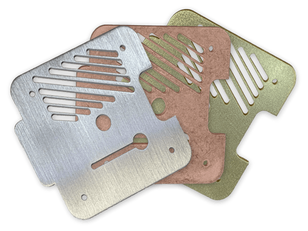

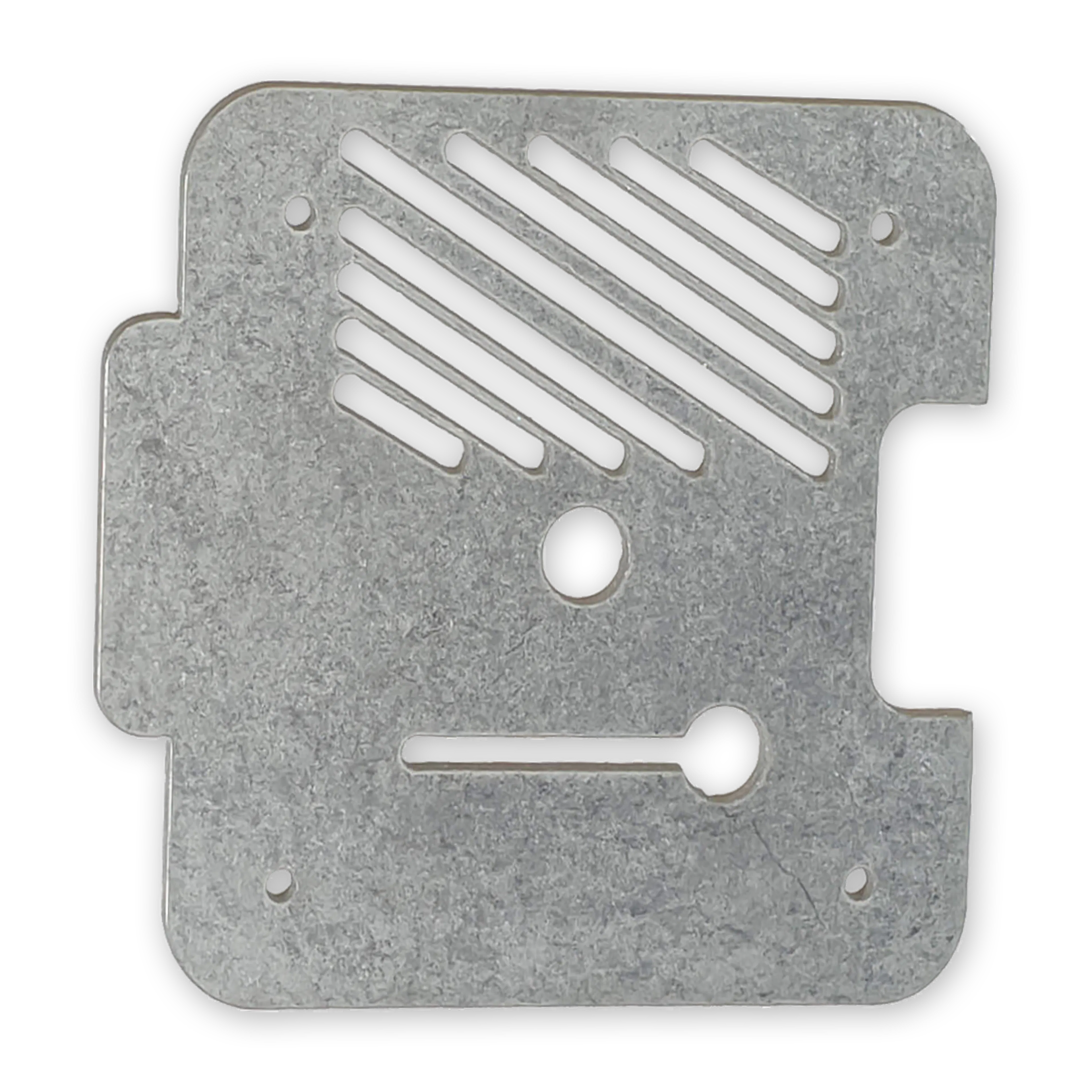

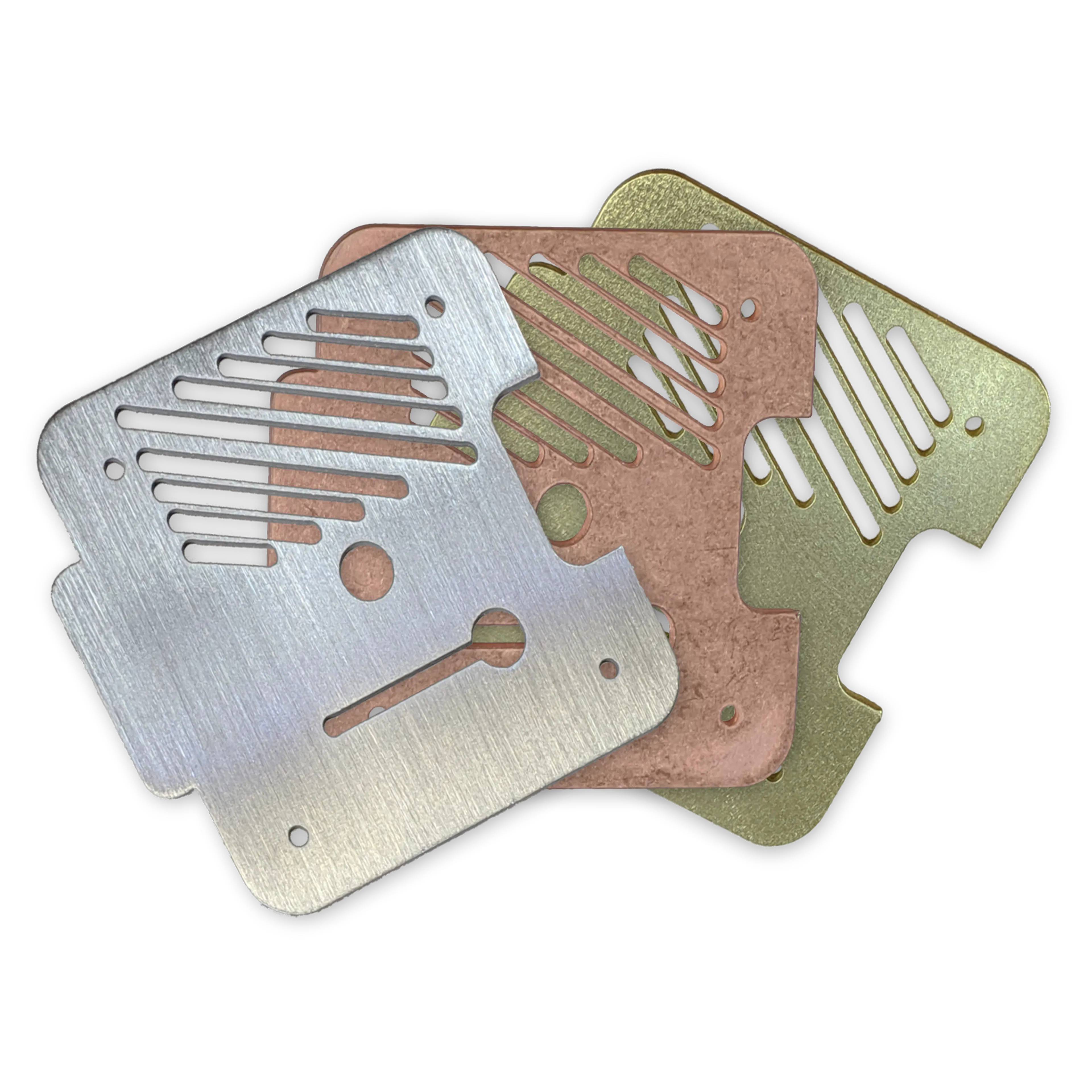

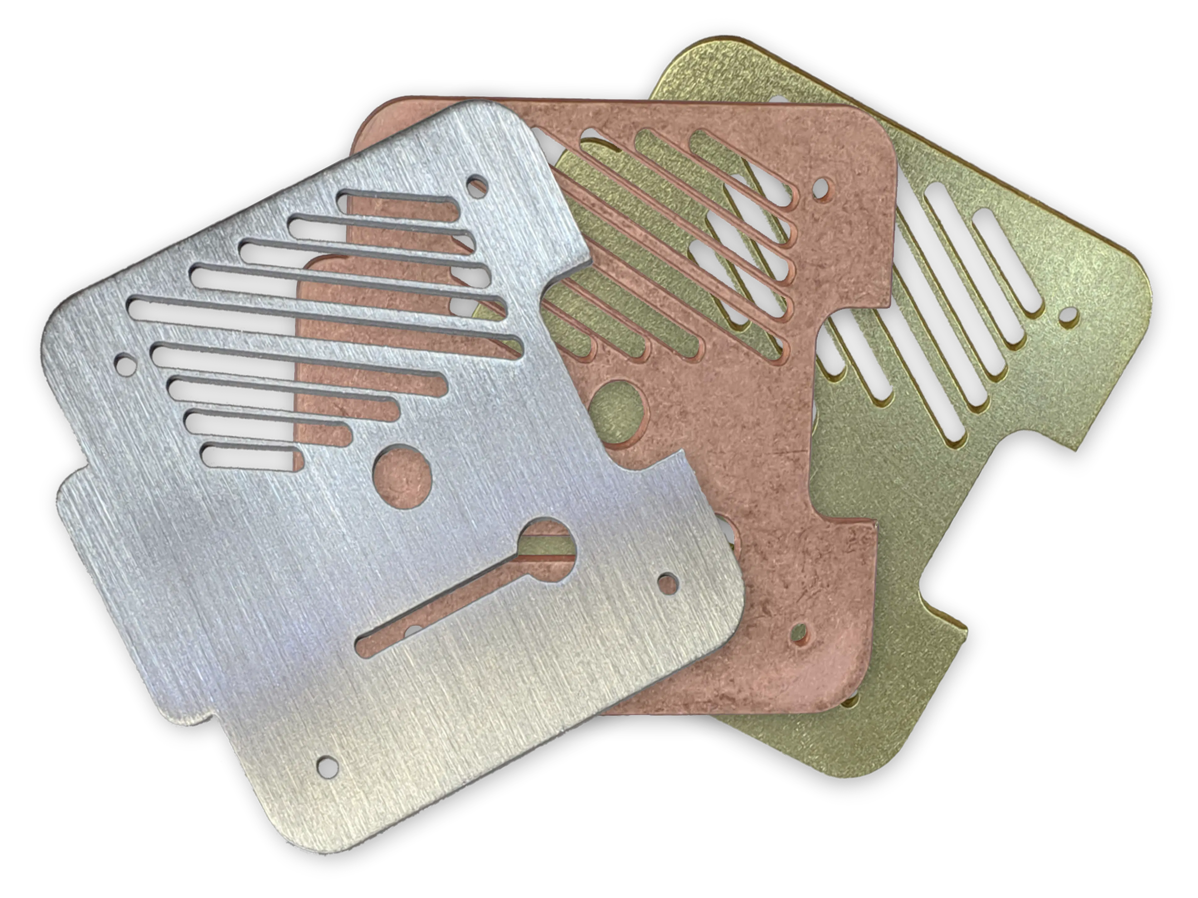

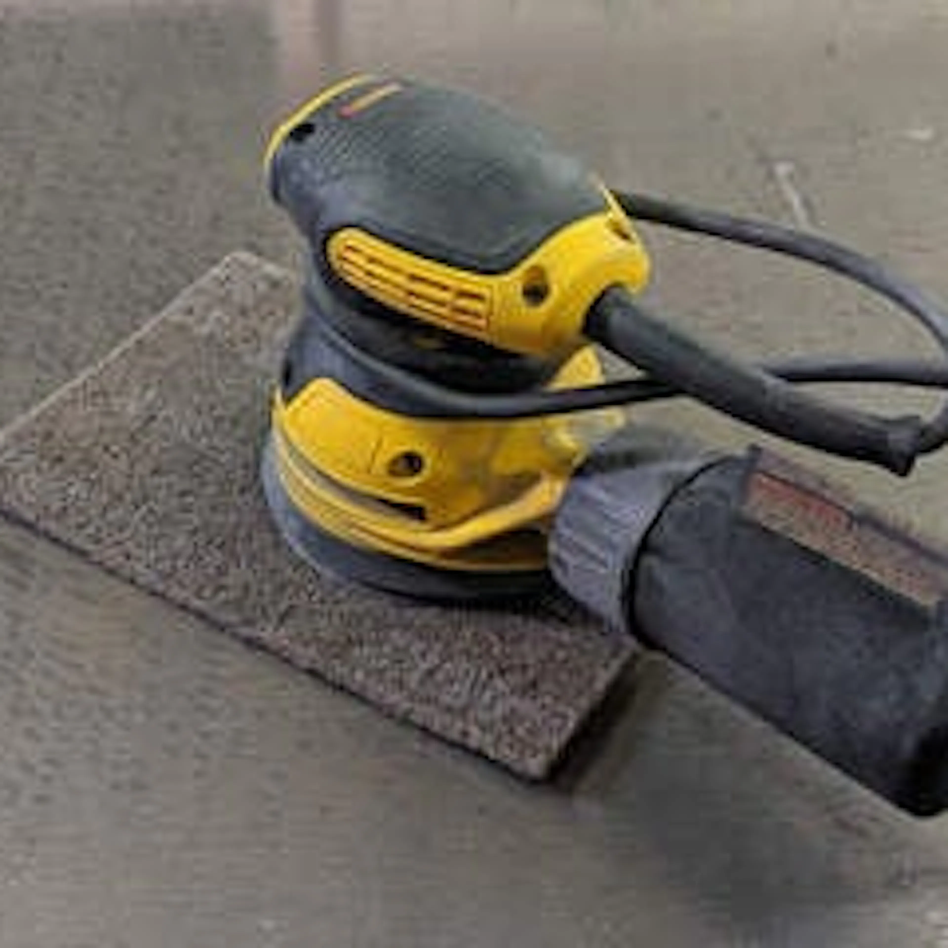

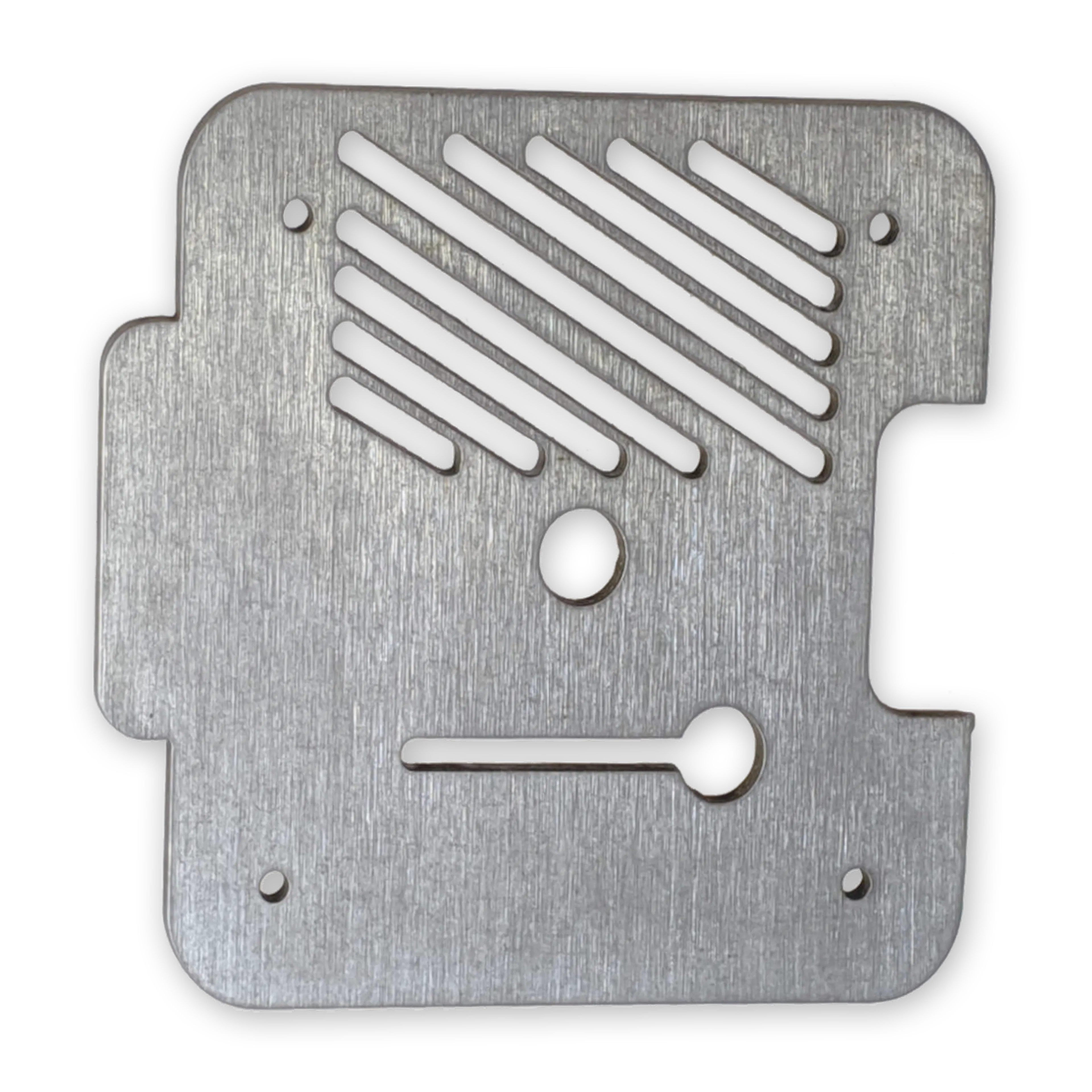

Sanding Random (Swirl) Finish
Sanding Random (Swirl) parts are finished on both the top and bottom faces with a powered non-woven abrasive pad in a random orbital pattern. Many of our signage clients use this finish for signs as the all-over brushed finish looks good in a wide variety of locations, and the texture left behind by the abrasive pad also provides a good "tooth" for paints to hold. This finish removes all light surface scratches, mill marks, and burrs. Orbital sanding finishes are best for parts above six inches. Tumbling (see below) is recommended for smaller parts. Like bead blast, sanding random swirl finishes are excellent for preparing surfaced before anodizing to create a matte non-reflective appearance.
Note: This finish can be requested with the "Other" finish option when quoting.
Gallery: Sanding Random (Swirl) Finish
A random orbital sander
Orbital Sander
Copper sheet metal part with a random swirl finish.
Swirl-Finished Copper
304 stainless steel sheet metal part with a random swirl finish.
Swirl-Finished 304 Stainless Steel
Aluminum sheet metal part with a swirl finish.
Swirl-Finished Aluminum
Brass sheet metal part with a random swirl finish.
Swirl-Finished Brass
Low carbon steel sheet metal part with a random swirl finish.
Low Carbon Cold Finshed Steel With Random Swirl

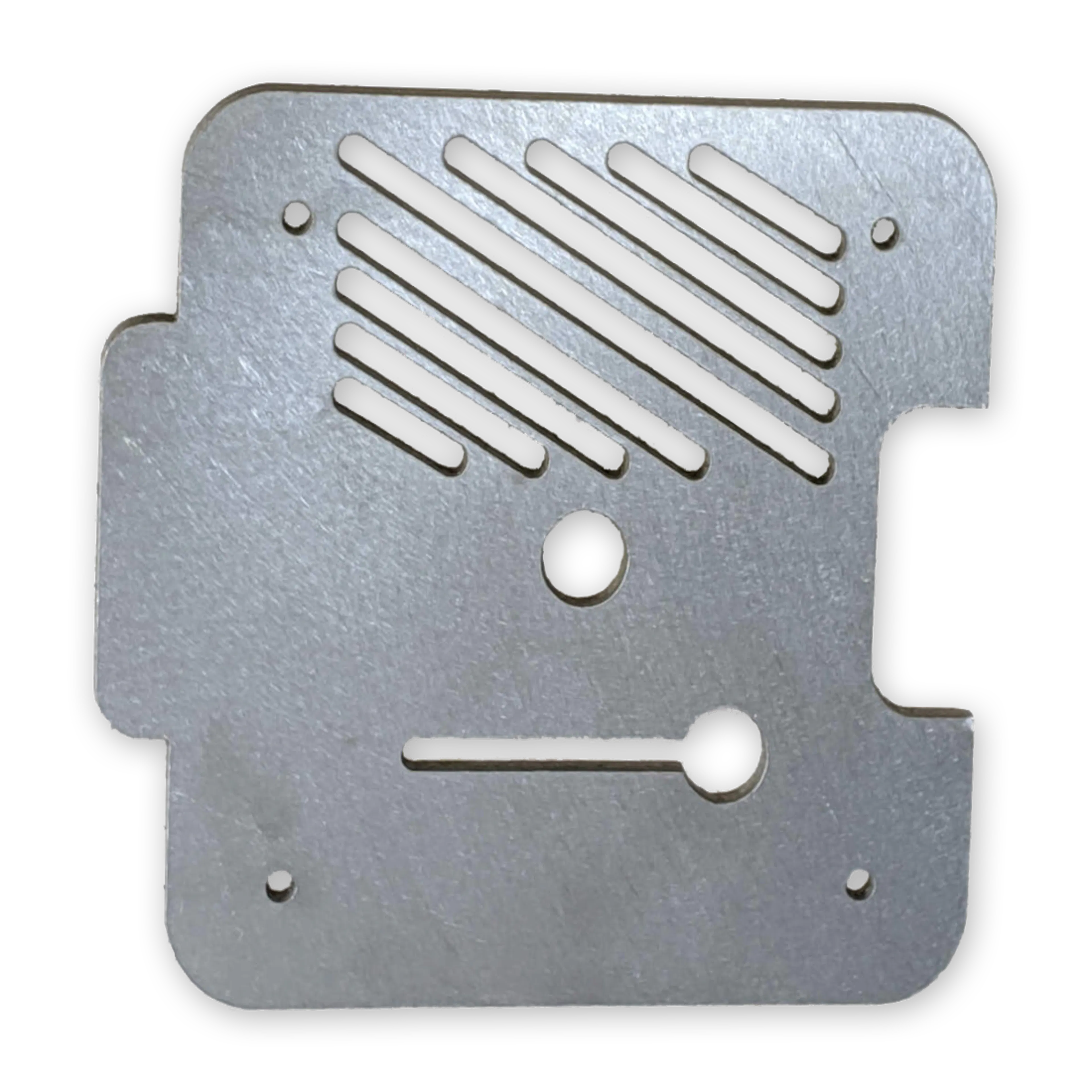

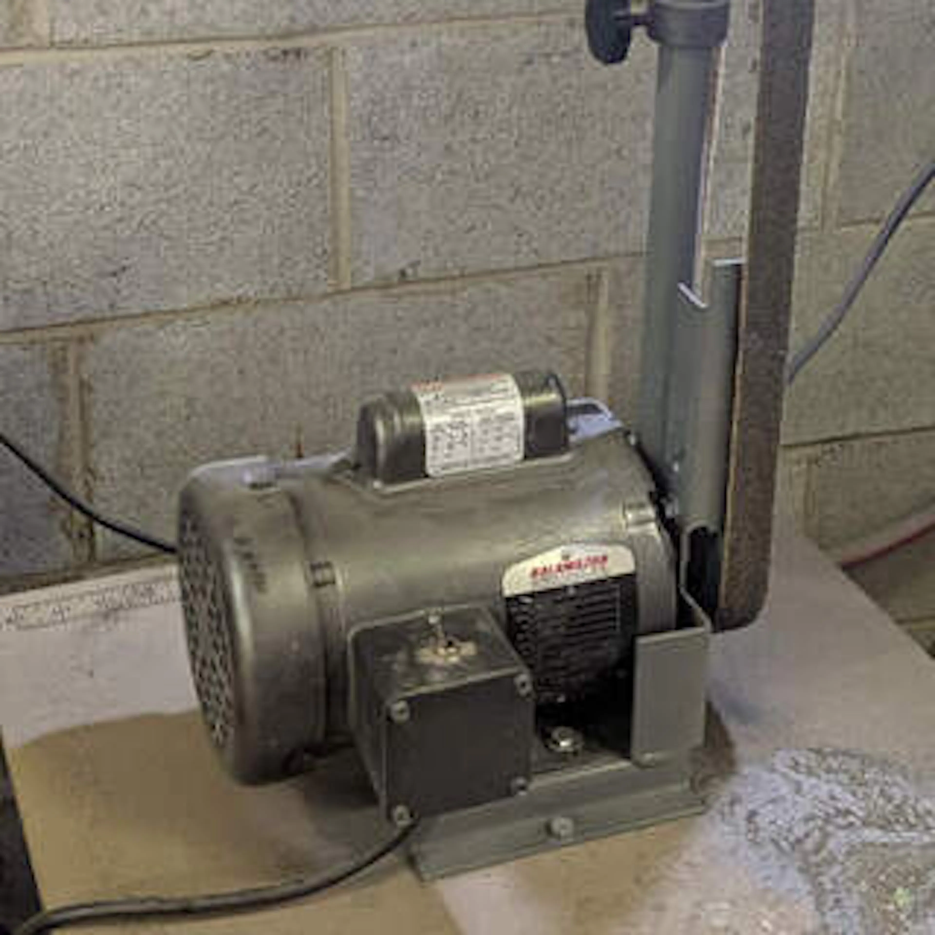

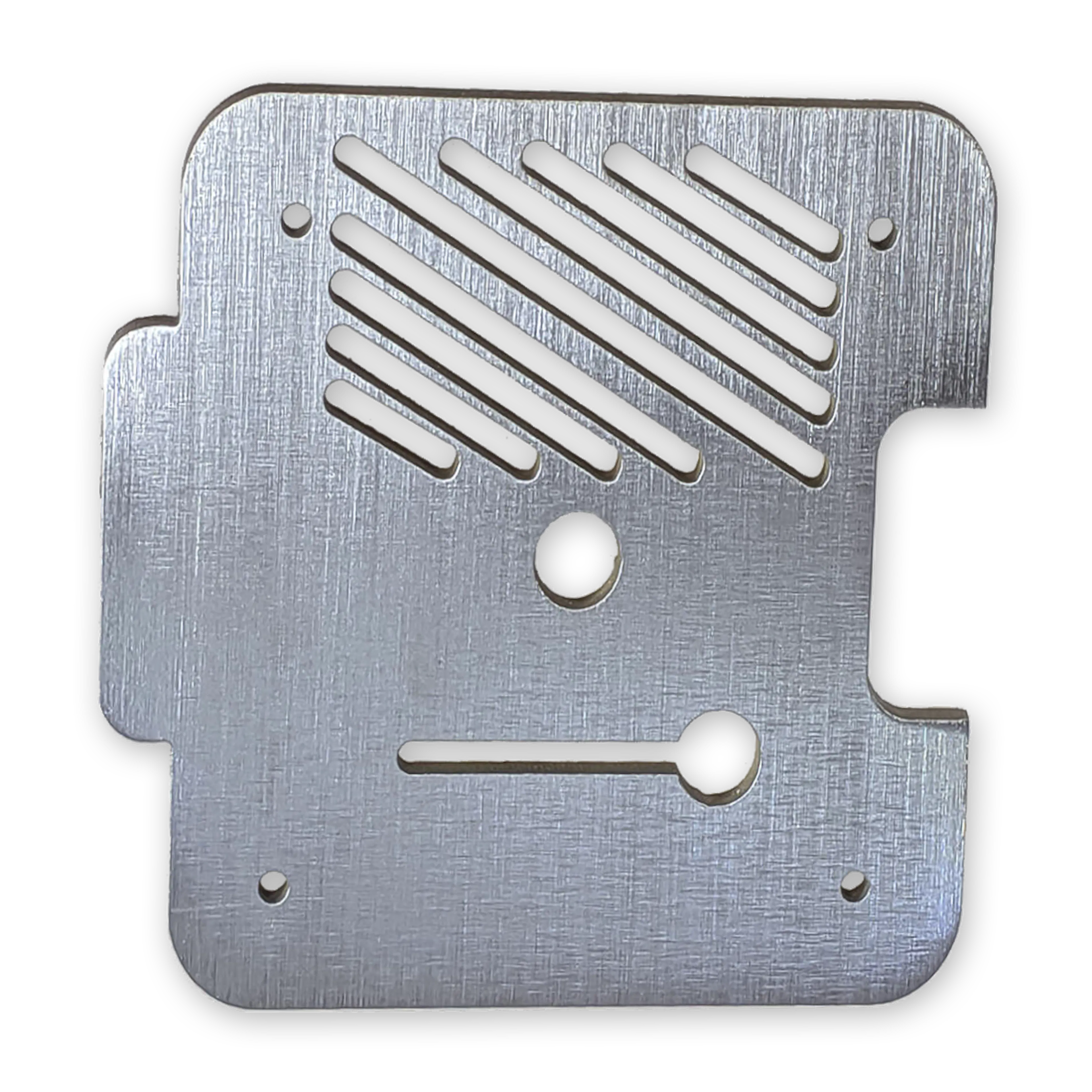

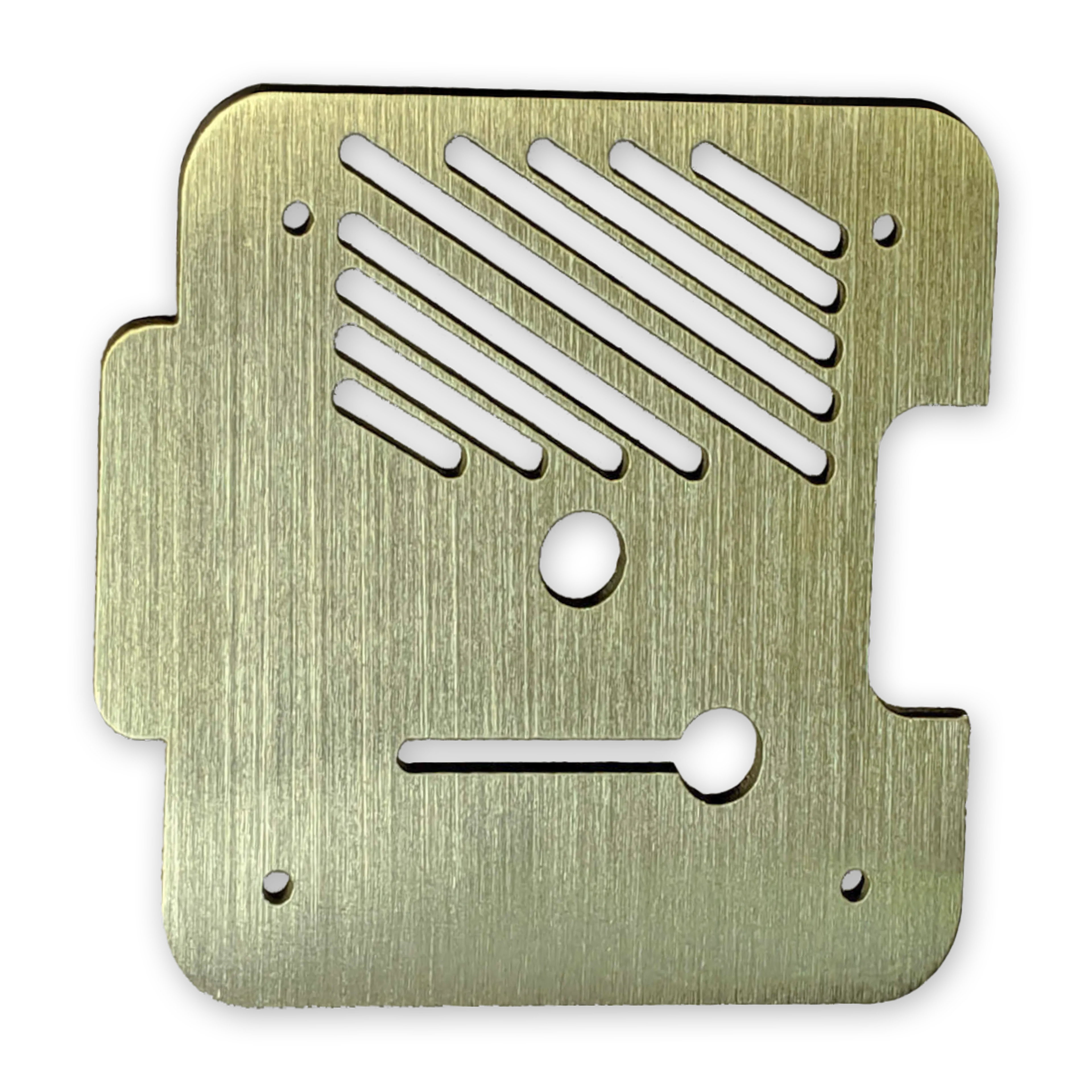

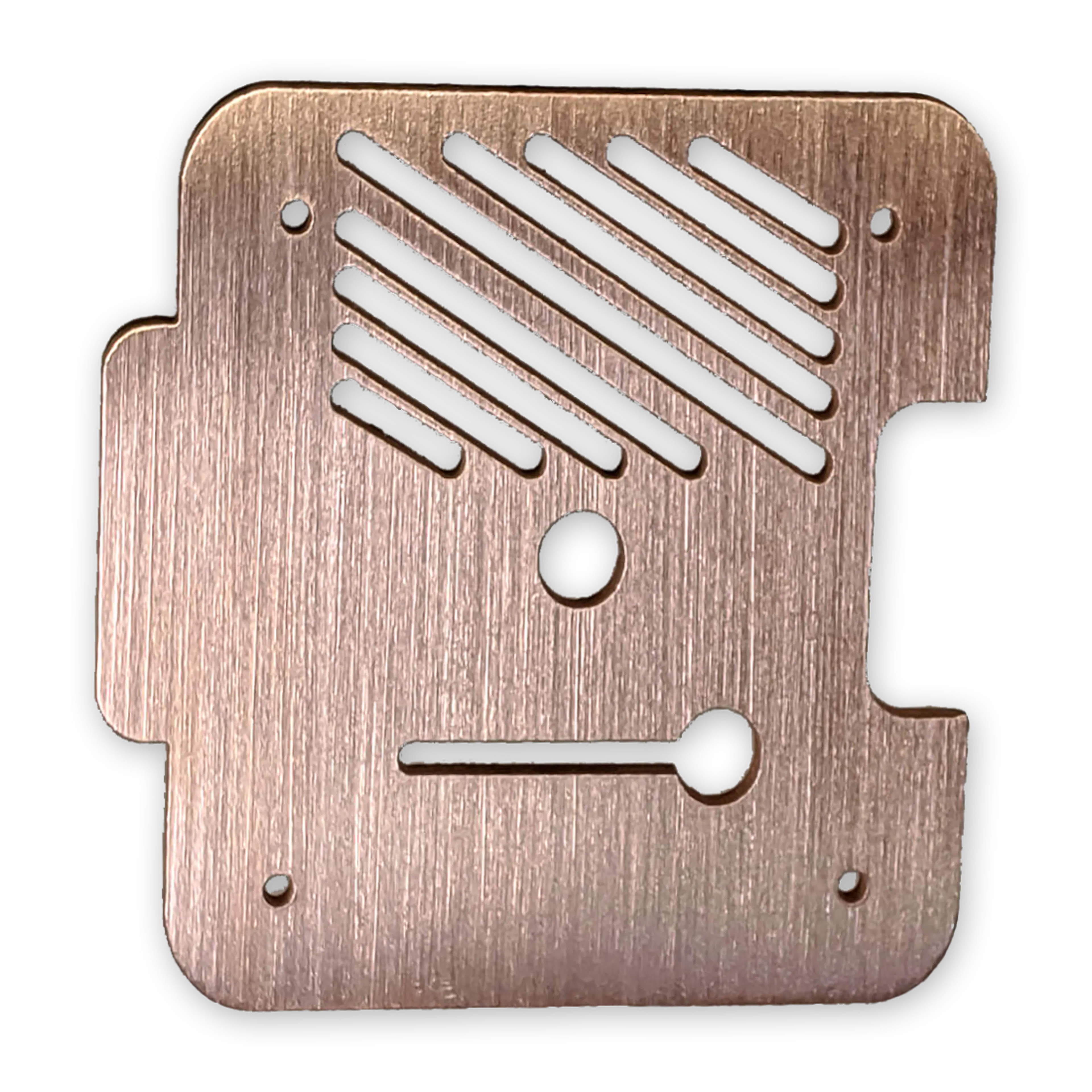

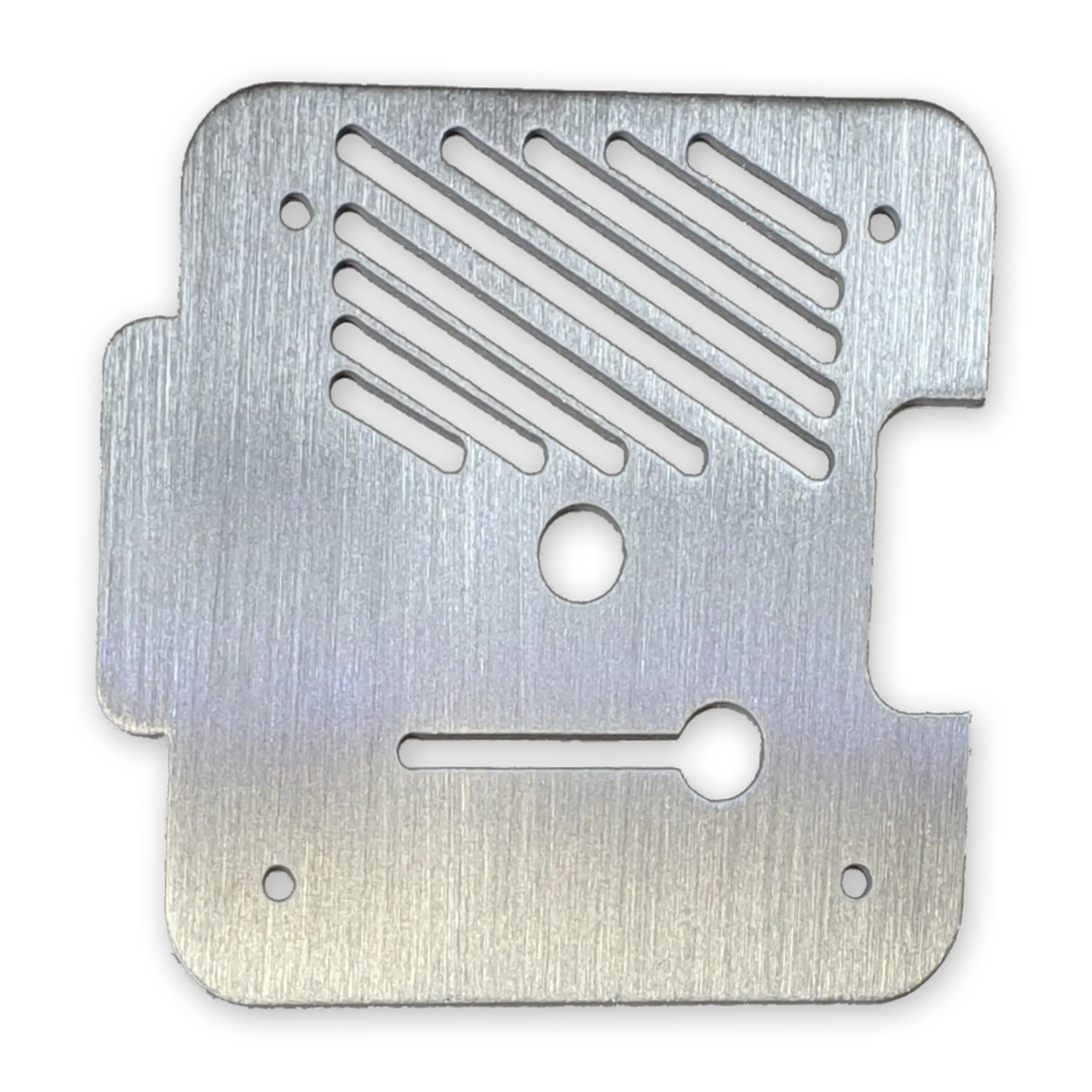

Linear Grain Sanded Finish

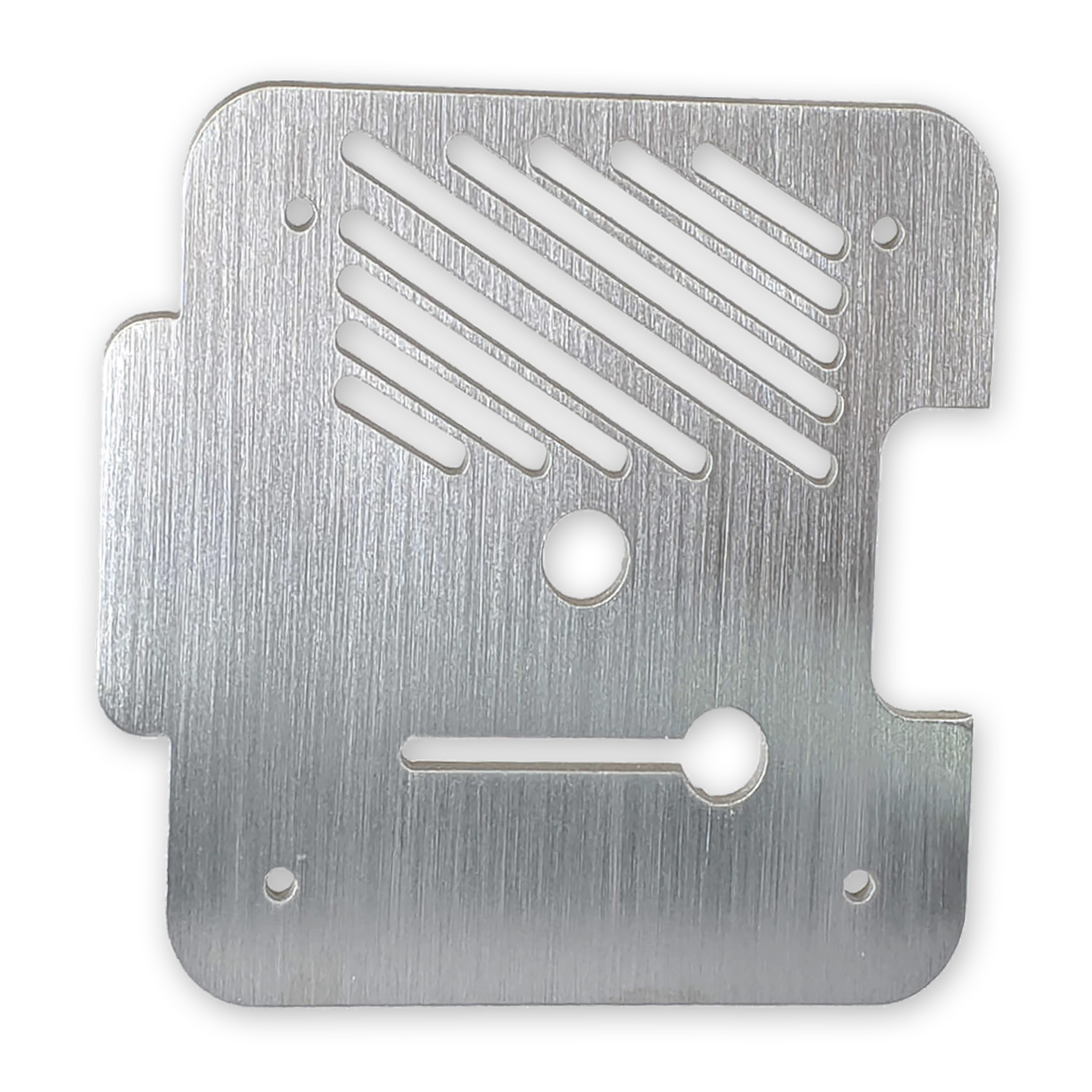

Also called a brushed or Timesaver finish, Linear Grain finishes are created by sanding both sides of the metal with a non-woven abrasive on a belt sander or Timesaver machine. This produces a brushed look with uniform, parallel lines. While the result is attractive and suitable for most applications, it is not a perfectly consistent #4 standard finish, since the process involves manual operation. By default, sanding follows the natural grain of the material. If a custom grain direction is required, please include this on your drawing.
Gallery: Sanding with Grain (Linear) Finish
A belt sander
Belt Sander for Linear Sanding
Copper sheet metal part with a linear grain finish.
Linear Grain Sanded Copper
304 stainless steel sheet metal part with a linear grain finish.
Linear Grain Sanded 304 Stainless Steel
Aluminum sheet metal part with a linear grain finish.
Linear Grain Sanded Aluminum
Brass sheet metal part with a linear grain finish.
Linear Grain Sanded Brass
Low carbon steel sheet metal part with a linear grain finish.
Linear Grain Sanded Low Carbon Steel
