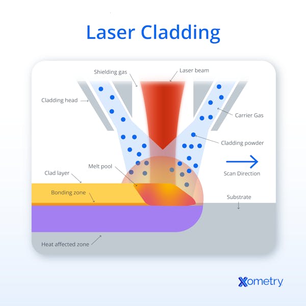

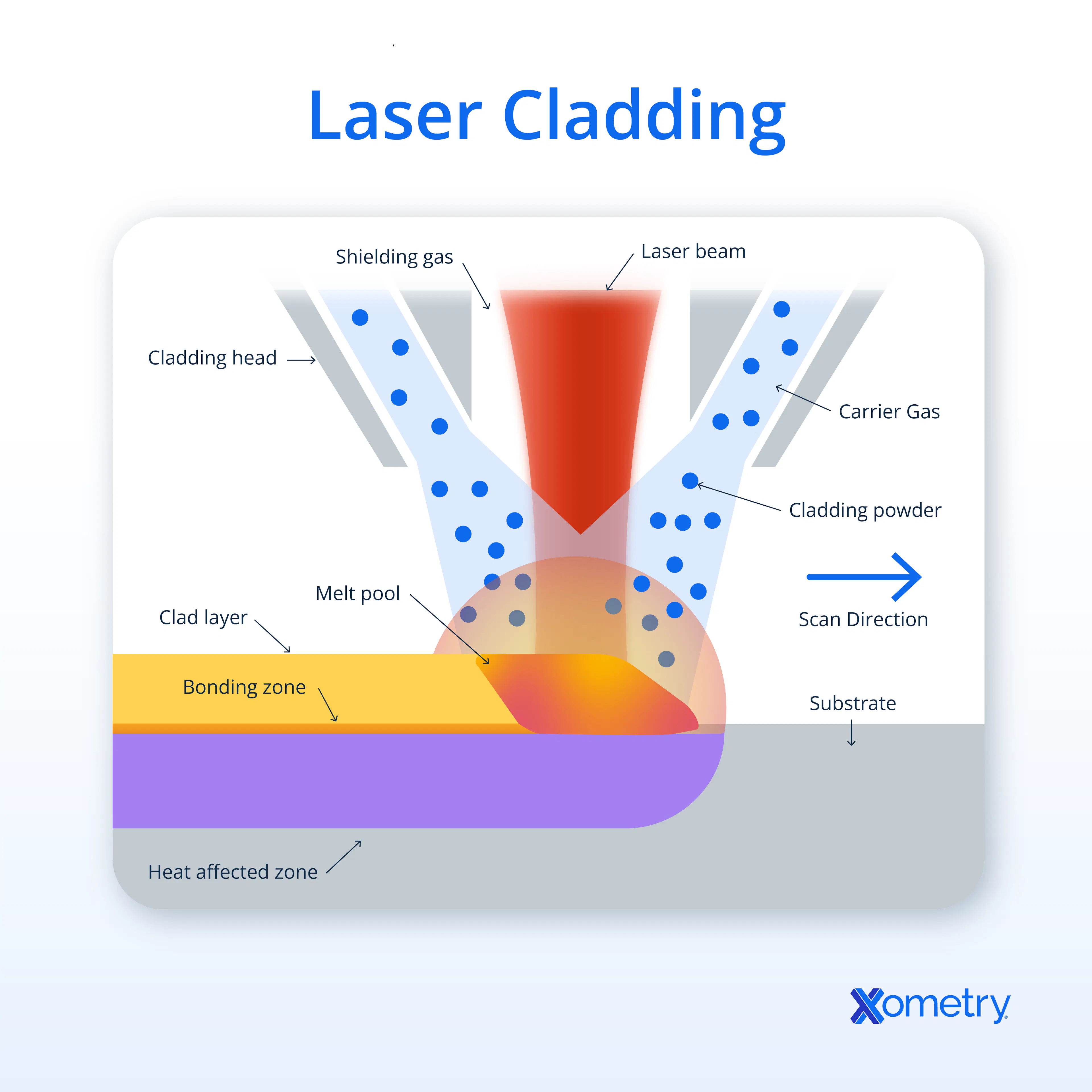

How Does the Laser Cladding Process Work?
Laser cladding works by depositing material, typically metal powder or wire, onto a substrate using a laser beam as the heat source. The laser simultaneously melts the feedstock and a thin layer of the substrate, allowing the molten material to fuse and form a metallurgical bond. The process allows precise control of coating thickness, composition, and surface characteristics.
An illustration of the laser cladding process.
