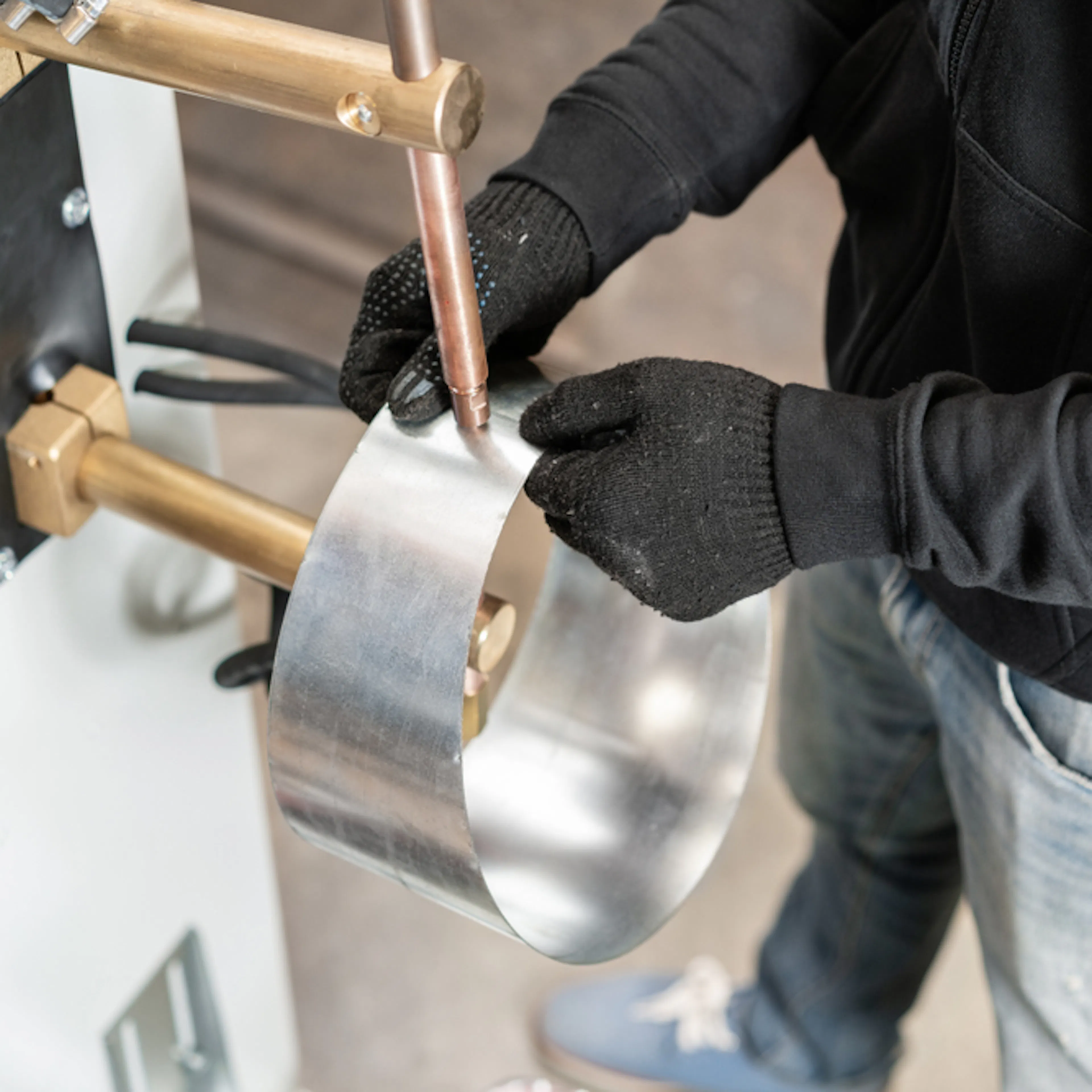

Spot welding is a contact welding technique used extensively in the automotive industry for strong and aesthetic welds. It works by using two electrodes to pass a current through the weld spot to increase the heat of the weld site, melt the metal, and fuse the parts. Spot welding is efficient and can be automated, however, it is limited to 3 mm thick welds.
What Is Spot Welding?
Spot welding works by applying an electrical current across the mating surfaces of two (or more) pieces of metal to melt and bond them. This is achieved using two copper alloy probes which apply the current across the metals. The resistance to the applied current increases the temperature of the metal, which in turn melts it. The probes also apply pressure to keep the material in place.

Spot welding is a three-step process that involves aligning the workpiece, applying electrode pressure, and then using current to bond the metal. The three steps are described below in detail:
  1. Aligning the Metal: First align the metals correctly, as once welded they cannot be changed. The alignment must be secured properly as the process will cause the metal to warp. The welding locations must follow an order which will minimize warping. For example, welding two sheets may require welding one corner, then the other, then the middle. This will prevent the weld from deforming as the joint is welded from one corner to another.
  2. Applying Pressure: The second stage of welding is applying the right amount of pressure to the electrodes. By applying pressure, the molten metal created by the resistance of the current traveling through the separate pieces will be forced together. The use of copper electrodes is common as they can withstand heat and pressure without oxidizing.
  3. Current Flow: Lastly the current is applied. If the welding is not automated, a foot pedal is usually used to apply the current. The time and intensity of the current applied depends on the thickness of the material. For a short time after the current stops the metal will remain clamped to allow the metals to fuse properly.
