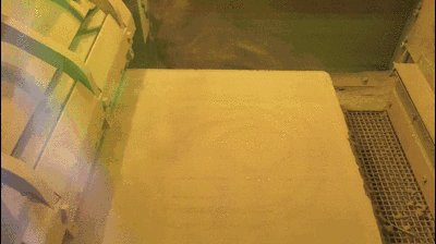

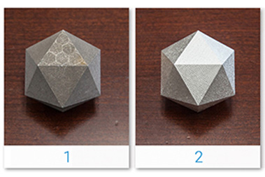

DMLS part
Direct laser metal sintering (DMLS) has been used by many manufacturers since the late 1990s to make complex metal parts that can’t easily be produced with the likes of stamping or extrusion. This 3D printing process is complex in and of itself, but it’s also a unique technology that’s hard to find an alternative for when it comes to specific components. Whether you’re considering having your own products printed through DMLS, or simply just intrigued by the concept, read on to find out all about this manufacturing method.

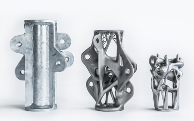

Direct Metal Laser Sintering (DMLS) is used for the serial manufacture of complex industrial metal components that cannot be made economically - or at all - with other metal manufacturing technologies, such as CNC machining or metal injection molding. When parts are manufactured using traditional subtractive processes, they often need to be assembled from multiple components. However, DMLS 3D printing can create a monolithic part that eliminates the inherent weaknesses and complexities of assembled parts. DMLS printing is most often used in the aerospace, medical, turbomachinery, and automotive industries.

Now that you get the gist, we’re going to get more into the nitty gritty of the DMLS process. The start of the process involves the fiber laser beam, which can have up to 1,000 W of power. It begins scanning the cross-section of a part layer and starts melting the powder particles together.
While there is often one laser beam, some machines have the capacity to shoot out four beams at a time, which quadruples how quickly the process moves along. Usually, a DMLS printer will scan and laser at a speed of around 7 m/s.
Once the first layer is finished, the bed moves down, and another layer of metal powder is put down. Then, the system will fill the printing chamber with an inert gas to prevent the part from oxidizing during the rest of the printing process. After this takes place, the melting of the next layer occurs until the part is complete.
The quality and accuracy of the print comes down to how good the laser and optical components of the printer are. Normally the focal point is between 40 to 100 microns in diameter—which means the smallest feature you can get is 40 microns.

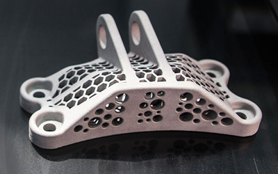

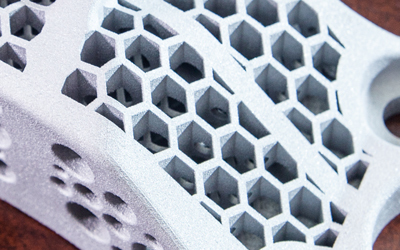

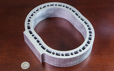

The following image shows a stainless steel part we printed through DMLS.
Stainless steel part made by Xometry with DMLS 3D printing.
