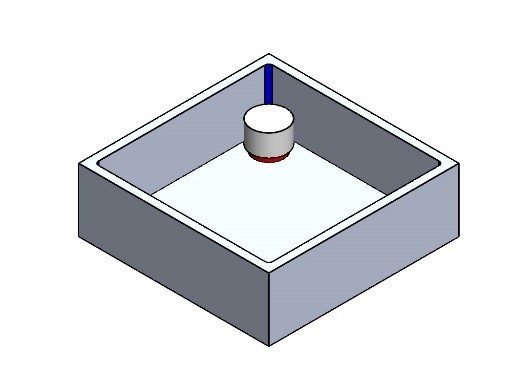

In some cases, the undercut feature may be too deep to be reached by any tool.
Because the tool required has a horizontal cutting blade attached to a vertical shaft, there are limits to the depth of the cut. There is no hard and fast rule as to the depth of the undercut, but the shallower the better. Also, when designing the undercut feature, it is critical to only create undercuts in areas that the tool can reach. The illustration below depicts and undercut feature that cannot be reached in the machining process.
