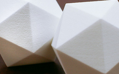

Standard Finish
SLS finishes standard
This is the default finish for SLS. Parts are removed from the build chamber and all powder is cleaned through bead blasting. The surface appearance is a satin-like matte finish that is slightly grainy to the touch.
Media Tumbled
SLS finishes media tumbled
Parts are tumbled in polishing media for several hours to smooth outer surfaces. The resulting finish is smooth to the touch with a satin-like matte appearance.
Note: Sharp edges may be dulled during this process and parts with fragile features are not recommended for tumbling.

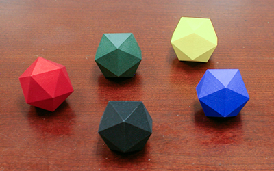

Dyed
SLS finishes dyed
Colors are applied to parts with a standard finish using dye. This process is currently available in red, yellow, blue, green, and black.
Note: The dye penetrates 0.25mm into the part surface.

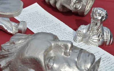

Nickel Plating
SLS finishes nickel plated
Parts are plated with ~0.1mm / 0.004″ nickel. Plating increases part strength, stiffness, and environmental resistance.
Note: This finishing process adds 4-5 business days to the lead time.

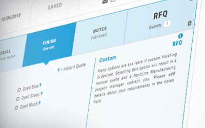

Custom Finishes
We can accommodate a range of custom finishing requests such as tapping, inserts, and painting.
Just add details about your requirements in the notes section of your order and a project manager will contact you.
