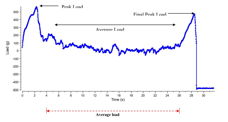

Peel tests are conducted at a uniform speed along the tensile direction. The peel strength is determined by first measuring the load required to peel the specimen, then calculating the average of this load, and finally dividing it by the bond line's width. The data for peel-strength calculations are obtained from the steady, or linear, section of the load-versus-position graph.
How Do You Read Peel Test Results?
During a peel test, a load vs. position curve is generated during the test. The first result that is of value is the peak initial force, which reflects the maximum force required to start the peeling process. This value is critical for understanding the initial adhesion strength between the bonded materials. That graph can also be used to calculate the average peel force across the bond line, which is typically presented as force per unit width (e.g., newtons per millimeter or pounds per inch). This average force indicates the consistent strength of the adhesive bond throughout the test. Use a linear section in the load vs. position curve to determine the average force. This is a good indicator of uniform peel strength, which signifies a stable and consistent adhesive performance across the entire bond line.
