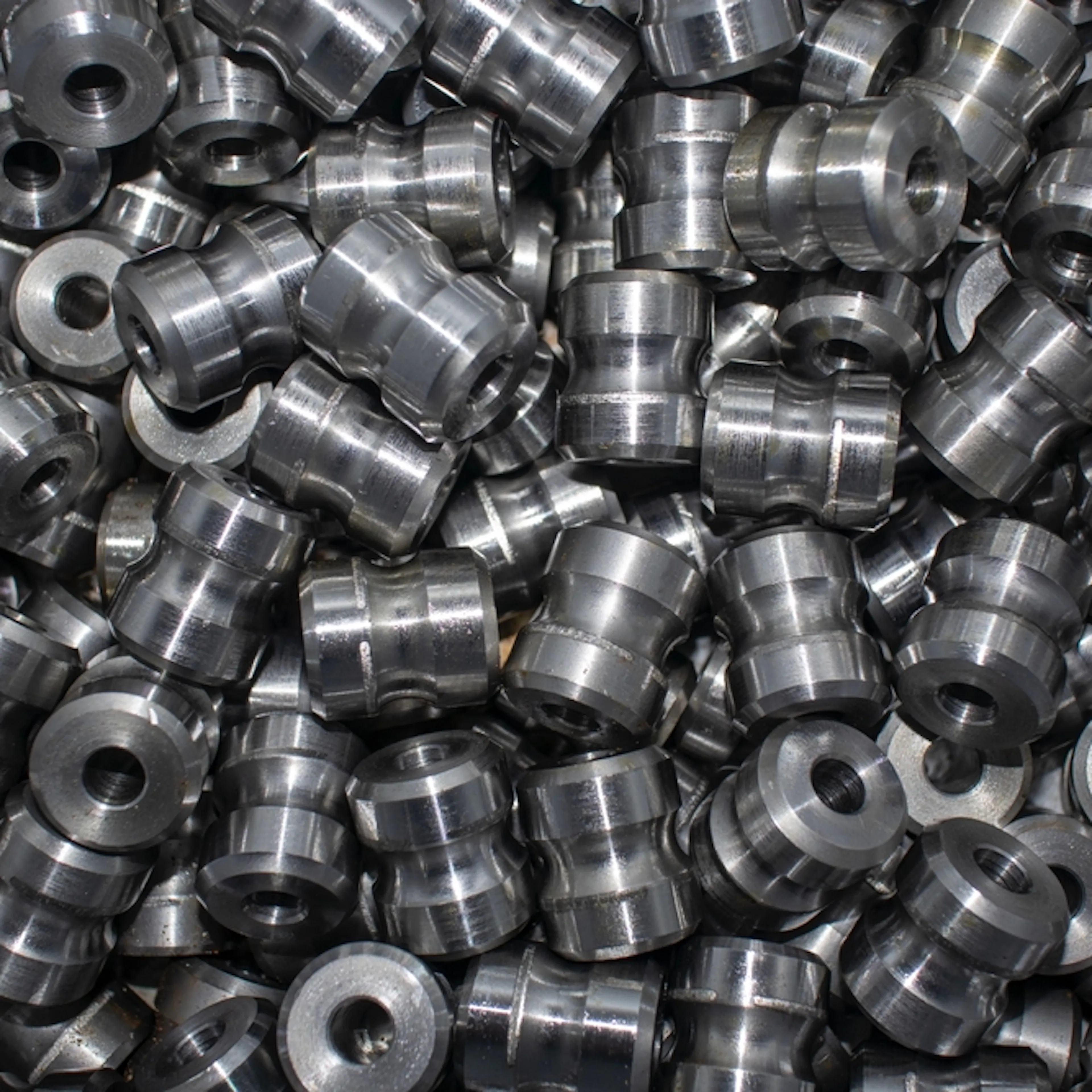

4140 machined parts. Image Credit: Shutterstock.com/Oliver_twist86
Sure, it’s possible to buy 4140 steel in its plain state, but you’ll find that its pre-hardened version makes a good case for why manufacturers should buy it instead. Mostly, this is because it’s harder and tougher thanks to its pre-treatment. Aside from these characteristics, it also brings a high tensile strength to the table. Here’s why it’s worth considering, and other important info you should know about working with this particular steel alloy.
