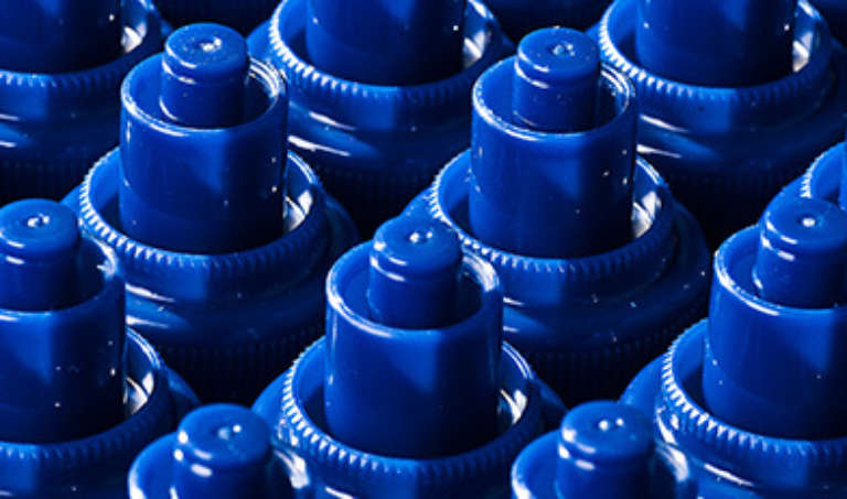

Overmolding is a versatile manufacturing process that bonds one material, usually a thermoplastic elastomer (TPE/TPV), to another material (typically a rigid plastic substrate) using injection molding equipment. This method delivers a powerful combination of aesthetics, haptics, and functional performance, providing benefits like superior grip, shock absorption, impact resistance, enhanced surface protection, and better chemical insulation for an improved tactile experience.
Illustration showing an overmolded component assembly.
A key advantage of overmolding is its ability to seamlessly fuse multiple materials into a single, durable component through mechanical or chemical bonding. This technique is perfect for projects requiring customized designs, flexibility, or enhanced functionality, and it reduces manufacturing costs by consolidating parts into a single, integrated component.
