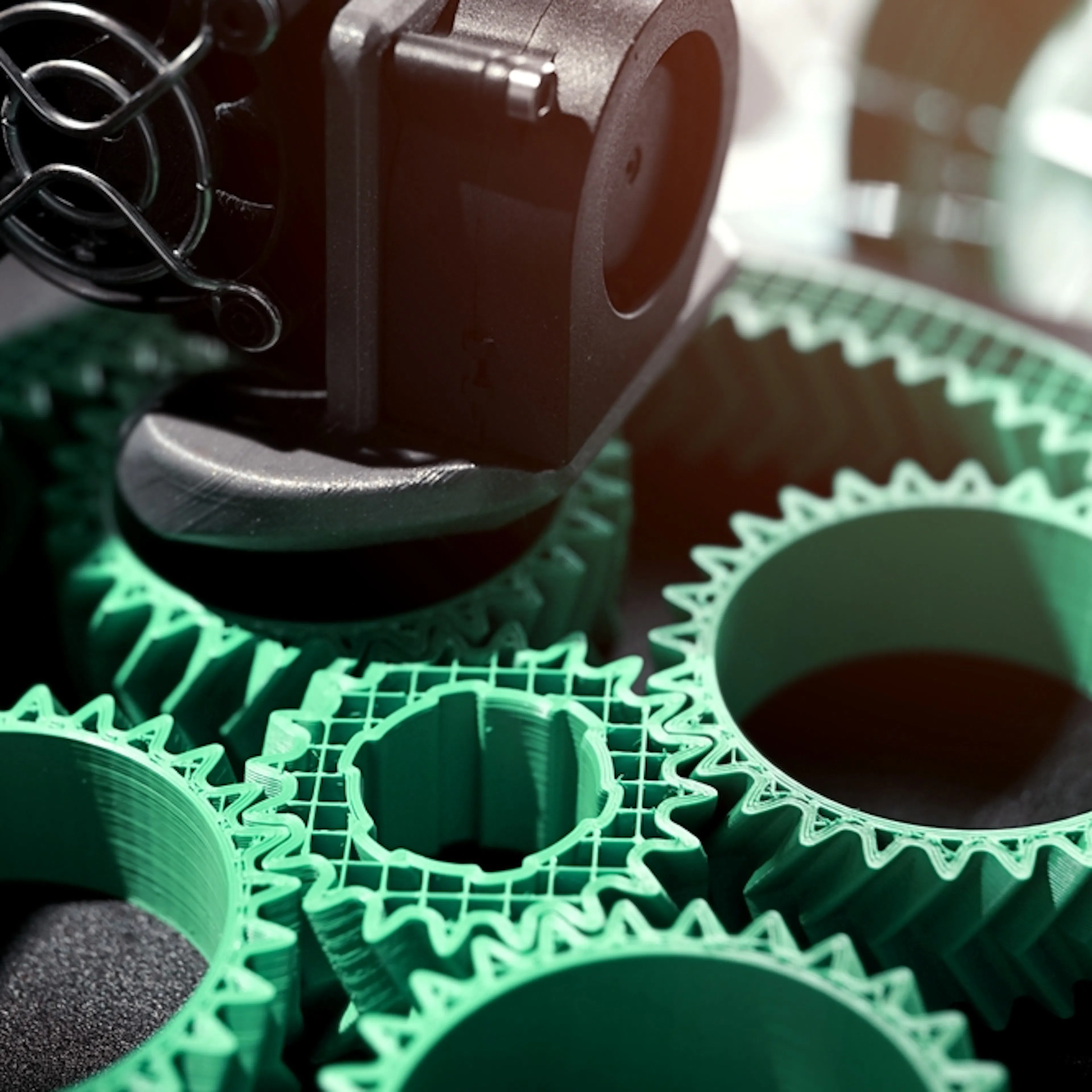

3D printed part. Image Credit: Shutterstock.com/R_Boe
