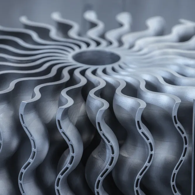

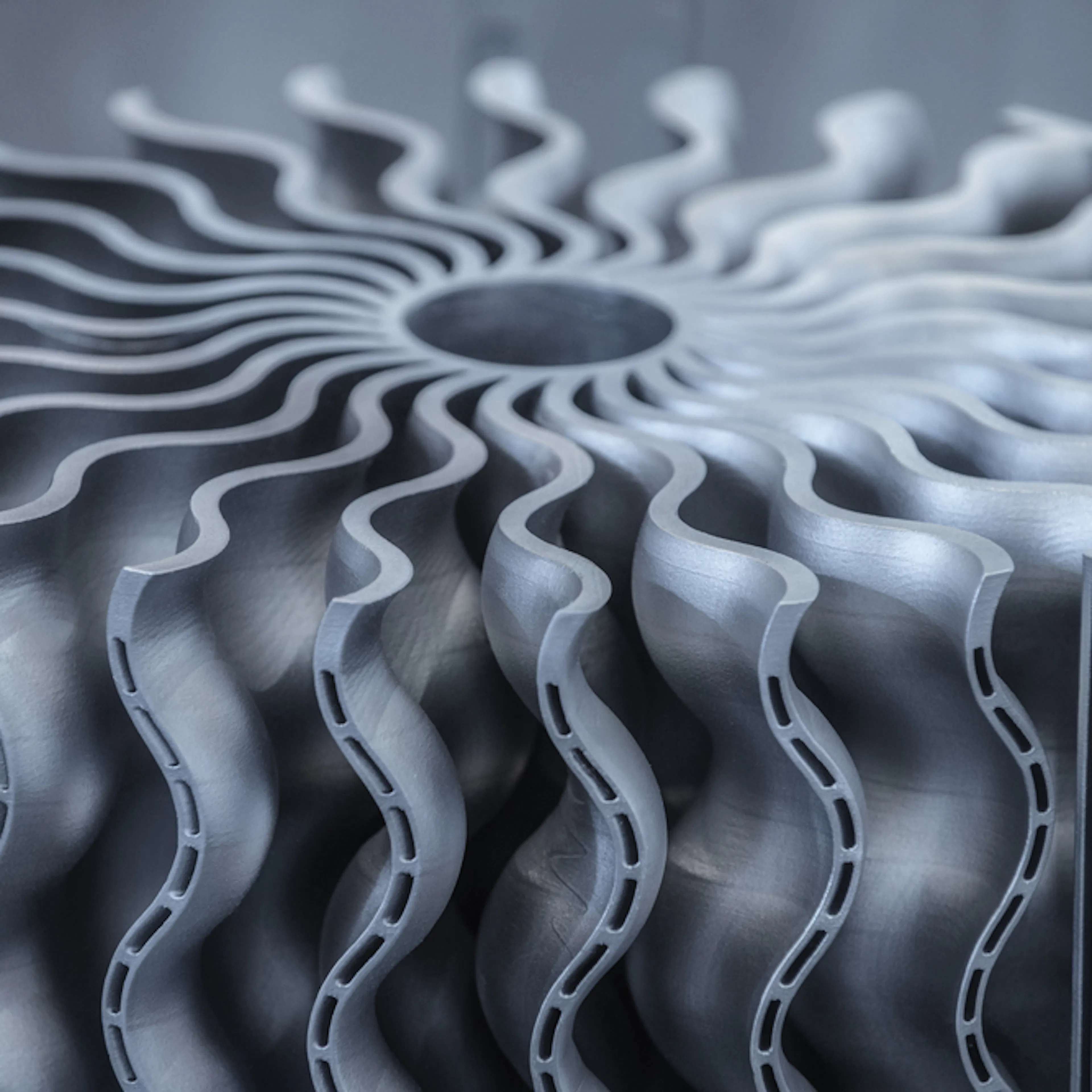

3D printed aerospace component. Image Credit: Shutterstock.com/Sergii Chernov
The aviation industry has increasingly adopted 3D printing (additive manufacturing) to produce aircraft components. This technology offers several advantages, such as reduced material waste, faster production times, and greater design flexibility. However, despite its benefits, 3D printing also presents a range of limitations that can impact the performance, safety, and cost-effectiveness of aircraft parts.
In this article, we examine nine key limitations that impact the application of 3D-printed components in aviation. These include challenges such as material constraints, regulatory hurdles, equipment costs, and the need for highly skilled technicians. While these issues pose significant obstacles, many can be addressed through continued research, process refinement, and technological advancements.
