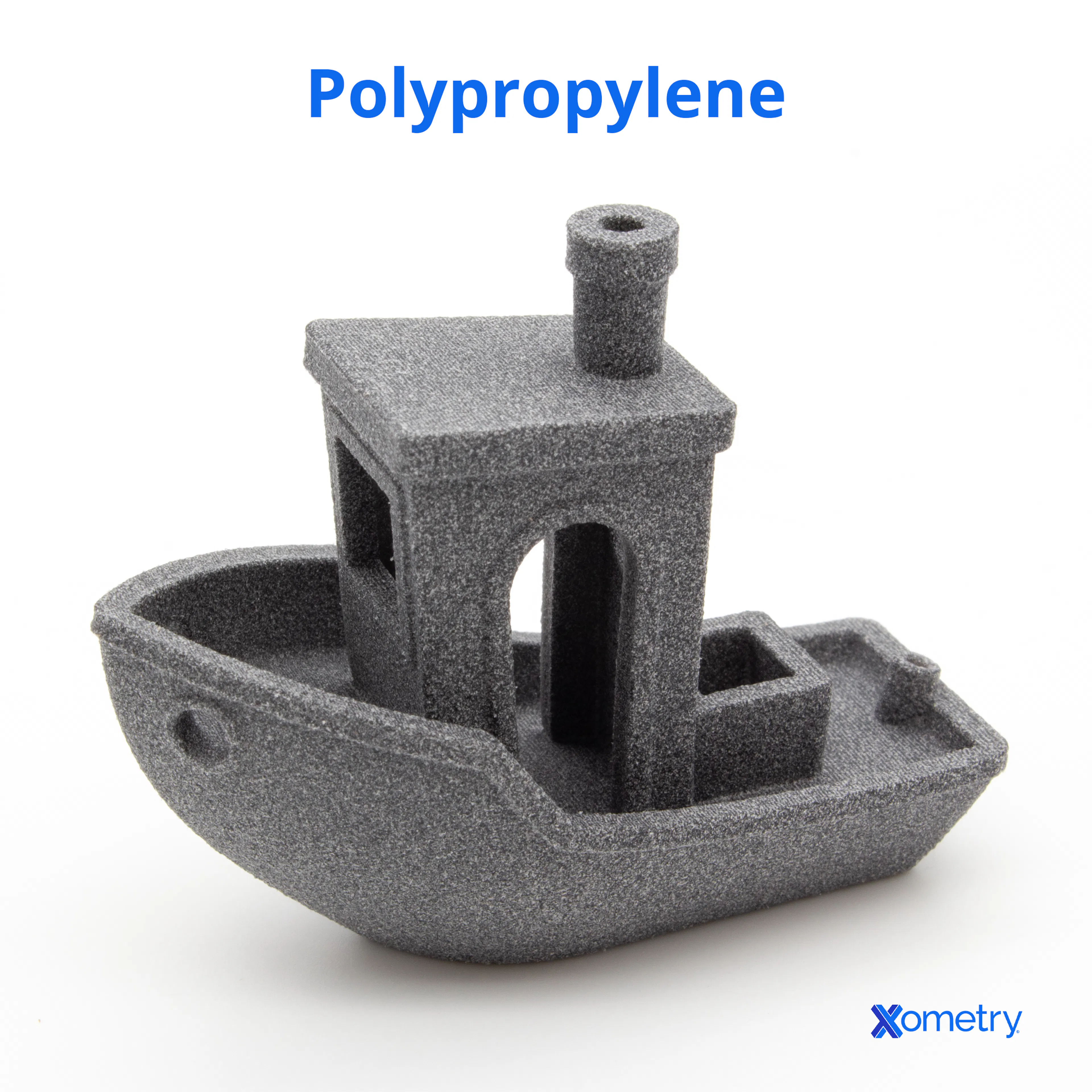

Polypropylene part made using Xometry's MJF 3D printing process
