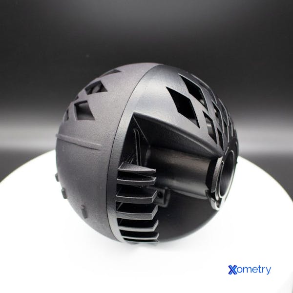

smooth 3D printed part
Smooth 3D printed part from Xometry
