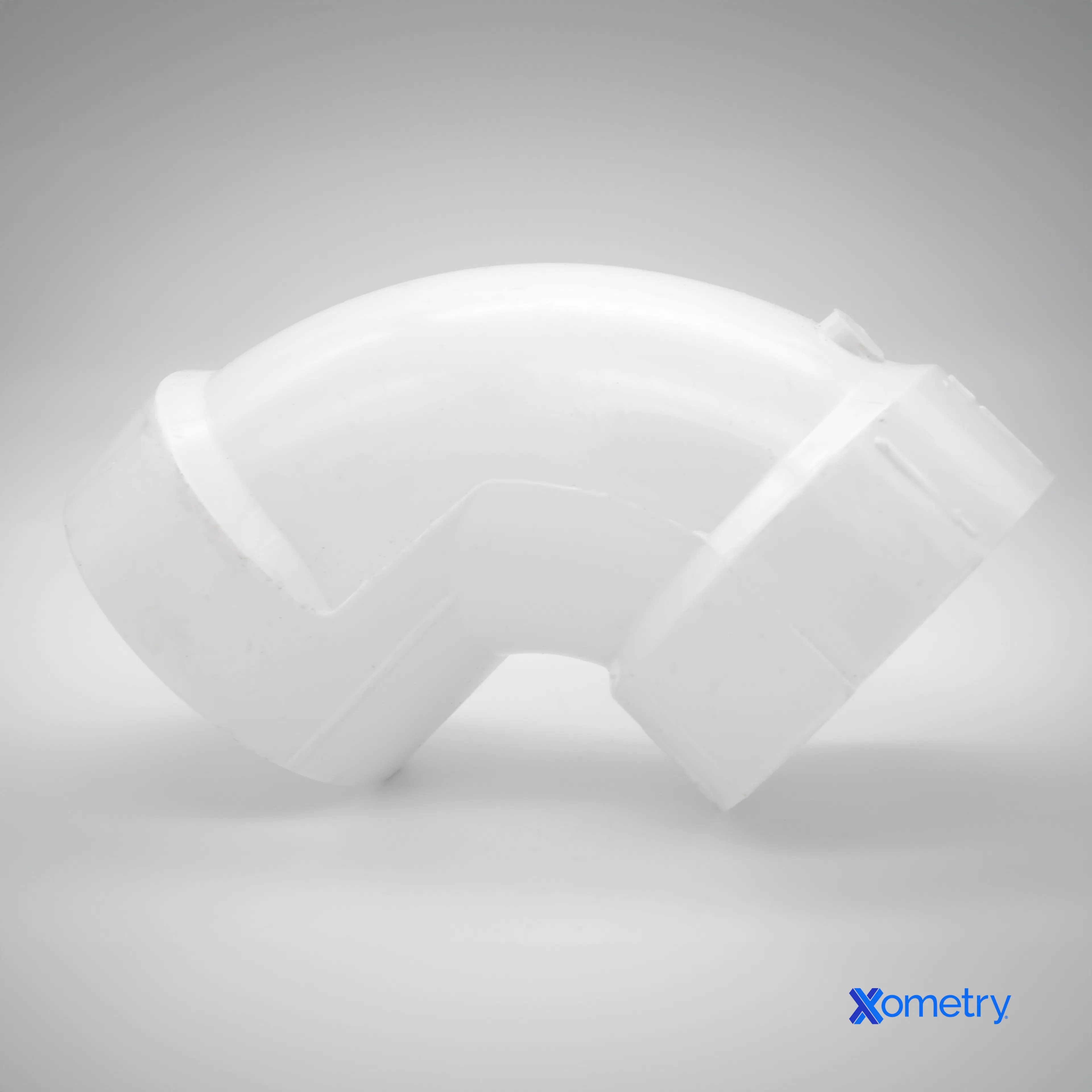

Thermoplastics are a group of plastics that are useful because they can be heated and softened or melted for forming, then hardened into a desired shape after cooling, without undergoing permanent chemical changes. This makes it possible for them to easily be recycled by simply reheating them and forming them into a new shape. At room temperature, thermoplastics are solid. At high temperatures, though, thermoplastics begin to soften and eventually completely melt at a temperature well above the glass transition temperature.
PVC pipe
PVC pipe
Materials like polypropylene (PP), polyethylene (PE), polycarbonate (PC), nylon, and polyoxymethylene (POM) are all examples of thermoplastic materials. The most common processes used to make parts composed of thermoplastics are injection molding, extrusion, and thermoforming. Thermoplastics are used in several industries for several applications, including: textiles, food containers, cookware, hand and power tools, pipes and electrical cables, machinery and construction components, medical devices, and many more.

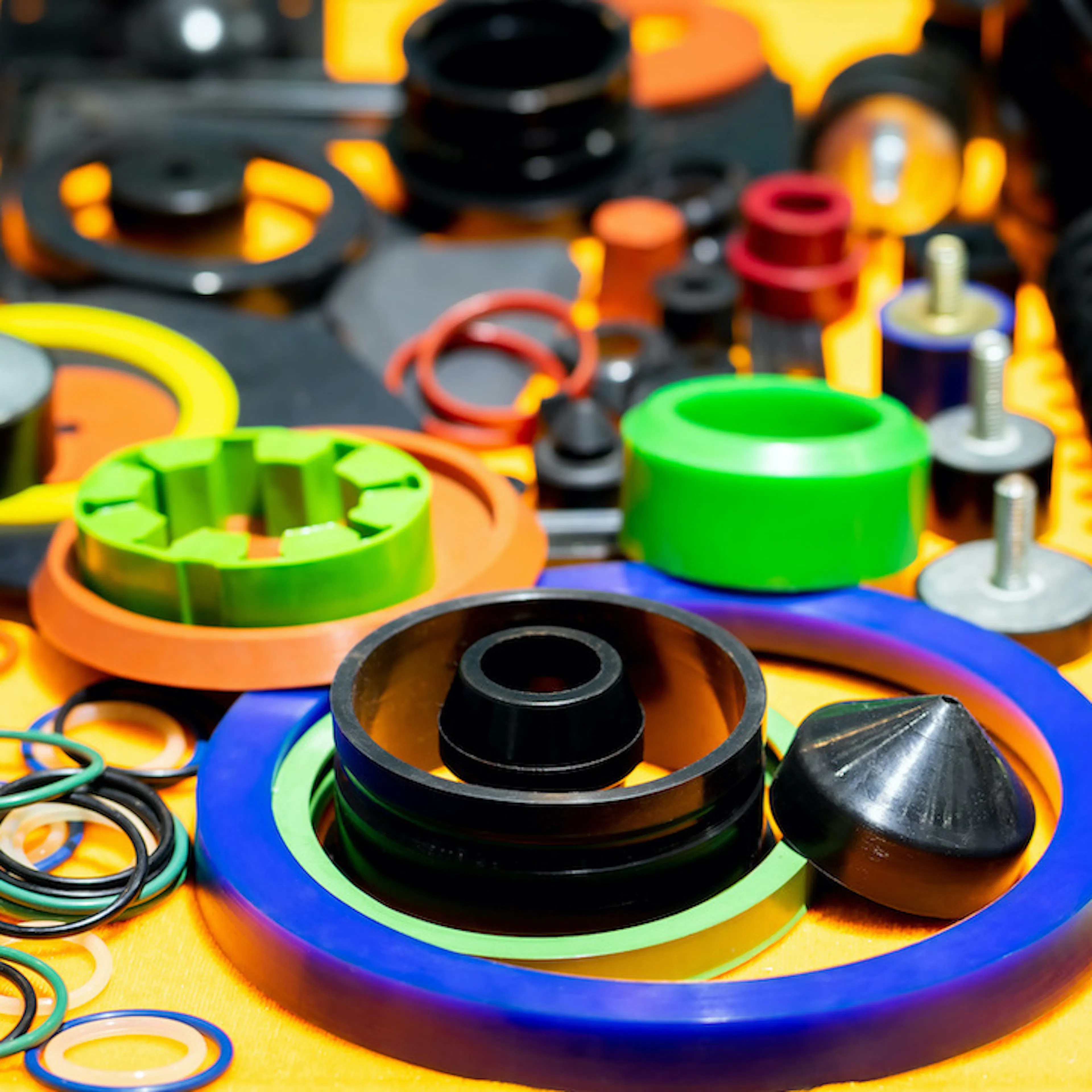

Thermosets are polymerized plastics composed of individual monomers that are liquid or soft solid at room temperature. When heated, or when certain chemicals (catalysts) are added, thermosets harden irreversibly. The applied heat (or chemical catalyst) causes the polymer chains in a thermoset plastic to cross-link with each other, holding the molecules more firmly in position. Crosslinking changes the properties of the material, making it impermeable and rigid. Once the crosslinking chemical changes take place, thermosetting polymers cannot be remelted or reprocessed.
Polyurethane part
Polyurethane part
Like thermoplastics, thermoset products are made using molds, but with slightly different processes, such as reaction injection molding or resin transfer molding. Due to the cross-linking process, thermosets are highly corrosion-resistant and resistant to creep. This makes thermosets ideal for applications that require high strength-to-weight ratios or excellent thermal and environmental stability, like air intake manifolds in automobiles or disc brake pistons in heavy machinery. Phenolic resin, silicone, polyurethane, and epoxy are some examples of thermoset materials.
