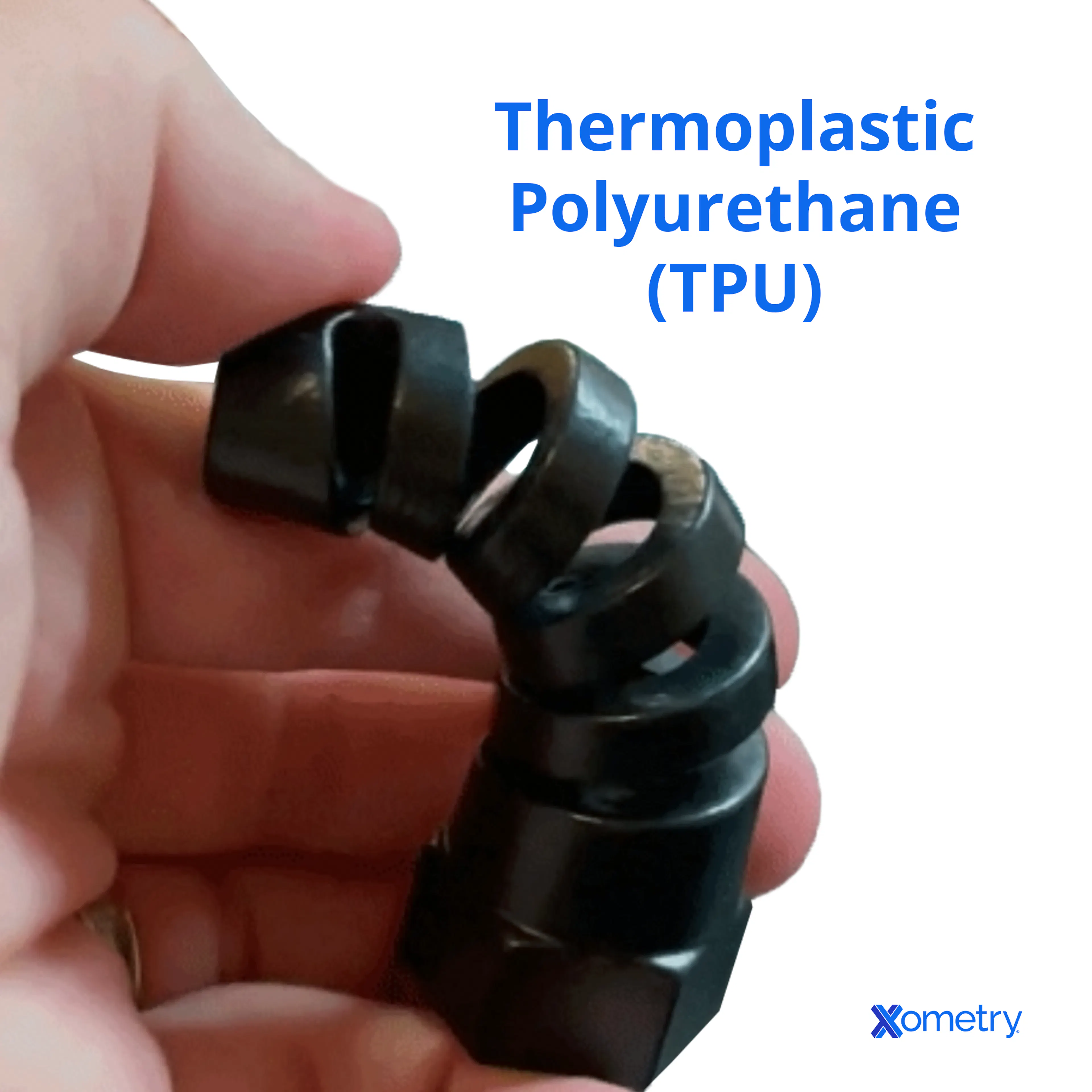

TPU bend
TPE (Thermoplastic Elastomer) is a rubber that has both thermoplastic and elastomer properties. TPU (Thermoplastic Polyurethane), on the other hand, is a form of TPE. TPU and TPE are flexible filaments used as 3D printing materials for designs that require stretch or bend qualities. They also give a “soft-to-the-touch” quality to printed products.

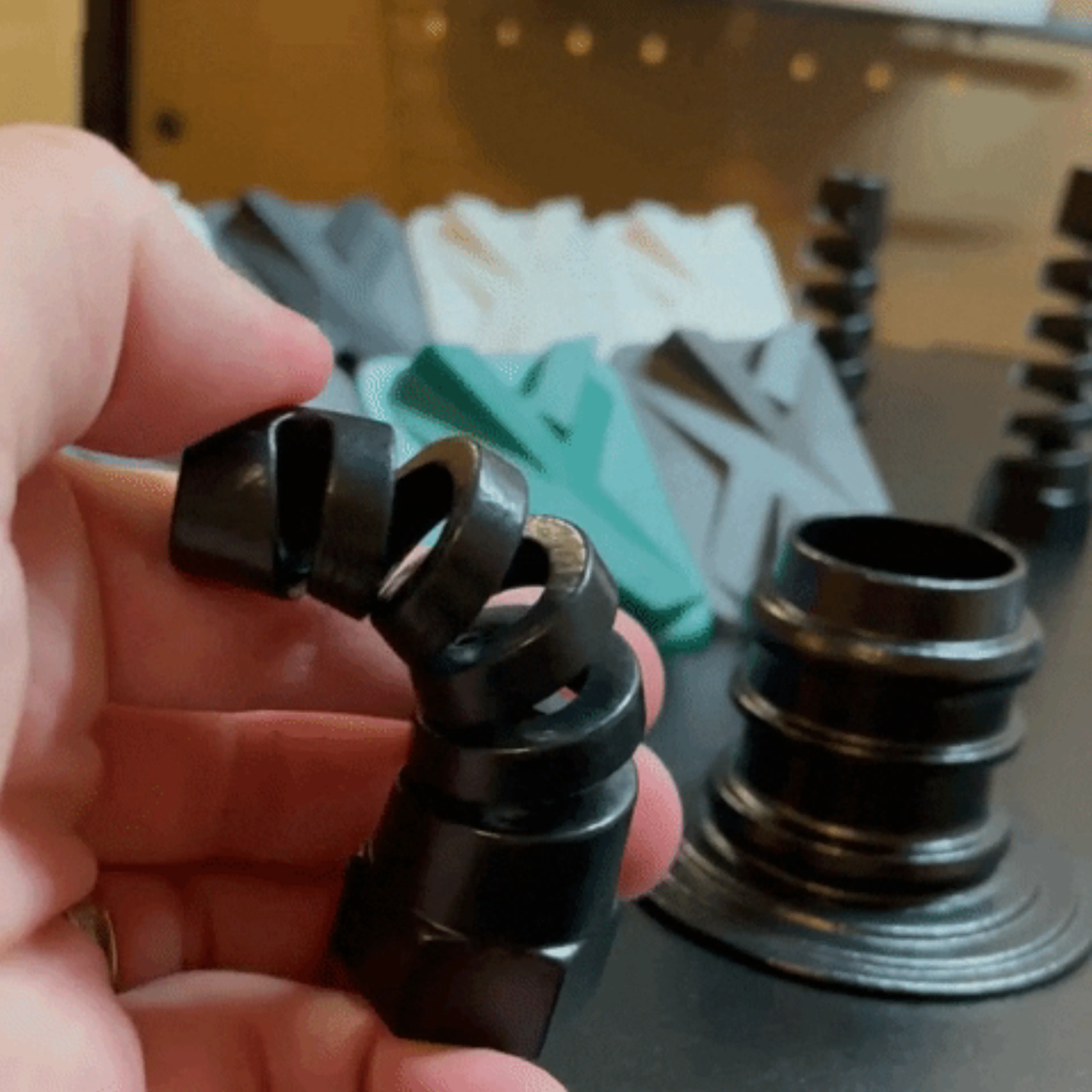

Strain relief made in TPU, printed and vapor-smoothed by Xometry.
