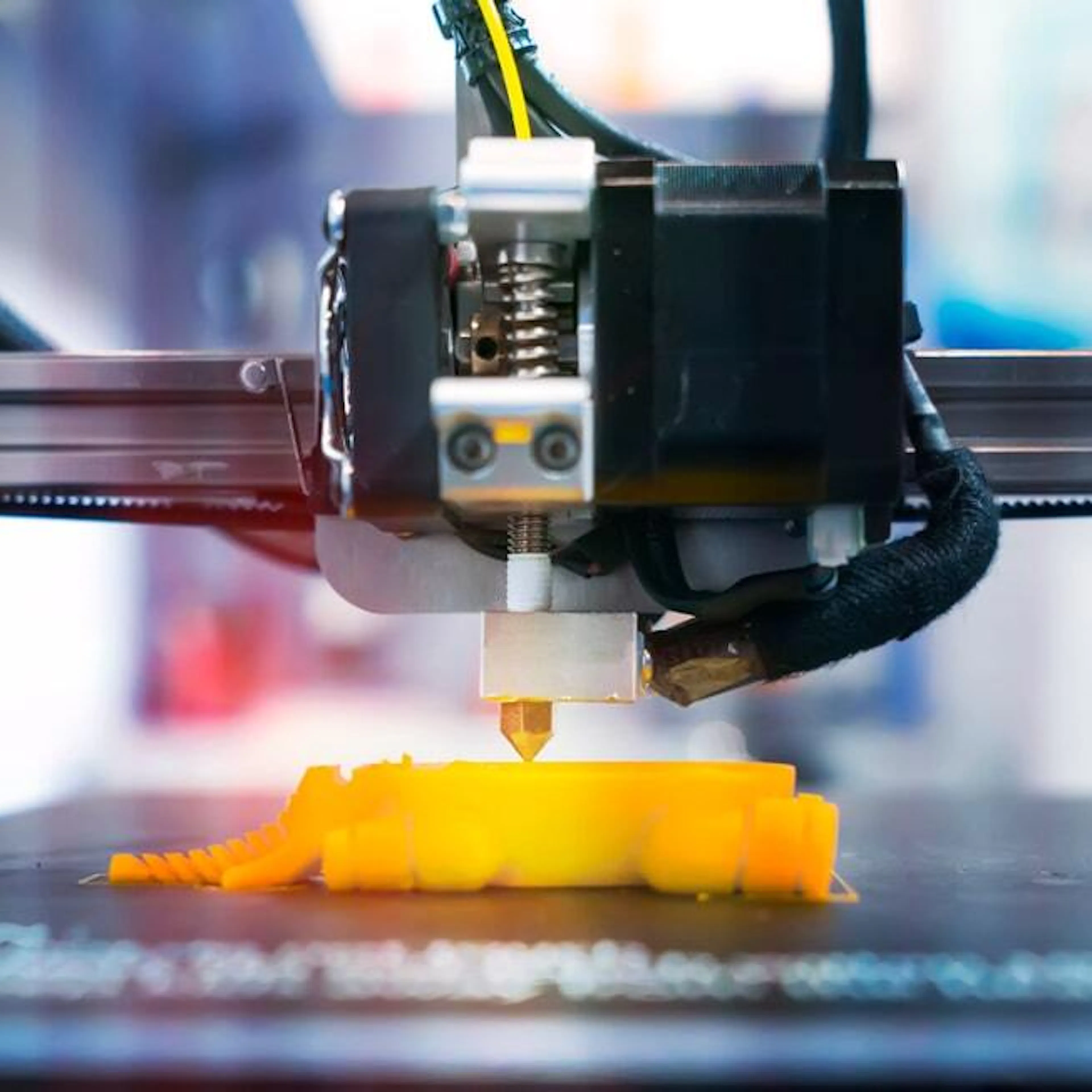

Object printed in 3D. Image Credit: Shutterstock.com/asharkyu
Slicer software is a foundational component in the Fused Deposition Modeling (FDM) 3D printing process, serving as the intermediary between a CAD model and the printer hardware. Without it, a 3D printer cannot interpret or fabricate a design. The slicer translates 3D geometry, typically exported as an STL, OBJ, or 3MF file, into precise, machine-readable instructions (G-code) that guide the printer through every movement, temperature change, and extrusion command.

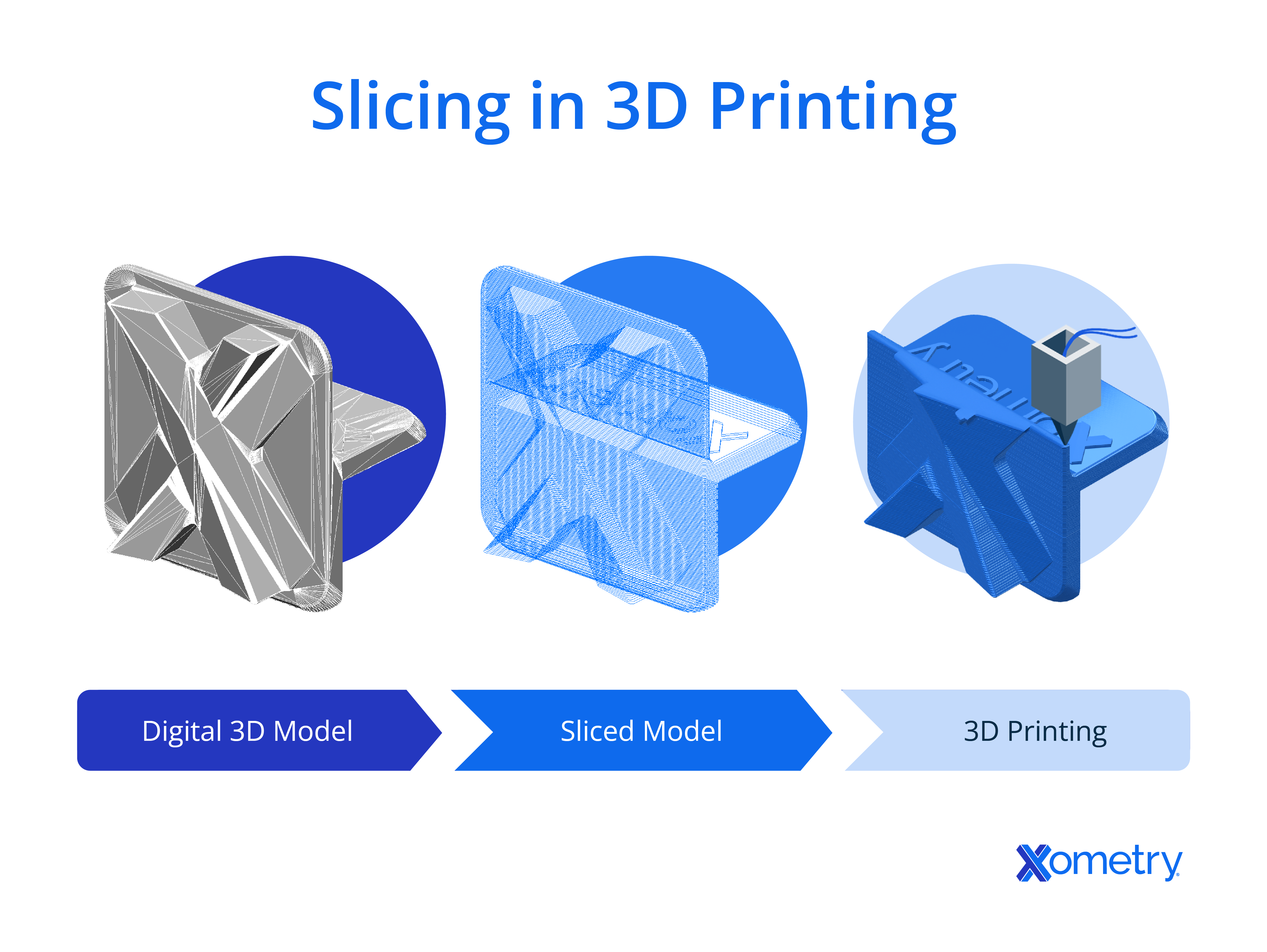

How Does a 3D Slicer Work?
3D slicer software functions by converting a 3D model into machine-readable instructions that a 3D printer can execute. This process involves multiple stages of data processing and optimization to ensure accurate and efficient printing. First, the user inputs key printer and material parameters into the slicer software, including layer height, nozzle diameter, print speed, material type, and extruder configuration. These settings ensure the slicing output is tailored to the specific printer and filament. Next, the digital 3D model is imported into the slicer. Depending on the CAD software used to design the model, supported file formats typically include .STL (most common), .OBJ, .3MF, and .AMF. Once the model is loaded, users can adjust orientation, position, and scale to fit the build volume or modify the model dimensions. This includes capabilities such as model rotation, mirroring, and rescaling, enabling flexible preparation of prints without changing the original CAD file. Finally, the slicer processes the geometry of the 3D model and divides it into a series of 2D layers based on the selected layer height. It then generates a G-code file, which contains detailed instructions for the printer, including movement paths, extrusion commands, temperature control, fan speeds, and retraction settings.
Slicer in 3D Printing
What Does Slicer Software Do in 3D Printing?
A slicer acts as a middleman between a 3D CAD model—which will be saved in one of the file formats, particularly STL—and the 3D printer. As the name suggests, a slicer slices the 3D model. It determines how each layer of the sliced model should be printed and the tool path the printer needs to follow to print a given layer correctly.
