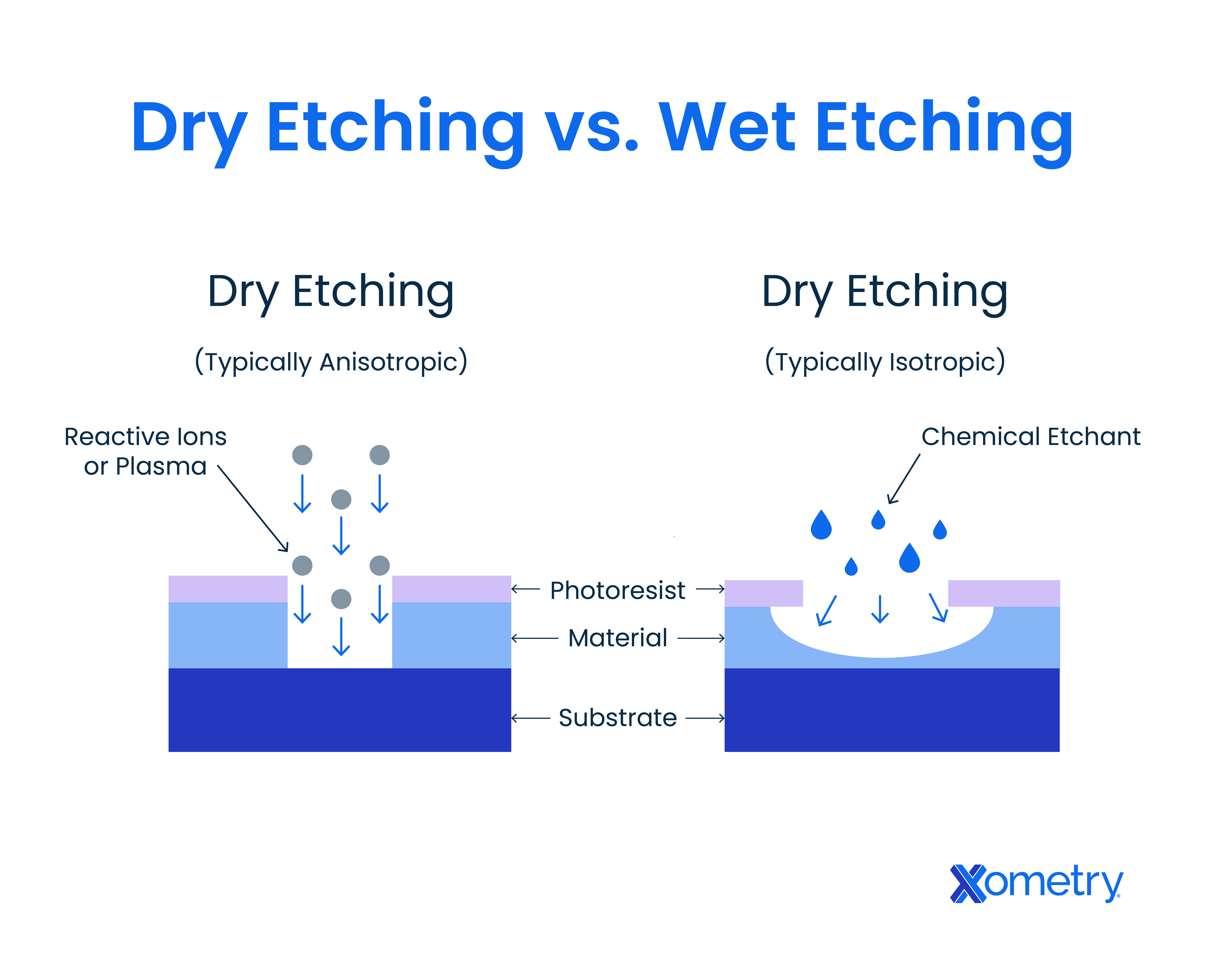

Dry Etching vs. Wet Etching
After understanding both processes, the key differences and applications between dry and wet etching can be compared.
Generally speaking, wet etching uses simpler equipment, is less complex, and typically achieves higher etch rates than dry etching. It's also more highly selective. However, wet etching also requires larger chemical volumes and poses greater handling and contamination risks compared to dry etching, and it offers less control over feature geometry. Dry etching, on the other hand, offers strong anisotropic control, higher precision, and generally safer operation within sealed vacuum systems. Depending on the process, dry etching can achieve moderate to high etch rates while consuming less reagent volume than wet processes. However, it is a more complex process, requiring more sophisticated equipment, and it offers lower selectivity.
Both techniques are widely used in:
  • Semiconductor fabrication
  • Micro-Electro-Mechanical Systems (MEMS) production
  • PCB fabrication (primarily wet etching)
  • Thin-film and metal micro-etching
  • Transistor gate patterning (primarily dry etching)
Both techniques use etchants, either in gas or liquid form, to remove material from part surfaces. Silicon processing is the most common use case. With anisotropy being critical in micro- and nano-scale semiconductor structures, dry etching offers many advantages over wet etching for precision pattern transfer.
