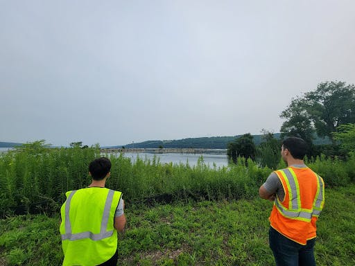

Recently, the marine engineering team was tasked with inspecting and surveying infrastructure systems along the Erie Canal.
“We have been inspecting and monitoring the sediment changes and infrastructure conditions throughout the canal. We perform detailed inspections of the locks in the Erie Canal; there's a lot of critical key infrastructure points on it that we are trying to get a clearer picture of,” Jedediah Tango, an ocean engineer on McLaren’s marine engineering team, explained.

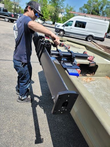

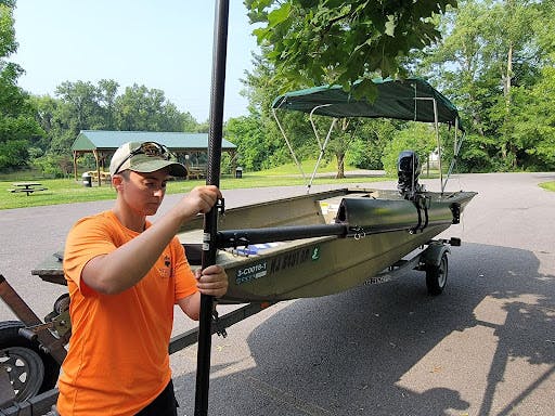

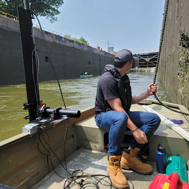

To inspect structures like locks, Tango and his team use sonar systems. “To begin, we attach the sonar system to a boat and deploy it underwater with long carbon fiber poles, with a GPS on one end and a sonar sensor on the other,” Taylor Zimmerman, a staff engineer at McLaren, said, describing how these systems work. “As the vessel moves, the sensor collects depth data by sending out sound pings underwater. The sound pings reflect off the mudline, which is then received by the system. The system calculates a depth value based on the time it takes between the sonar ping being emitted and received and the speed of sound in water. ”

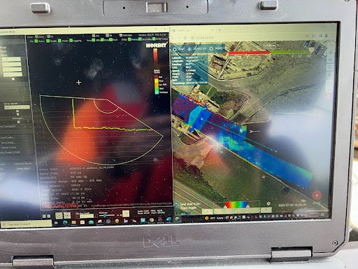

”The multi-beam sonar system emits and receives hundreds of pings per second in a wide swath,” Zimmerman continued. “This produces an incredible amount of data, which we use to create high-resolution underwater models of whatever area or structure we're mapping.”
The data produced by this multi-beam system allows the McLaren team to pull elevation data and visualize underwater infrastructure, helping them identify potential infrastructure rehabilitation needs and identify objects on the mudline that may impact the vessel's navigation.
To map New York’s canal system, the McLaren team would need to mount the multi-beam system onto a Jon boat. While the canal system is fairly deep in most areas, the team would need the small vessel to navigate through narrow, shallow areas in the canal more easily.
Unfortunately, Tango and his team made an unexpected discovery as they began to discuss the project: they realized the heavy-duty sonar mount hardware they usually used was not designed for such a tiny vessel. They would need to find a solution quickly, or their project would soon be dead in the water.

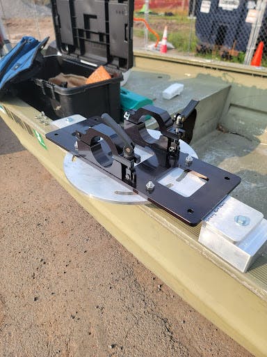

The multi-beam system originally came with CNC machined aluminum brackets and latches to a large base plate. This base plate was meant to be placed in the boat, with the smaller brackets placed underneath to attach it to the side of a vessel as it moves through a body of water.
These original parts didn’t work as intended, though.
“We couldn't figure out how to bolt this plate to the side of the boat because the top part of the boat wall was an inch and a half thick, and the plate was four inches,” Tango said. “We had to narrow it down while making sure it wouldn’t jiggle free from the stresses of the boat maneuvering through the canal.”
The multi-beam system continuously emits hundreds of signals and must remain perfectly still and level to measure water depth accurately. To gather this data, Tango knew that he would need to use CNC machining to create his own metal brackets to keep the multi-beam system securely attached to the boat.

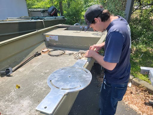

Tango and his team ordered four CNC-machined brackets to work with the original ones provided to them for the multi-beam sonar system that would attach to the Jon boat. The main bracket was a 10mm thick aluminum plate.
“The plate had a straight linear line through it with three bolt holes. We also added circular mounting so the bracket could go in and it could be bolted on the side of the boat, which compensated for the curved bow of the boat. These tracks were in the dead center of the boat, which aligned with the multi-beam sensors,” said Tango, explaining what made the main bracket unique.

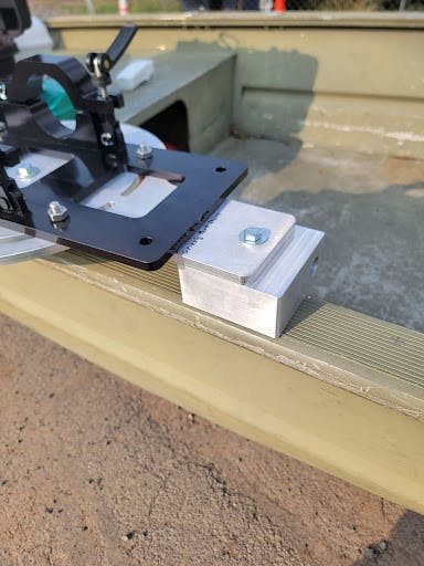

After Tango and his team received the plate, they began bolting it to the boat, along with the other three CNC-machined aluminum blocks they ordered.
“These spacer blocks helped give clearance for the bolts so that we could set the system up on both sides of the boat,” said Tango. McLaren’s marine engineering team designed these spacer blocks with a three-degree angle at the top of them, which allowed the system to remain perfectly level with the water's surface. The equipment needed to stay level with the water to ensure accurate measurements.
Tango was pleased to see that these precise metal parts fit onto the boat and how Xometry could help him quickly find a solution.
